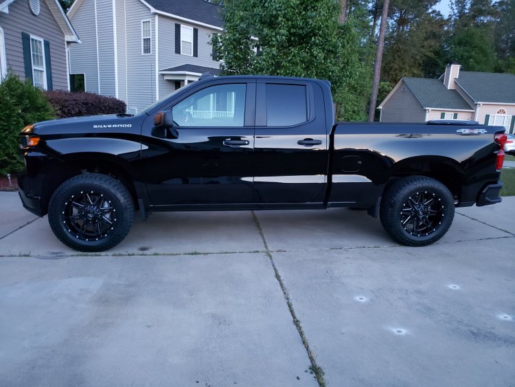

Question, I have a 2019 Silverado with a 2" leveling kit installed. The question is can I put 20x10 rim's with 35x12.50x20 tires on the truck without anymore modifications? I appreciate the help.

No,
The only way to run 35s with aftermarket rims is to have a Trailboss with a level and even then it might still rub depending on your offset.  If you have stock offset rims, you can possibly run them on a leveled standard silverado.  At your current height, your front is even with a Trailboss and you can run 33x12.5s but they will slightly rub depending on offset

0mm...20x9 rim...you can also do the mudflap mod if it does end up rubbing like mine did.  I'm running 305/55R20 which is 33.5x12.5R20 and it rubbed slightly until I did that mod
I just put 20x9.5 neg 6 offset with 295/60r20 procomp at2 with 2 in rc level and they rub at almost full lock out. Also had to run .25 inch spacer in front to clear caliper.
