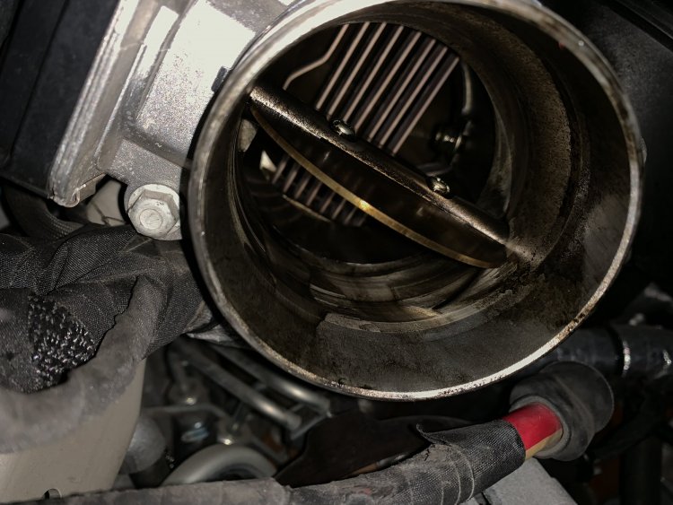

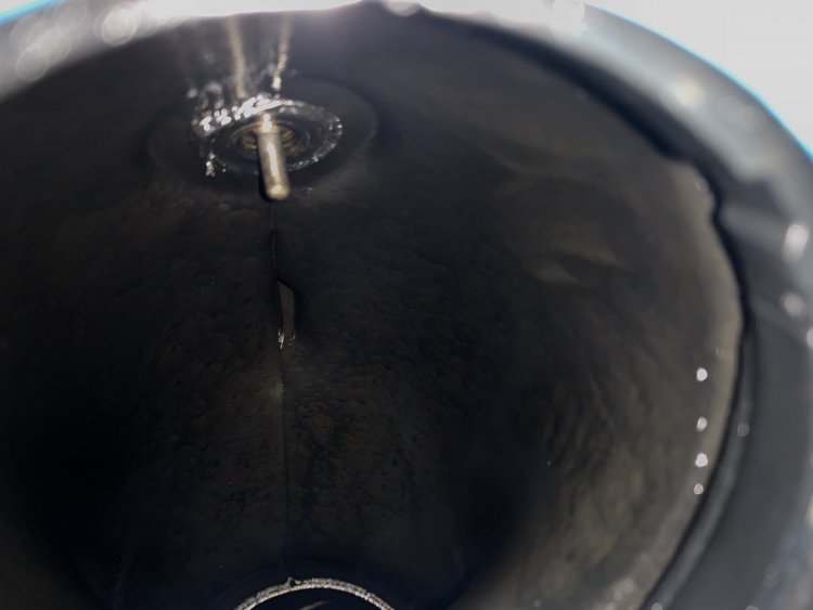

Oil in intake after turbo on 2015 lml
Anyone else Seen this on the intake after turbo and intercooler??
Strangely normal.  You could try a catch can if its installed correctly.  PCV is to blame, and GM for the L5P added in a new air/oil separation for the system to reduce/prevent this.
