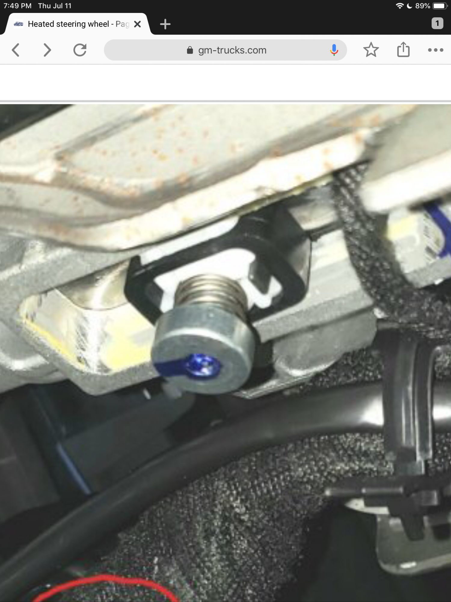

i went to the store parked the truck hear my steering wheel make a weird noise but didn’t think nothing of it, sounded like metal hitting like the wheel didn’t lock then it locked, ok well when I got back n the truck this piece fell from the steering wheel area or steering column area anybody know what it is? Has a screw and a spring and grease af with a rubber gasket around it. Is it something important?
Damn so u think it’s needed any info on how to put it back? Might have to google this when I’m at work appreciate the the comment
Yours looks broken to me though.  the side looks like it snapped.  Most likely why it fell out.
Now I want to know what the heck does it do ha ha..
Actually the black piece is like a rubber gasket that just cover the hard white plastic, it was full of grease I have no idea what it’s for I see a spring n it so I know it’s there for a reason just don’t know what reason ?

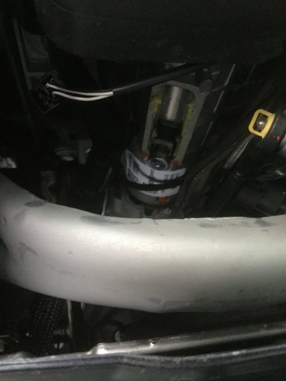

Did some digging around for you Frankielonazo214 it’s for your telescope steering if you pull down it unlocks your sliding piece it’s slides up and down when u lock it and unlock it hope this helps you out more
Damn I’m gonna have to check this out for sure Sunday, they have me working doubles today and tomorrow that’s crazy I check that and it was working fine now I’m gonna have to check it out when I get back to my truck. Man I probably would of never figured that out thanks.
