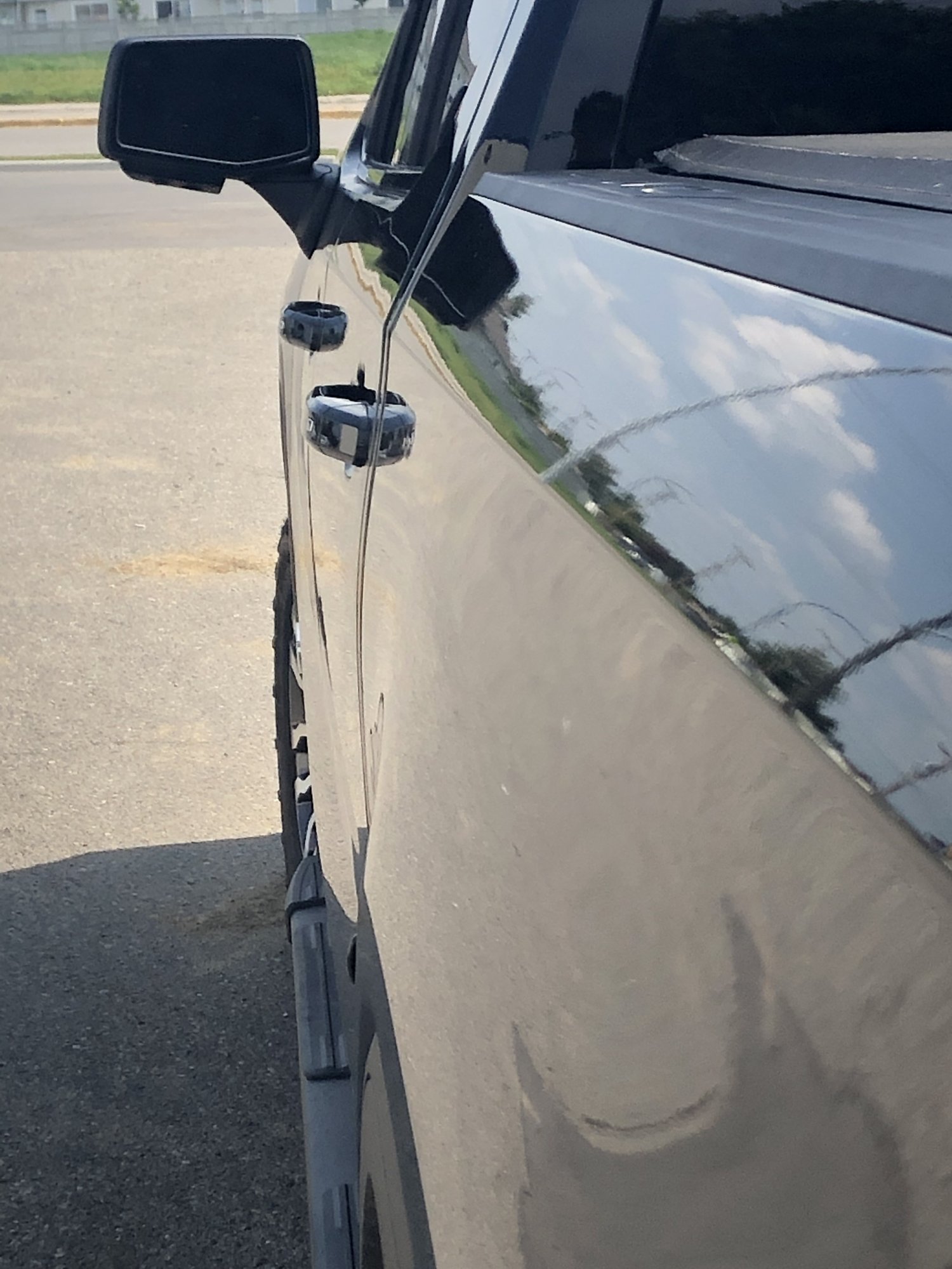

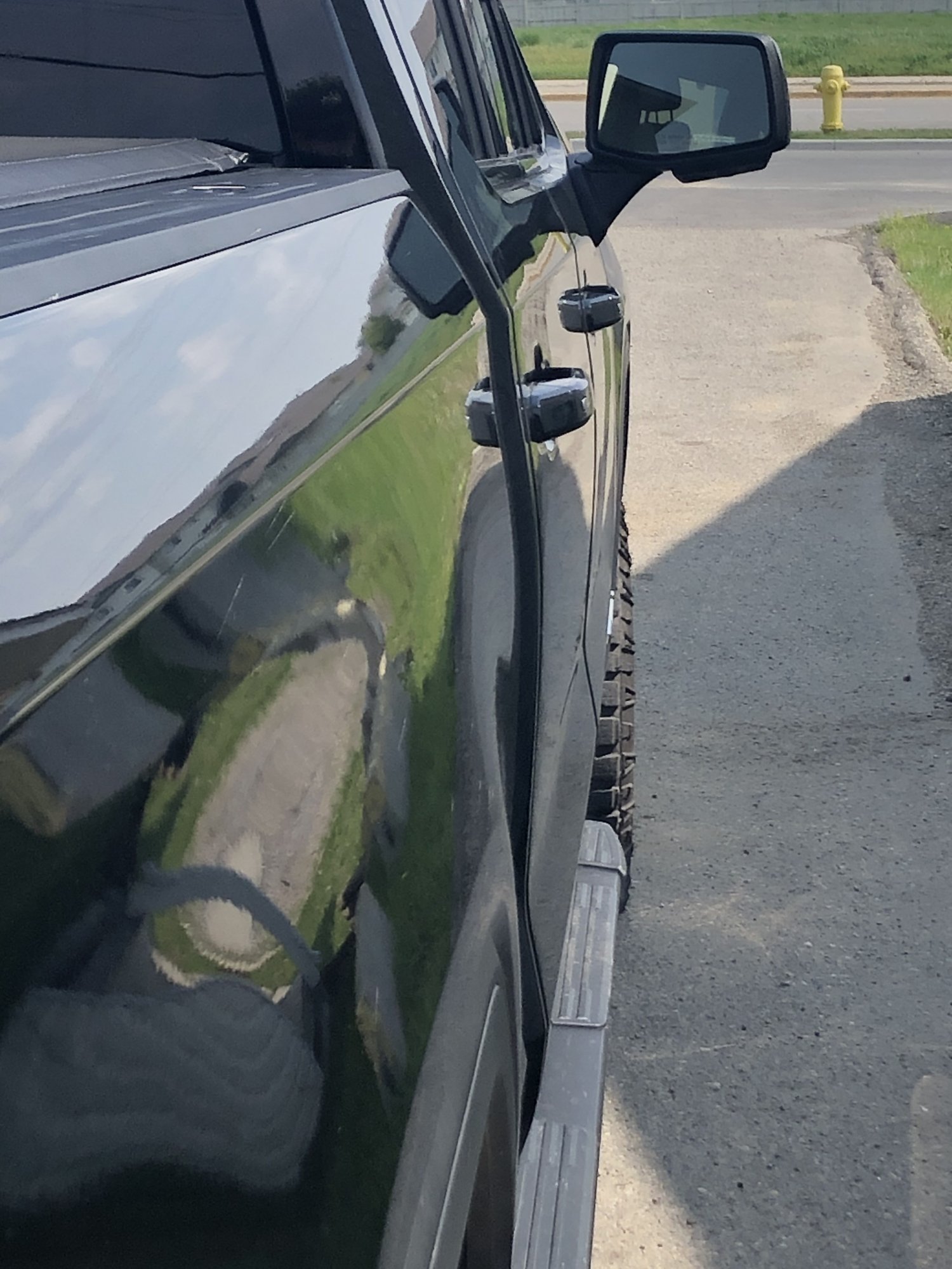

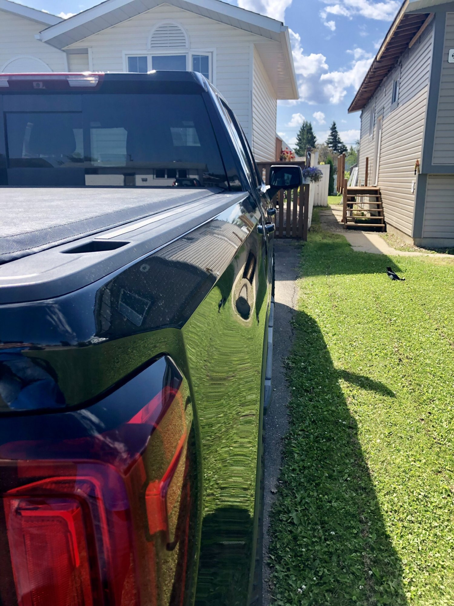

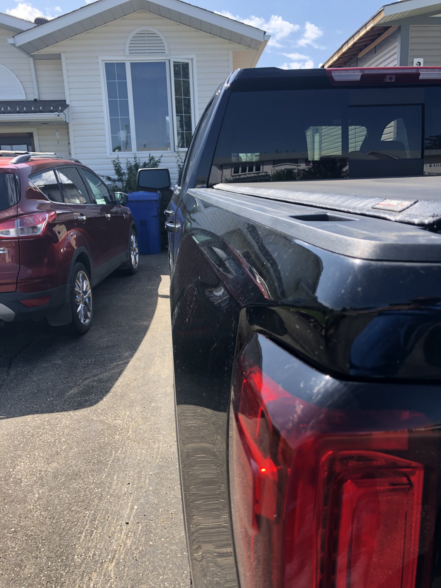

Anybody else’s box not even with cab?
There's a thread on this topic already. Not sure exactly where it is at the moment but I'm sure someone will chime in with the link.
Take it to the dealer. They can loosen up the bed mounting bolts, slide the bed so it's aligned properly, and then tighten the bolts back down. Painless and usually pretty quick fix. Common issue with all pickup trucks built on an assembly line running as fast as possible.
On 7/16/2019 at 4:43 PM, Greenmachine777 said:
Just noticed my AT4’s box is flush with cab drivers side and 1/2” or so off on passenger side?
Just curious if ya ever took her to the dealer to be straightened up?
Finally got in to get box aligned, it’s at the end of adjustment and they said not quite perfect but pretty damn close now. Looked at 3 trail bosses while I was there and they were all off as well.
