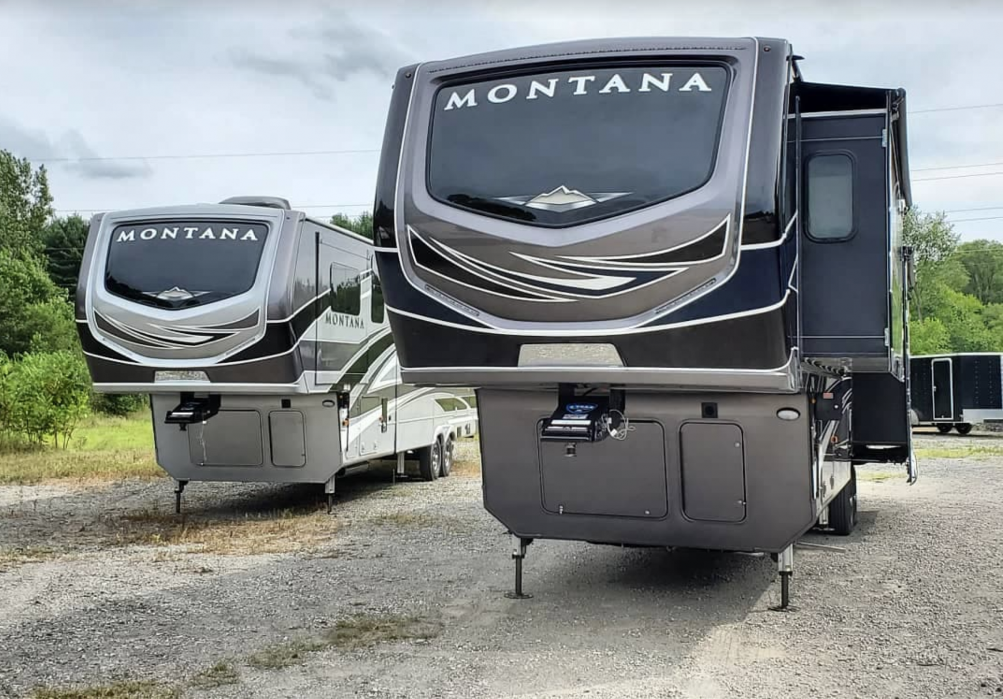

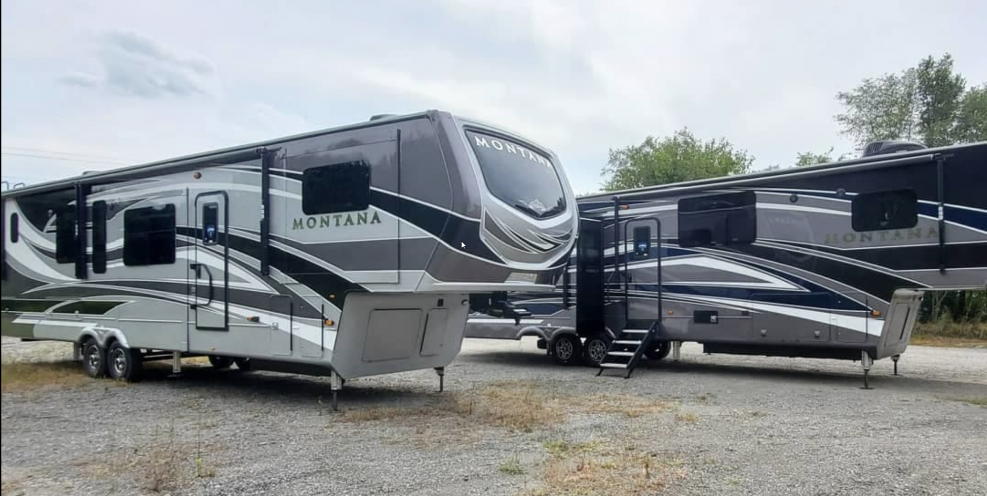

 A couple of pictures of the new trailer attached (the one on the right). The dealer has the two Denali Ultimate one ton SRW's on the lot - a white frost tri-coat and a carbon black metallic. The white frost has the walnut and grey interior - not to shabby. What says this group?

I don't know what the trailer weighs, or what it will weigh loaded. (is there a 3rd axle installed at the location that has an arch but no wheel?)
That's just the wheel well of the extended slide-out. Not an extra axle location.
Ahh yes.
I see that now.  Thanks for helping out a non-rv'er.
