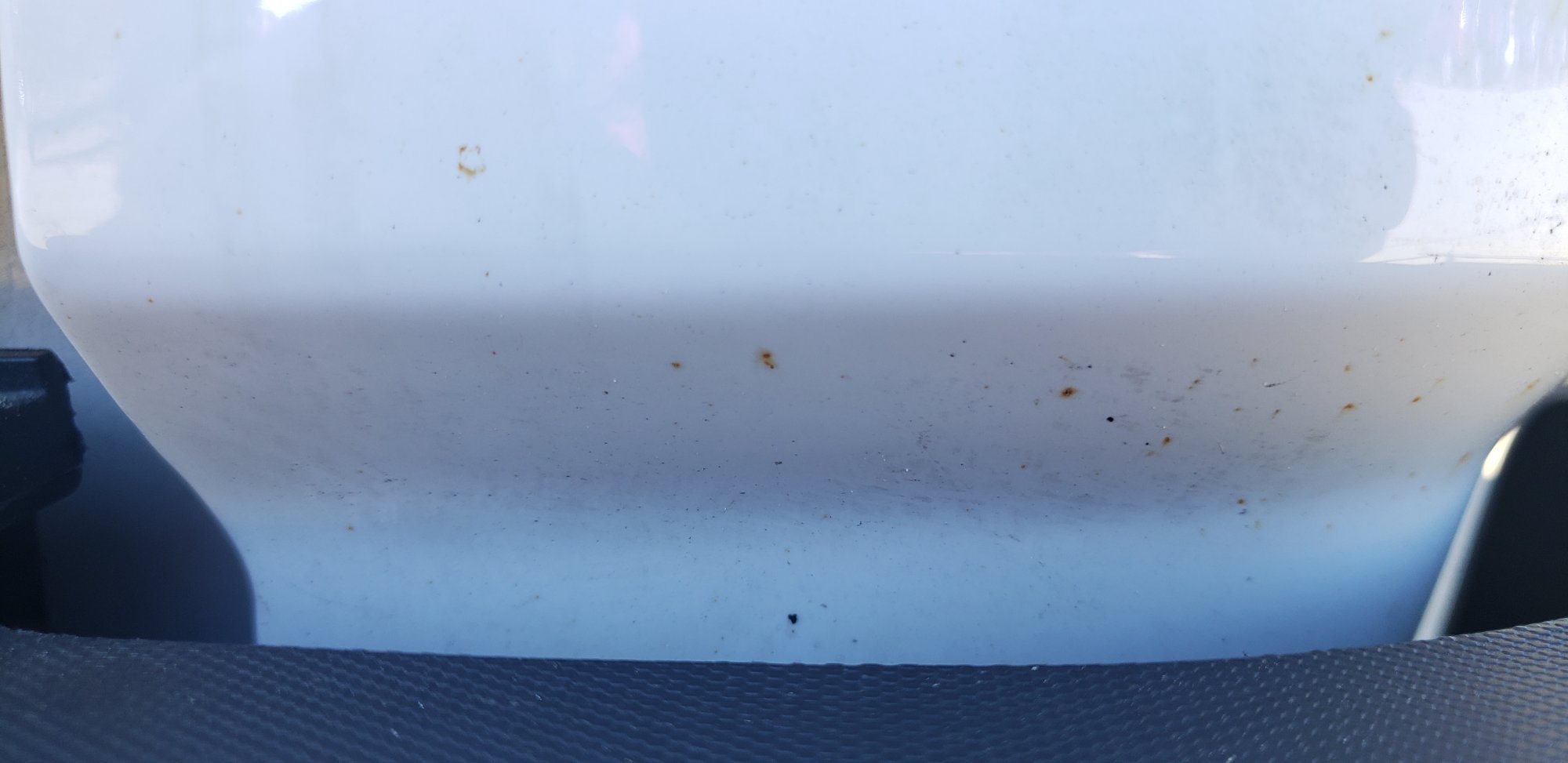

I have a 2018 Silverado 2500 HD, with just over 20K miles and what appears to be surface rust all over the body.... yes I know rust needs metal to rust, but I have had 3 people look at and we are all stunned at how much it looks like rust pits
It does clean up with some serious elbow grease just wondering if this is an issue?
heading to the dealer next
It’s rail dust (small metallic particle get on your paint and rust). A good clay bar treatment followed by a polish then coating will eliminate and keepnfrom coming back for awhile
It’s not a dealer/mfr issue. You need to take care of your vehicles paint.

Thanks Ryan I did have one friend say the same thing, so I guess not a dealer issue... Detailer here I come

Even a good coating will develop those. I would get them on my 2010 sheet silver paint usually every 2 years or so after winter
