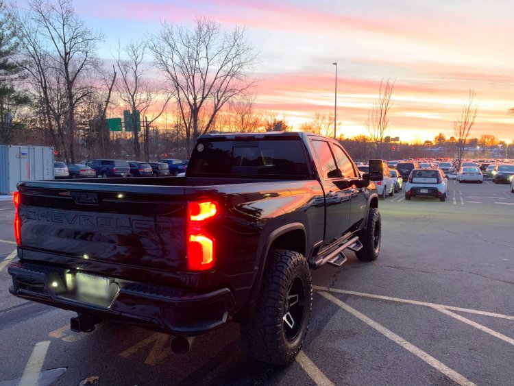

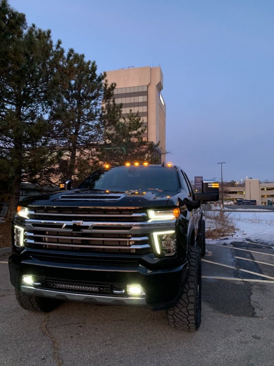

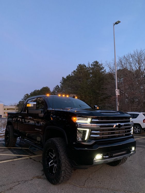

I have vision 20x10 -25 with Nittos 37”.13.50 and had to remove front fender mud flaps, do some modifications to the bracket that holds the mud flap and fendEr liner and trim the plastic under the bumper.
I have been looking at rought country 3” lift kit. I might end up doing sometime this summer
39 minutes ago, TrailDemon said:
Site is not letting me download all at once. I apologize for all the post
That is Beautiful. Really nice truck
