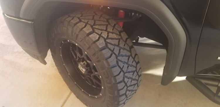

Roadrunner45 Posted December 24, 2019 Posted December 24, 2019 I swapped out the factory Michelin tires for a set of Nitto Ridge Grapplers 295/70R/18 on the stock rims. The suspension is stock no rubbing thanks for all those who contributed and made the decision easier. Gained a bit of safety margin in the tires went from 3640 to 4080# . Feeling better backing the RV into a wet area with the ridge grapplers for sure.

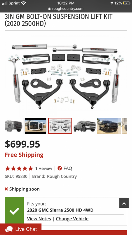

Big Skin Posted December 25, 2019 Posted December 25, 2019 On 12/25/2019 at 6:09 PM, James89436 said: Any pics Big Skin? Been considering 22s but want to see a few before pulling the trigger Sorry it was a Silverado 2500. I will be putting 22’s on mine however I don’t like how a little tire there is with 35’s but don’t think I can fit 37’s tires with a leveling kit so I may need to do a 4” lift. 2020 gmc 2500 wheel info: The bore hole Is 124mm The bolt pattern is 8x180 Rough Country 3” leveling kit sku#95830 has upper control arms and shocks After you can fit 22x10 8x180 with 124 bore you have to trim the inside of the rear wheel well extension and the edge of the front wheel well near the engine heater plug

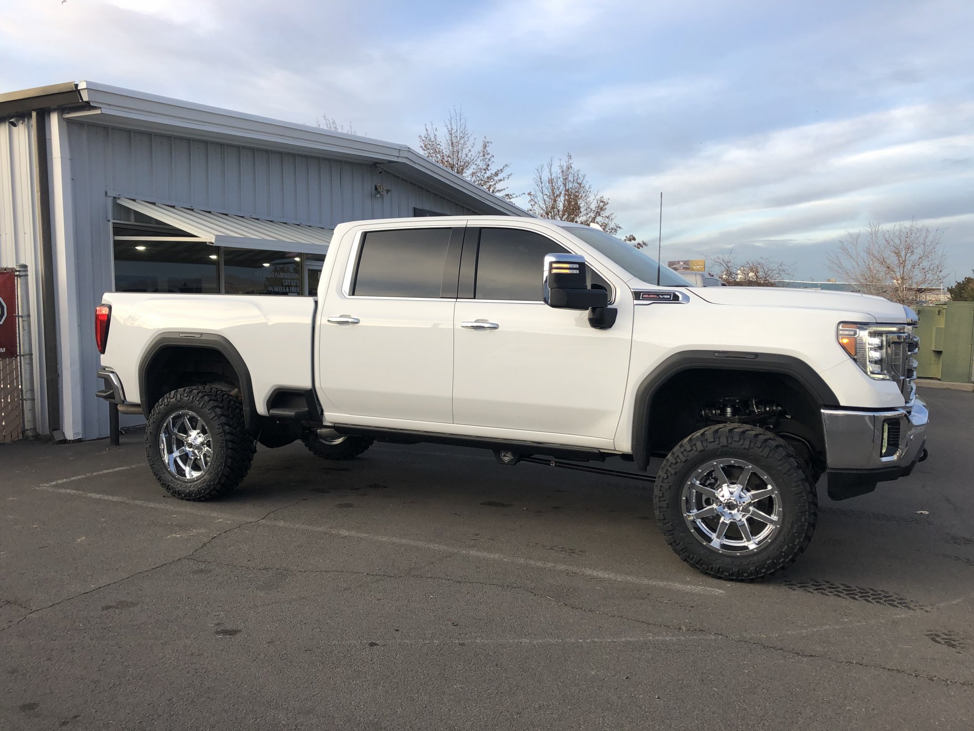

James89436 Posted December 26, 2019 Posted December 26, 2019 Here is my buddy’s truck he just got lifted with a zone lift and 35s. Because of the offset he had to trim the corner of the bottom front bumper slightly.

Big Skin Posted December 27, 2019 Posted December 27, 2019 51 minutes ago, inquenciocha said: I already purchased 2 1/4 keys from Readylift but was told to wait until upper A-arms come out. Rough Country 3” leveling kit sku#95830 has upper control arms and shocks After you can fit 22x10 8x180 with 124 bore you have to trim the inside of the rear wheel well extension and the edge of the front wheel well near the engine heater plug
inquenciocha Posted January 5, 2020 Posted January 5, 2020 On 12/25/2019 at 6:38 PM, James89436 said: Here is my buddy’s truck he just got lifted with a zone lift and 35s. Because of the offset he had to trim the corner of the bottom front bumper slightly. Looks awesome but can he still get under a 5th wheel/gooseneck?
