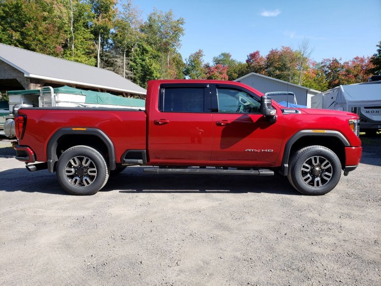

I mounted and balanced 295/65-20's tonight, measures the same as 35/11.5-20.
Stock wheels, stock suspension zero issues
Michelin Defenders

Let's see some pictures....

Looks good.  Now that you've got some time with the 295s, any issues? If I were to go more aggresive tread, will they rub?  Thanks

Zero rubbing, there is a bit more room
