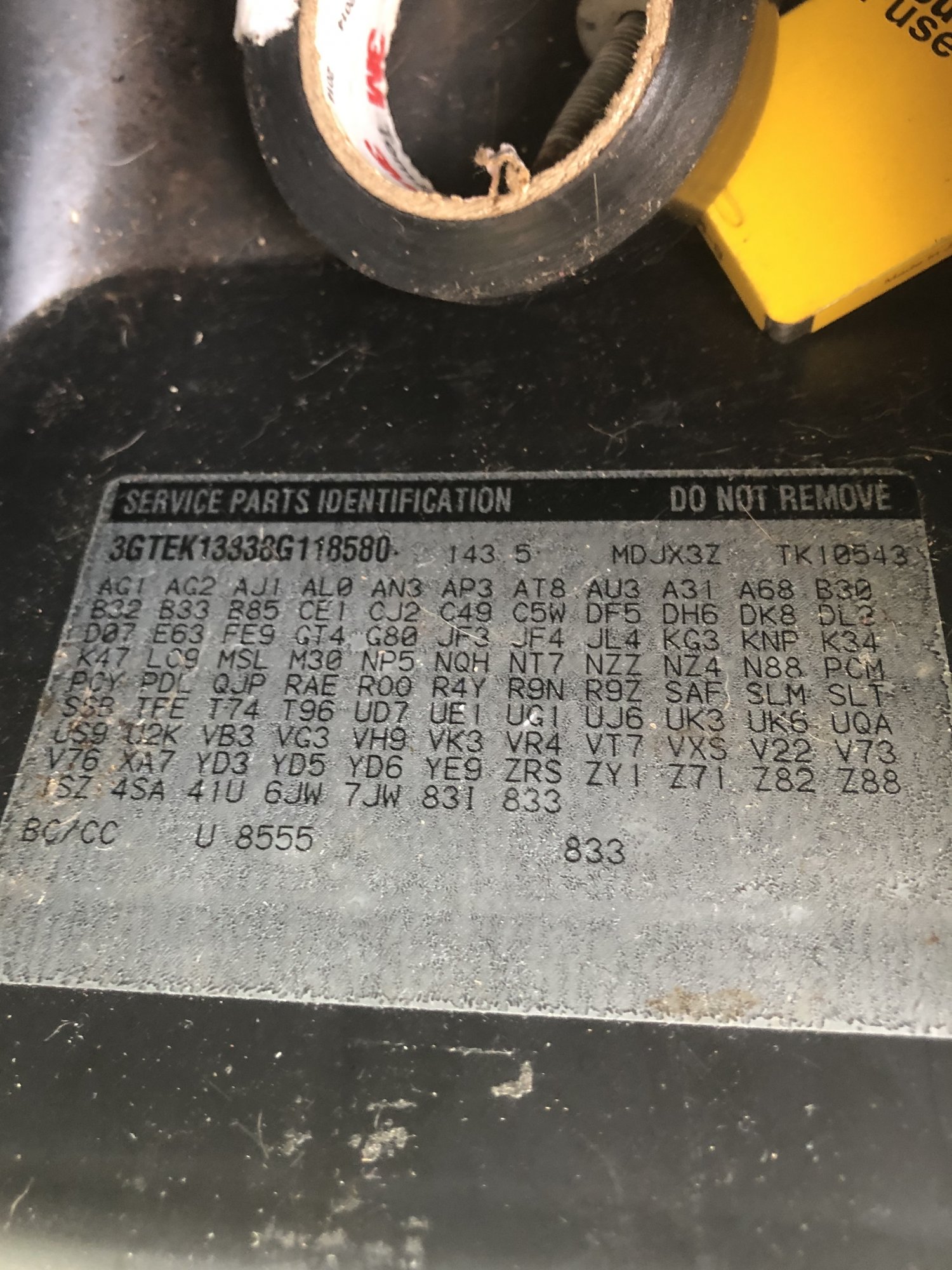

She should tow fine, you just have to slow down.  GT4 means she has 3.73 gears.

I say run what you brung.  You have the heavy duty cooling package (KNP) and 3.73 gears (GT4).  Sure the transmission has a lot of miles on it - any mods to improve engine output will just accelerate failure.  If the transmission blows up, it blows up.  No point in throwing money into it now.
With the trailer, you're at about 5000 lbs.  Assuming you'll go flatbed, not enclosed, the truck should tow that pretty well.   See how it does, how the temps run, and then assess and plan your mods.
