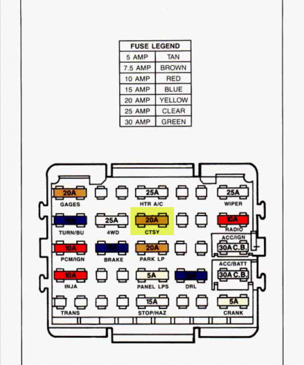

Where is location of the cigarette lighter fuse on a 1989 chevy silverado?
The fuse panel is under the dash beside the parking brake pedal. I believe the fuse manked CTSY is the one for the cigar lighter. I think the dome light and horn are possibly on the same fuse with the lighter.
