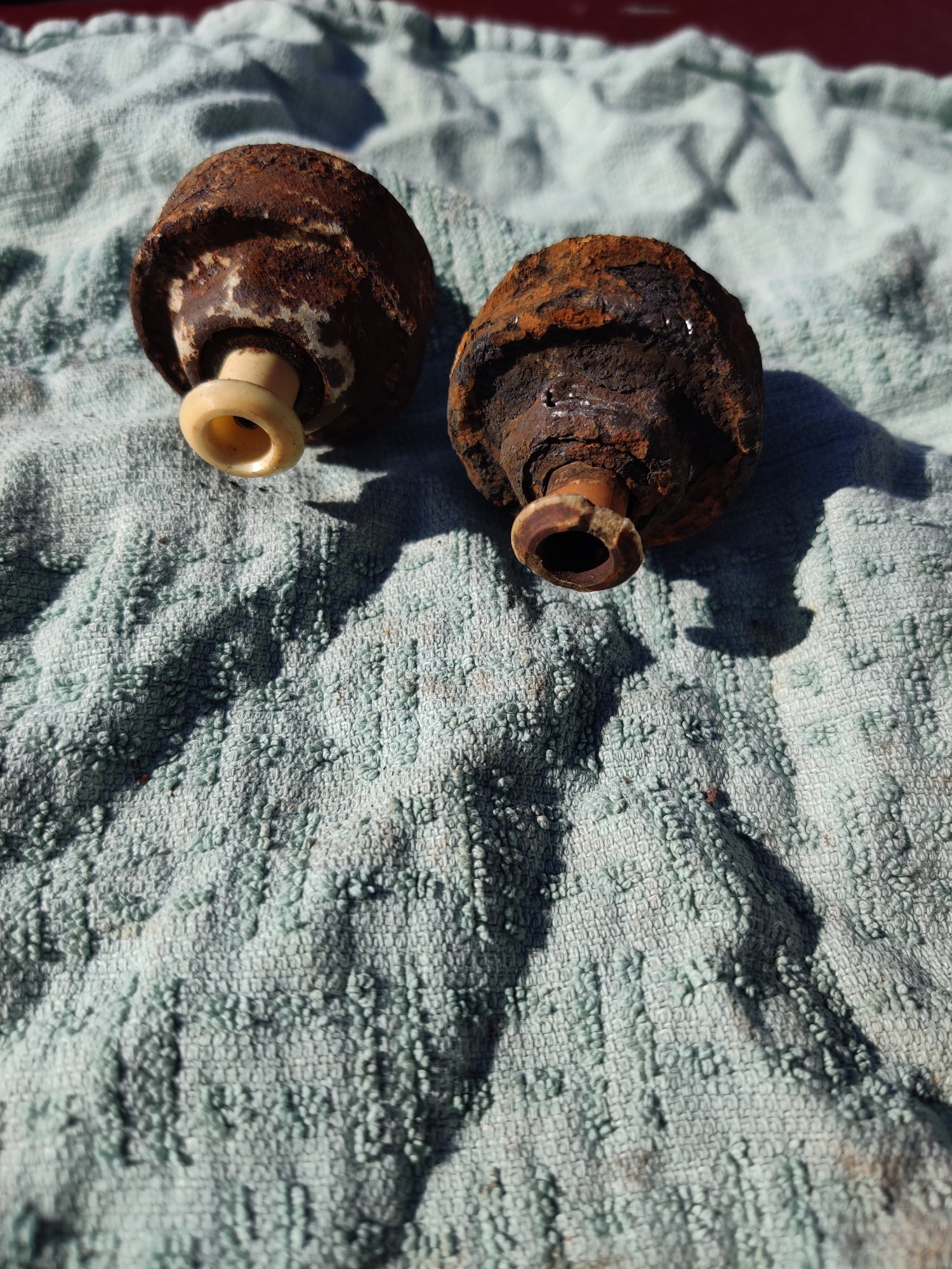

Knock sensors replaced, what a difference! Power is better than ever and runs great again. Still throwing codes for the upstream o2 sensors but I'll be swapping them out tomorrow. I'm not sure the knock sensors have ever been replaced considering the condition they were in. IMG_20191106_101551.thumb.jpg.32238594d3c39a98594a7703f81af17b.jpg
Hope you did the "rtv dam" trick to reduce the amount of water getting on them, replaced the harness at the same time, and put in new intake manifold gaskets...
New harness, all new gaskets ( valley cover and intake manifold, egr pipe) and sealed the donuts that cover the sensor holes with plenty of rtv.
