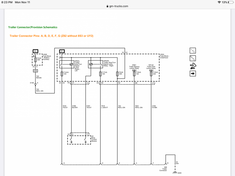

Yes. Do you have an aux battery in your truck? X50A is the big black fuse block on the driver side.
