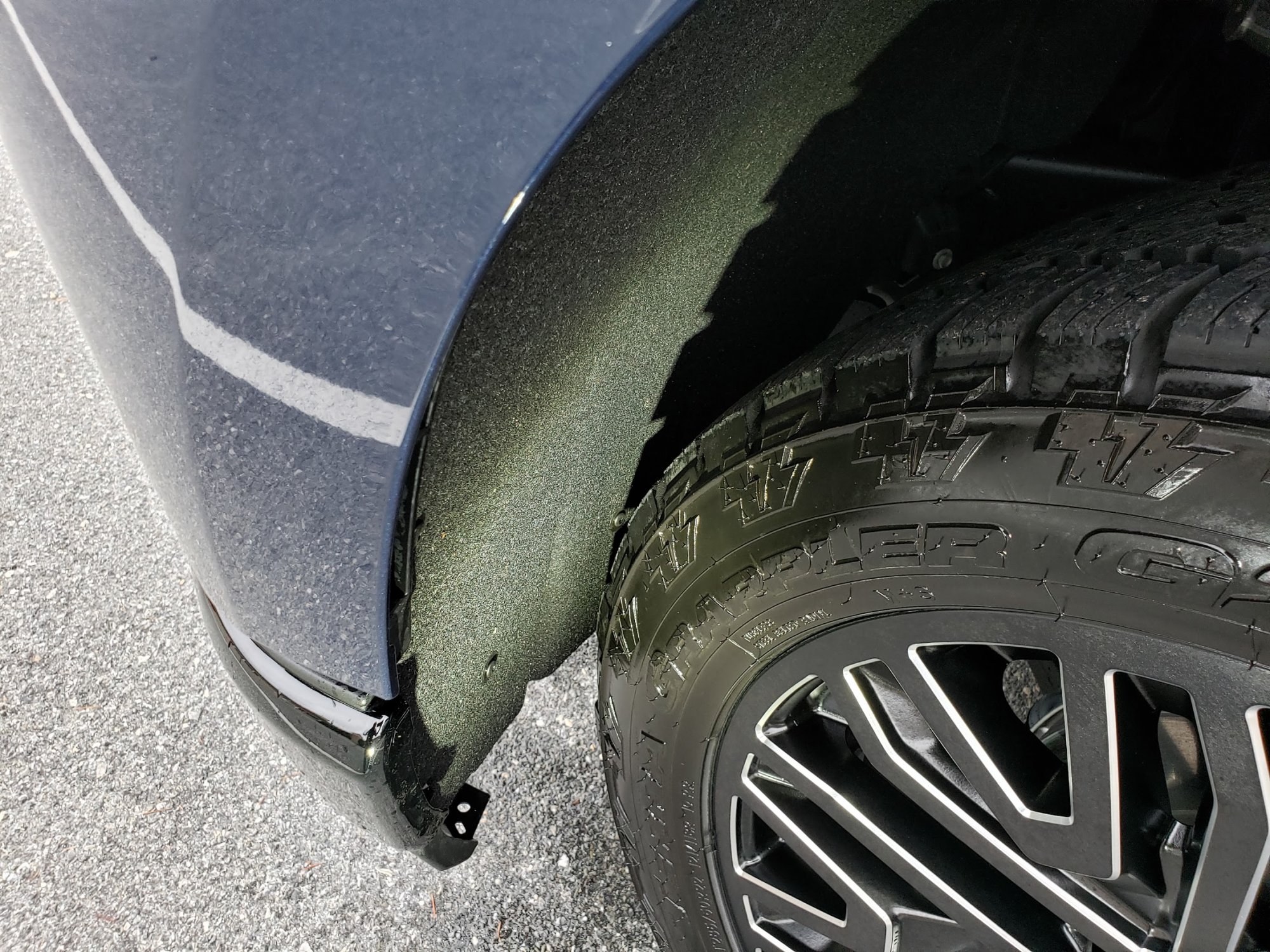

Considering buying a 2019 Denali with the factory 22" wheels.  I'd want to level and replace the stock tires with the biggest possible Nitto Ridge Grapplers that will fit without (or very minimal) rubbing.  I've searched and searched the forum, but now I'm more confused than before.  So, with a level kit (considering Rough Country 2" for Denali with ARC), would 285/55x22 Ridge Grapplers fit?  Anybody running this on factory 22" wheels and if so, can you please share pictures or point me in the right direction?

I don't have your exact setup however, I'm running 285/50/22's on my TrailBoss.  It has the factory 2" Lift on it.  No Rubbing at all on standard offset 22" wheel.
I think the 55"s will fit as I have quite a bit of space at full lock before the tire hits the inner fender liners.
I didn't check the control arm clearance.
Remember the GMC has different wheel well openings. 285-55-22 RG = 34.6. 285-50-22 = 33.5. Both are only 11.69 wide.  I have seen guys run 305-45-22 = 32.80 without interference with the control arm using stock wheels.
That's a great point.  Now that the wheel wells are different between the GMC and the Chevy.  It might be a tighter fit on the GMC with the squared off design.
305/45/22 will fit with a 2” level. Note: not my truck but asked the dealer all about it.
