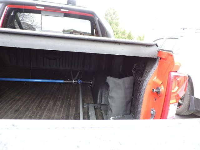

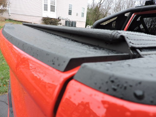

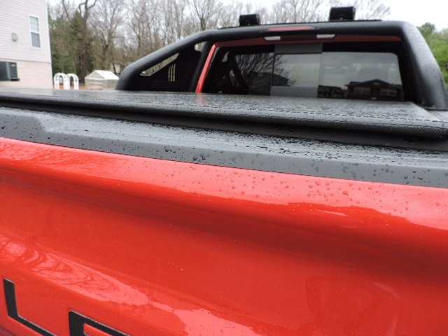

Most covers will make the '19s motorized tailgate inoperable if they touch the top cap of the gate, which most have to do to get a rainproof seal. Any pressure or resistance on top of the gate and it will not open with either the keyfob or dash button.
OEM version with the appearance package has been modified to leave a 3/4" gap between the bottom edge of the tonneau cover and the top edge of the tailgate. A 3" curtain on the back of the tonneau seals against the back of the tailgate and any water forced in under pressure flows down the inside of the tailgate and out the bottom gap to the ground....and none gets onto the floor of the bed. The OEM cover, or equivalent type if you can find one,
permits motorized gates to open and close just fine.

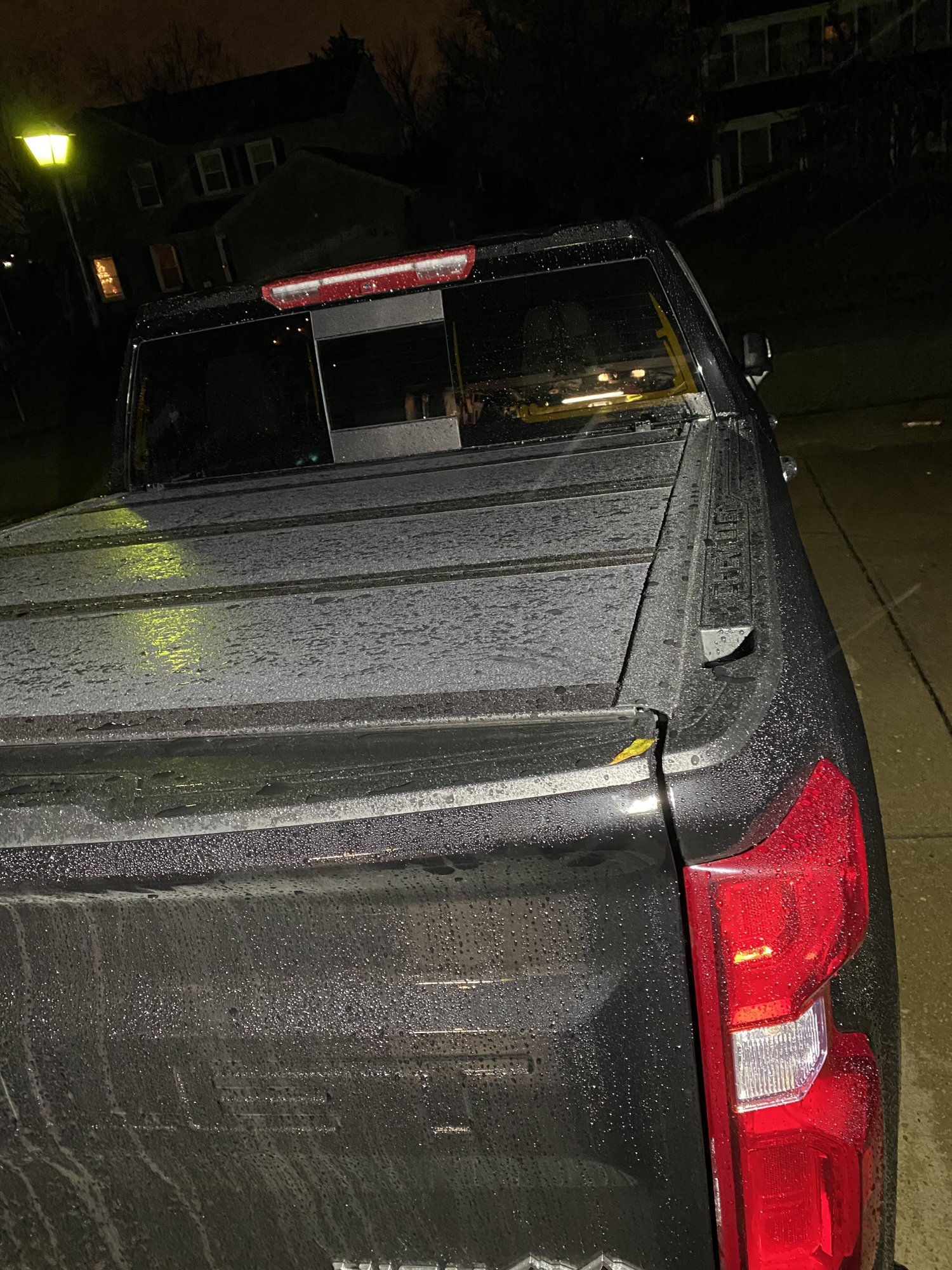

This is some great information....The cover also looks great on your truck. What brand is that?
No ID, came OEM, just a chevy bowtie imprinted on the cover.
