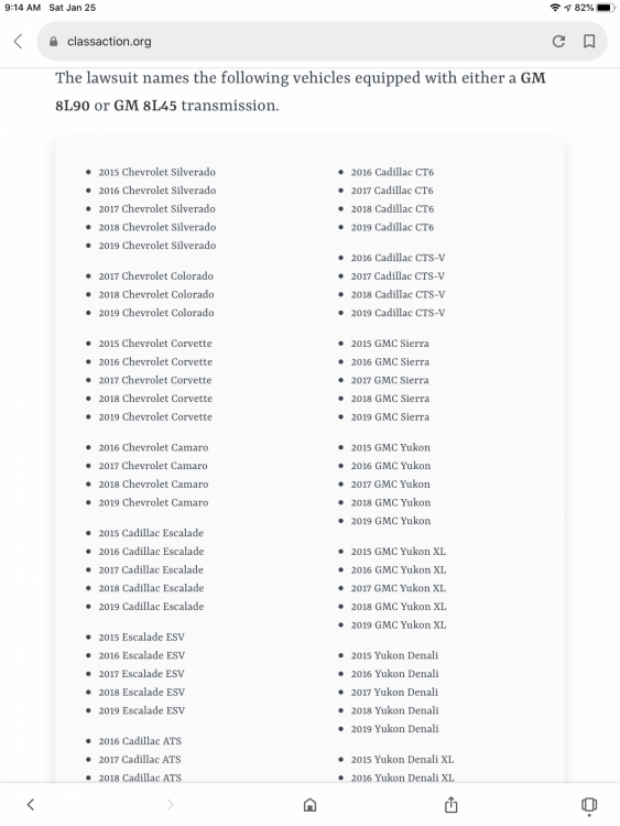

Folks if you do a search GM is being sued in many states right now over 8 speed transmission issues. Many Many law suits. That’s why I am recommending getting the 10 speed if you can. And the list goes on and on.
