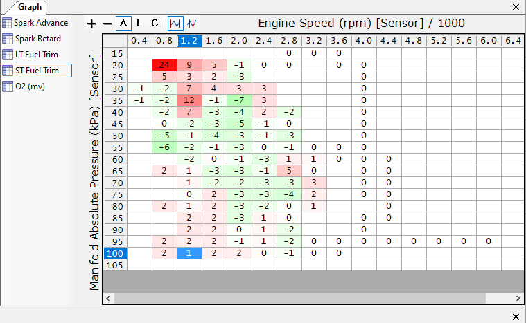

Well it looks like STFT and LTFT are actually almost perfect so I think I can rule out Fuel. Looks like MAP needs to be 90kPa or higher to reproduce the shutter/misfire. I'm starting to lean more and more towards torque converter.

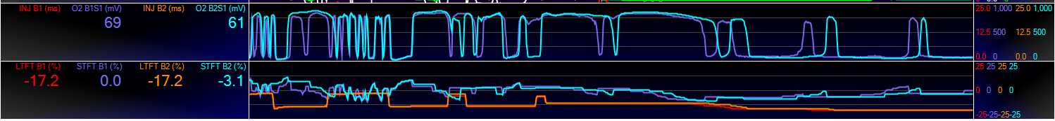

Well small update, looks like something might be going on with fuel after all. My LTFT values are peaking towards negative 17-18% over time but only at idle.
The little orange "squares" spiking upward are me hitting the gas. All trims start out a 0% when engine starts. LTFT takes about 15-25 minutes to hit -17%.
I noticed with my tune I'm adding fuel around the RPMs I'm feeling the issue and it gets a lot better. Not sure what to think about this yet.
Doing a little bit of research it looks like its potentially PCV Valve or a vacuum issue somewhere. I ordered a valve and going to replace tomorrow. For $8 its worth it to swap out just to see.

But does that make sense to you? A vacuum issue would introduce air into the intake, the computer would compensate and add MORE fuel, not take away fuel, right? So you'd have + fuel trim, not negative. Vacuum leaks skew the fuel trim positive.
And there is no PCV valve on these trucks, it's a fixed orifice, it won't get any larger and cause excess flow. You can replace it, but it's not a PCV valve. And if you did have a vacuum leak in that part of the system, I think it would cause a misfire at cylinder 5  (because the PCV line dumps right above cylinder five at the intake). If you have a catch can, potentially you may have a leak at one of the lines causing a vacuum situation, but I still think your fuel trim would trend +, not -.
I could be totally wrong, let me know what you find out/how it goes.
