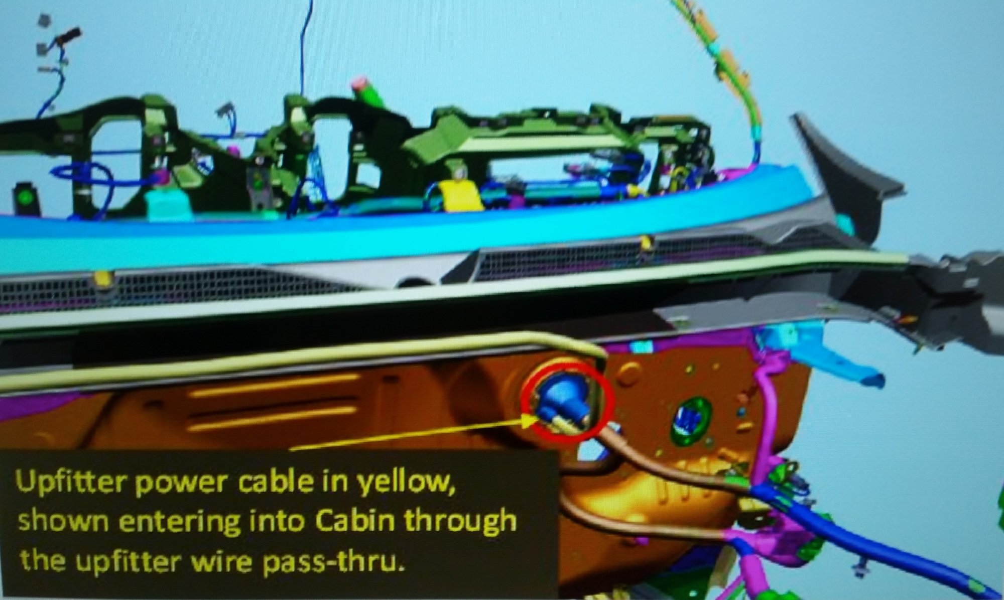

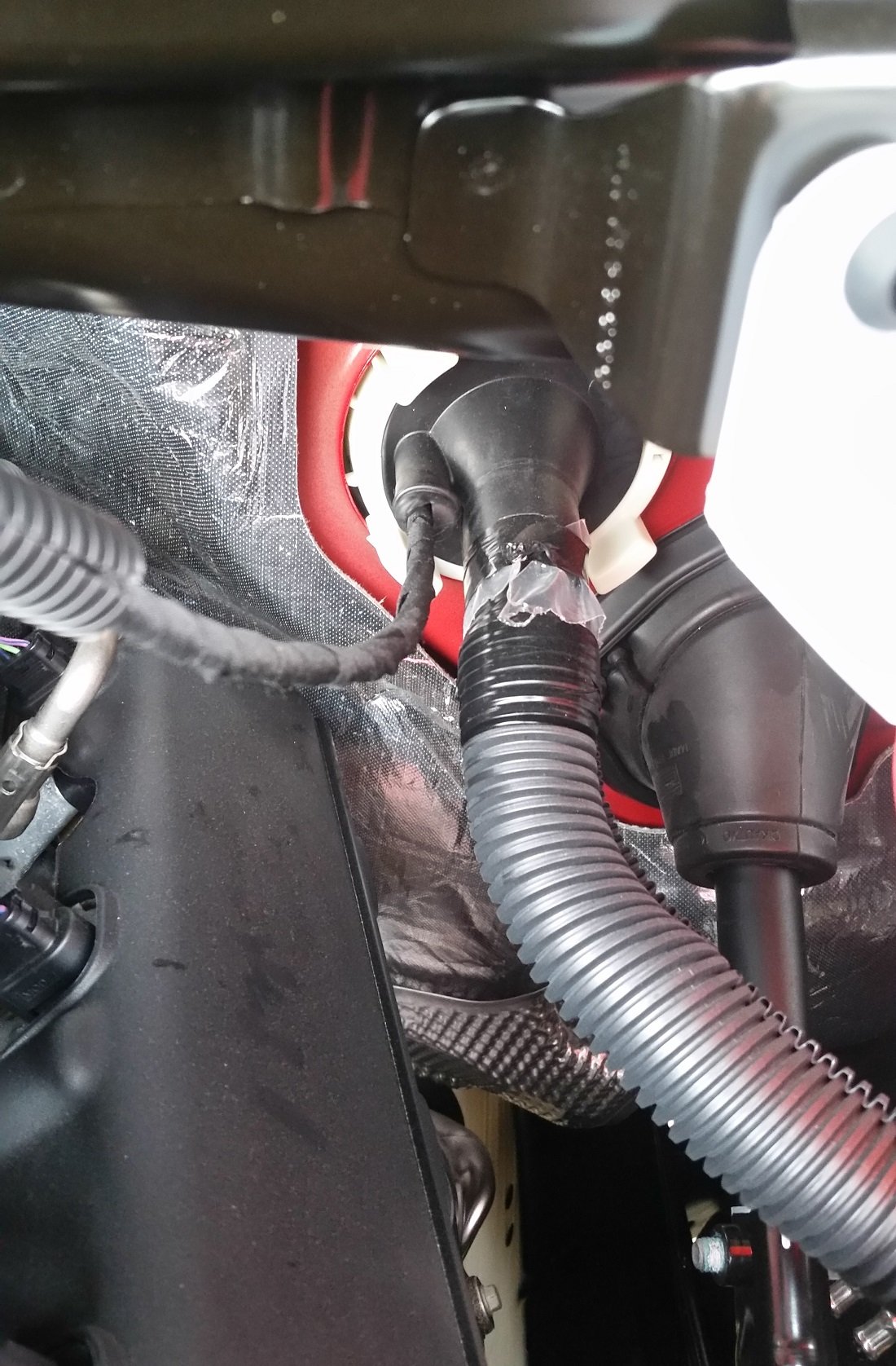

We just installed upfitter switches on our 2020 Fire Dept. SSV Silverado.  Here's where the instructions said to run cable through firewall.  We just made a small slit in the rubber boot and it worked perfect. You can put a little sealant around the slit and cable.  Here's a pic after install.  Hope this helps.
Is it a diesel?  I don't recall seeing a boot that large and accessible in the engine bay.  I'll look again tomorrow.
Perhaps I'll reach out to GMs outfitter team for advice if I don't have the same boot available.

No it's a 5.3.   Email Robert with GMupfitter.  [email protected] or go to the website.
http://www.gmupfitter.com/
