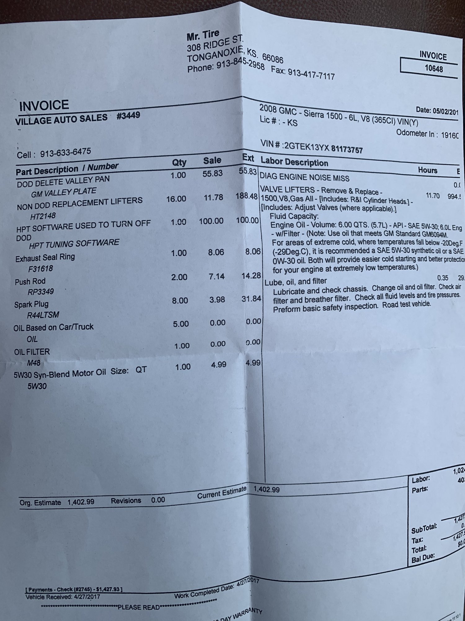

I got an 08 Sierra Vortec Max with around 245,000 miles on it. Debating whether to rebuild, reman, or new crate. My truck has the L76 engine, if I swapped it out for a L96 what all else would I have to change?  Computer or wiring harnesses?  Mine already has the afm/dod delete done on it. Any other suggestions?

I guess one of my questions is, how is the AFM/DoD currently deleted on your truck now. Is it just a tuner than shut it off, the range dongle OBD2 plug in or did you remove the parts completely and swapped them with non AFM/DoD camshaft/lifters/trays etc etc.
That will determine what other tuning is required on this engine swap.
A couple pieces of that puzzle seem to be missing.
The DoD valley plate and the lifters were replaced but it didn't mention anything about swapping the camshaft or lifter trays that also have to be done. No parts listed for head gaskets, timing cover gasket and so on. It also only lists 2 pushrods, were as 8 would be needed to replace the 8 that were removed for the DoD lifters. Just seems odd is all.
The big picture is that a L96 will swap in. Past that I would still want the tune looked at to make sure the VVT camshaft is allowed to function. I just don't know what they did with the calibration with the current engine in it.
