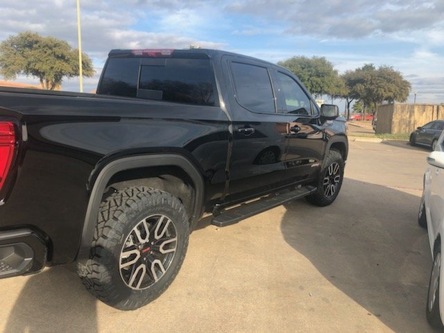

I recently just got in a new 2020 Sierra. I want to put the 2" level on it from Rough Country like I have done with past trucks I have owned. On my 2014 I ran a Cooper STT Pro 275/65/20. This truck I would like to run something similar that I do not have any rub and won't have to cut. I have read that a 295/65/20 will fit with no rub, I am looking at the BFG KM3. Anyone doing this, or have any experience with it? If so do you have any pictures? Thanks in advance
295/65/20 on stock rims/ 2 in level should have no issues , maybe a slight rub . Some have it some dont. If you do rub in may just be when steering wheel is fully turned . My unce is running 295/65/20 on his stock AT4 and there is a slight rub. nothing noticeable.
Thank you for the response. If you don't mind do you have any pictures of his truck? I bought a Denali, and yes i am going to run stock rim with a 2" level kit. I would just hate to buy the tire and then it rub super bad. I don't mind a little rubbing, but I would just hate to have to cut. Thank you for the information. Just wanting the biggest tire that can go under there.
295/65/20 depending on the brand (Nitto) runs into a 35.5" tall tire. I went with the Nitto Ridge Grappler 35x11.5x20 on my stock At4 no rub and a good half inch between the tire and control arm.
IMG_2192.jpg.3382b49ac50525381b7eee87e6810fc3.jpgIMG_2191.jpg.a3bb8e088fc806e9a7570ebeb119a154.jpg

That looks great!
thanks! they ride great and are quiet- I've taken several customers and fellow employees out in the truck since i bought it a week ago and they all comment on how smooth it is and then when they get out they check out the tires.

Is that stock ride height or leveled?
this is stock height but i do plan on adding a 1" front level  down the road
