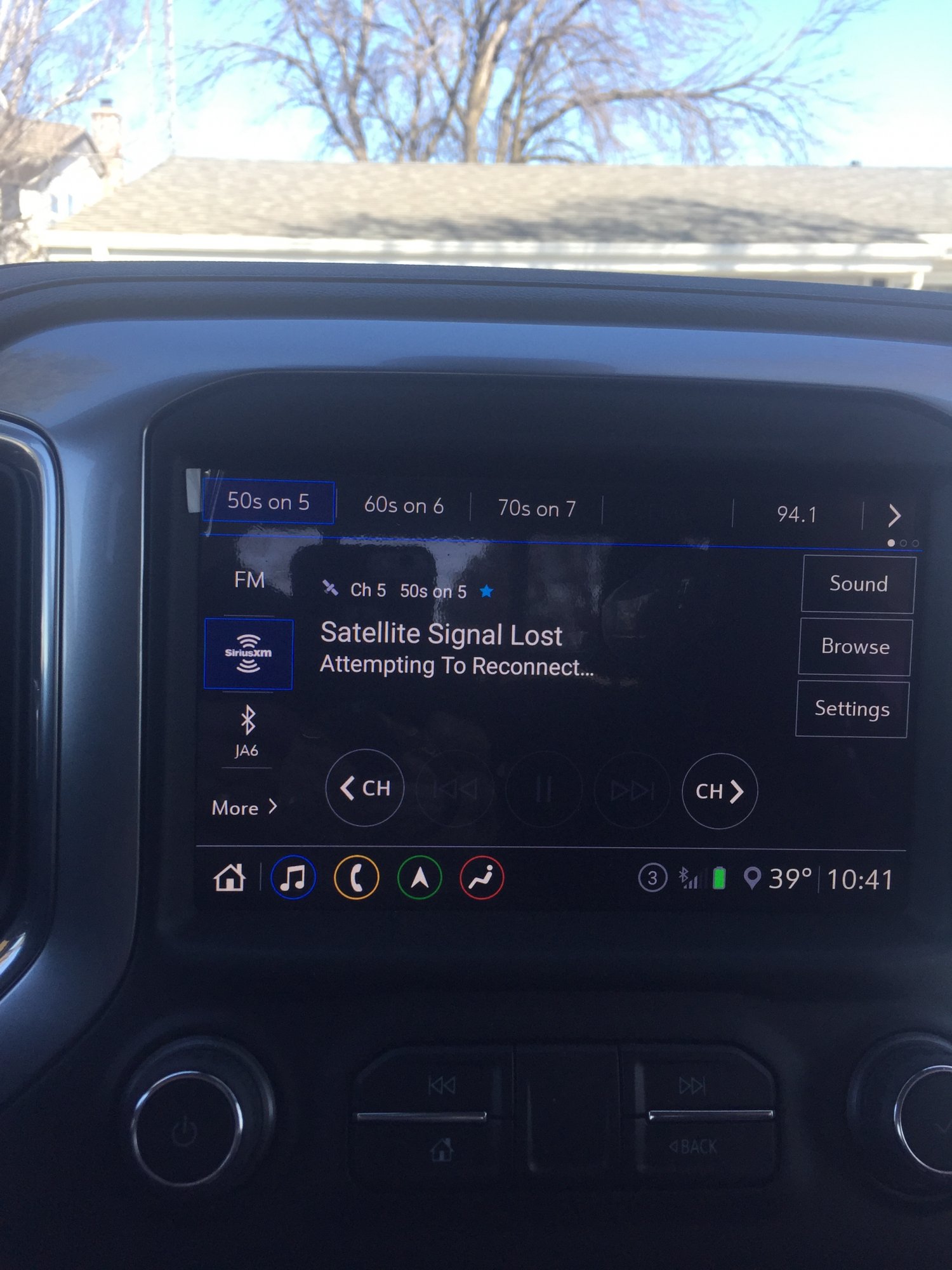

i have the same issue, pretty annoying.  I also sometime get the message, "Satellite signal lost.. Attemping to reconnect..."  The dealer never saw it happen but I showed them the picture on my phone.  Their story was, you must have been blocking the receiver by being in a garage or behind a building.  With this error on the screen to only way I have found to get it to work is to stop and power down the truck until the retained power is shut down. At next start the error does not return but the XM audio problem is still there.
If the dealer can't make it happen or see the problem, you don't have a problem.
I have had the issue where it will not find the satellite signal and the only way it works again is to turn off the truck. I have had that happen about 3 times, not lately that I can remember, but I would have to just listen to a local radio station while hoping it would find the satellite while on a 45 minute drive. I never told my dealer about it, figured it was an XM Satellite radio issue at the time.
