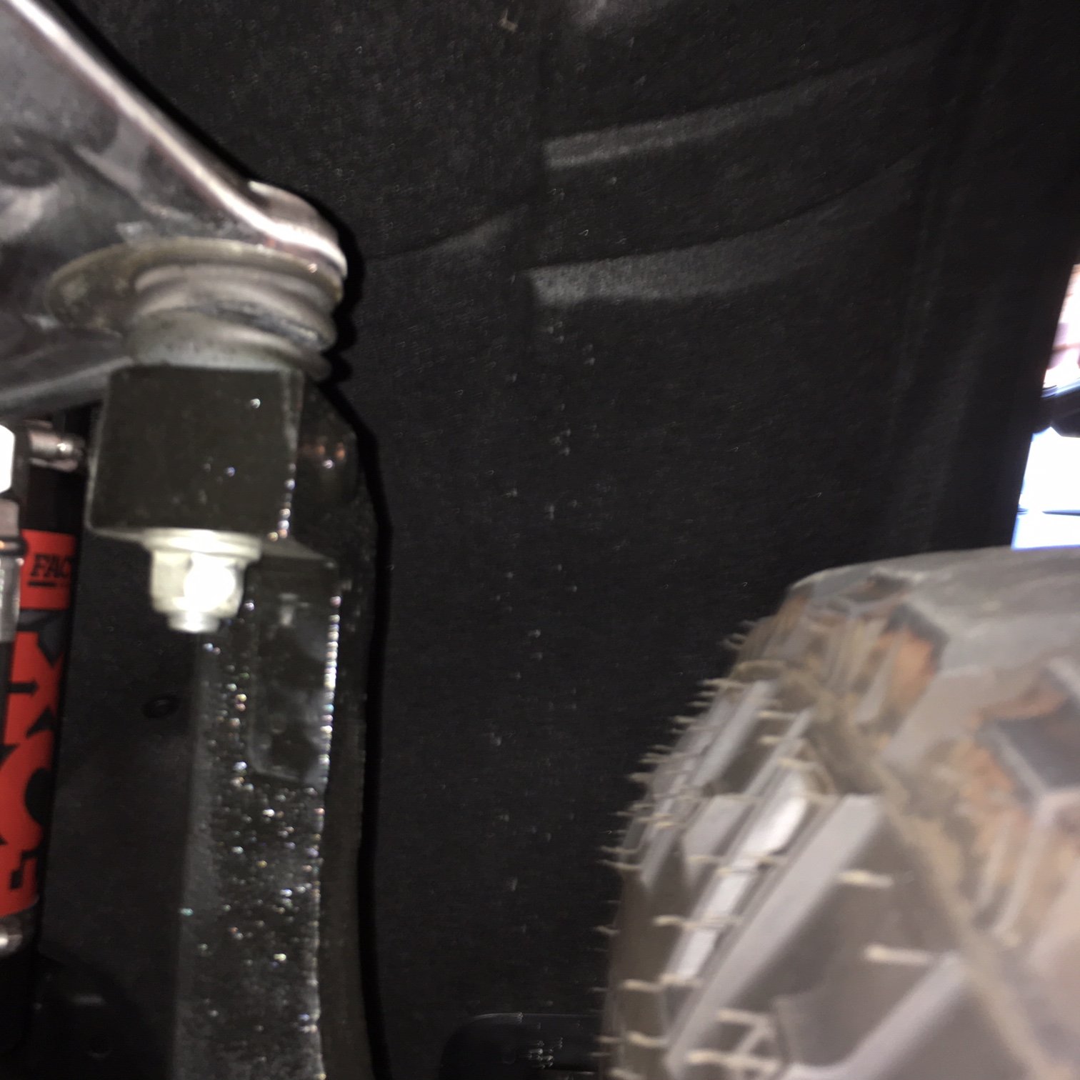

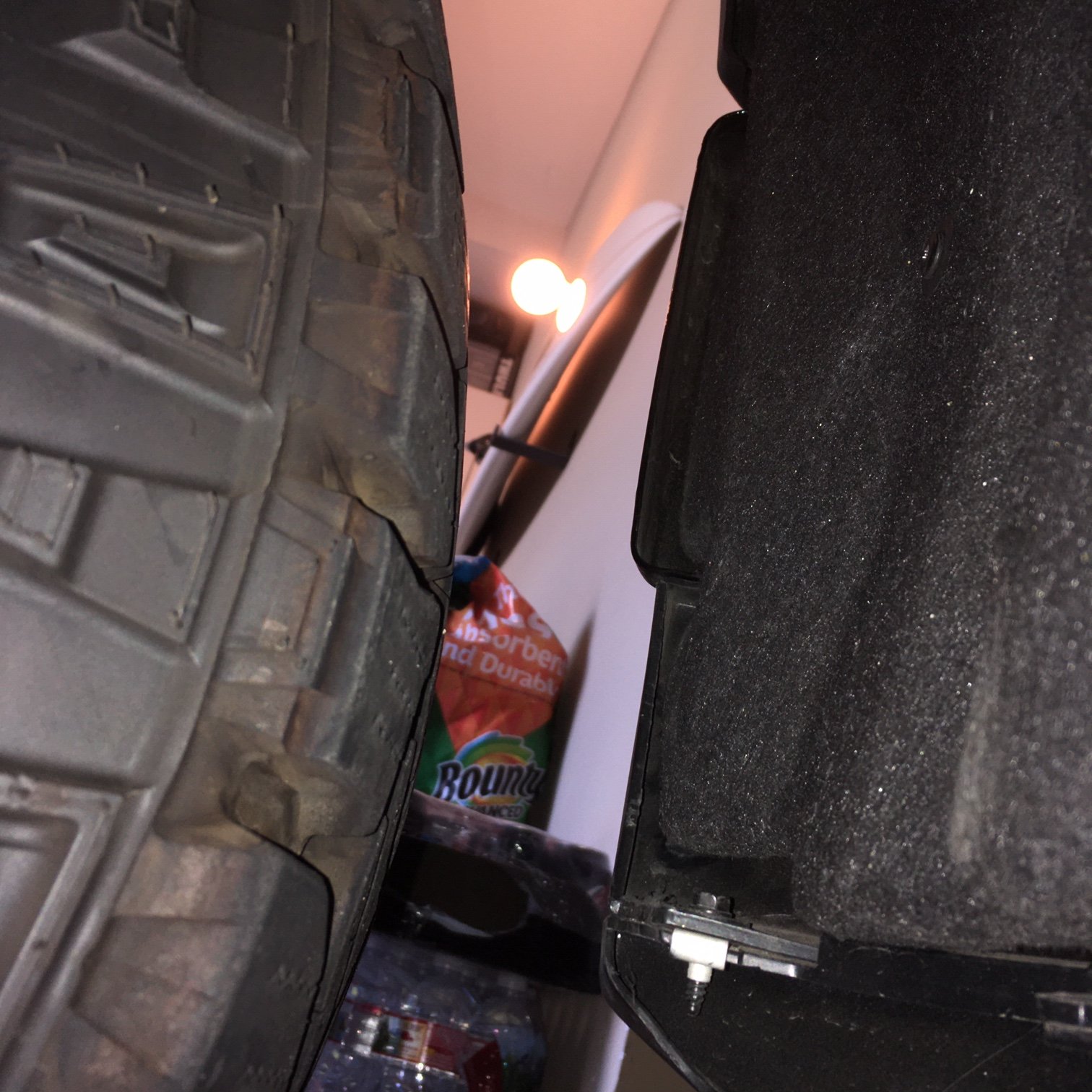

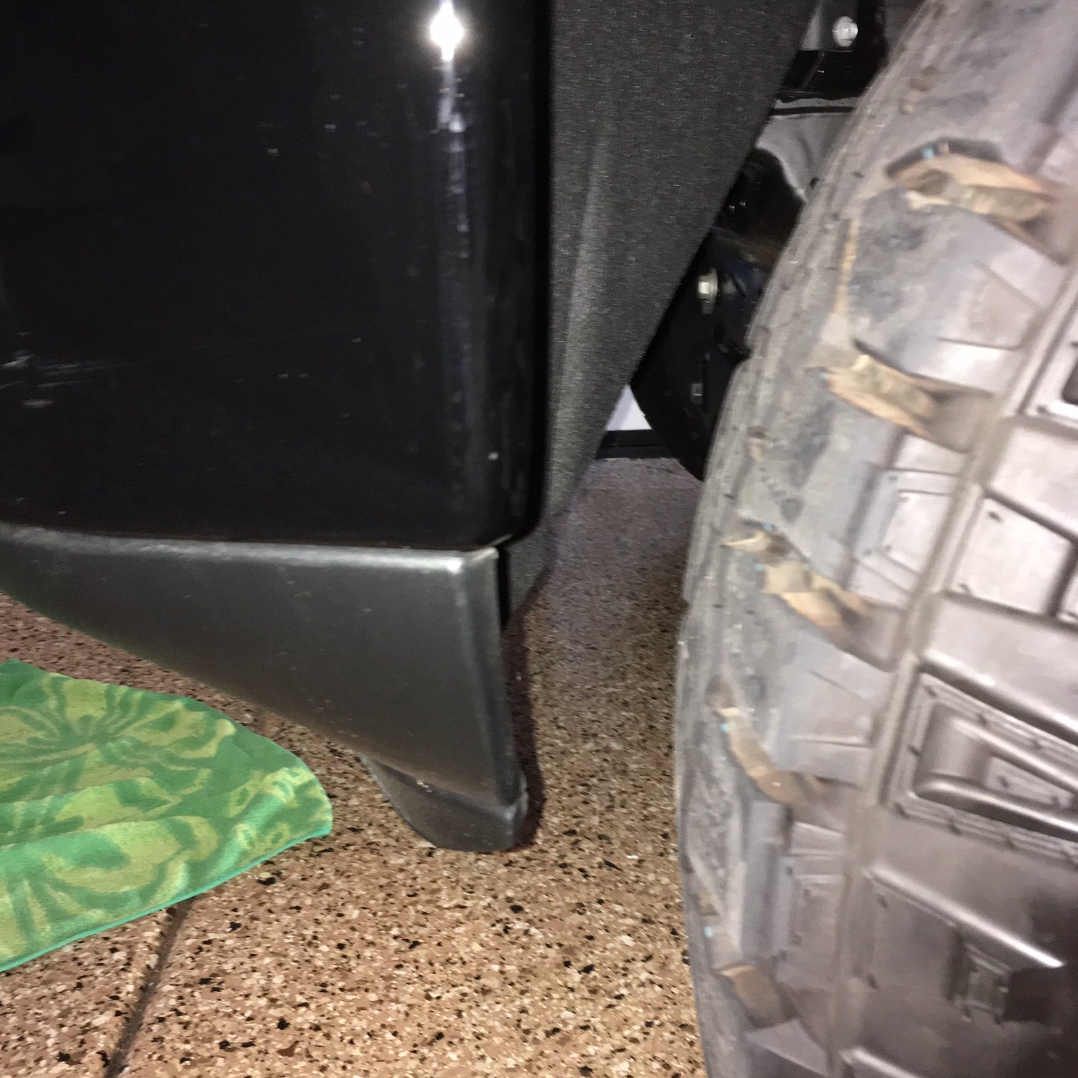

I have a 2020 AT4 Carbon Pro - I did the 2.5" lift (so 4.5" overall) with fox 2.5 coilovers  - I have Method 18 x 9" NV's with 18mm offset - they did not clear the tie rod, so we had to go with spacer and wheel lug extender to gain about 1.25" of backspacing, so clear the tie rod.  The method -12mm would be the recommended fit.   With 20" the tie rod will go inside the wheel radius, making that more flexible for offsets.
With 17" you will have the same issue I had, but not as bad due to 0 mm offset - might barely fit, but if not with a 1/2" spacer you should be good to go on the tie rod issue.  But you will need to do some trimming to fit the 35's.  Pinch point will be the front fender where it tapers in - you only have 2" - going with 35" over stock 33's should eat all that up.  I will be very interested to see how yours turns out, as I am looking to get new wheels and larger tires - so if you fit 35's will be interesting to see what all is invovled.   I still have stock 275/65/18 duratracs on mine.
Here are some photos showing clearance - FYI - no issue on inside clearance on steering knuckle for tire - 4" of inboard room at least - so 12.5" section width will be no problem over stock 11".

Awesome truck! Thank you for the response. All these makes me nervous haha. I hate that you get different answers when you talk to different companies or people. Dirt King, Fox and Camburg All said I’ll be fine. Method recommended 0 offset with a 4.75 back spacing to fit the 35x12.50x17 on my Silverado. With that said the wheel wells are different from the Silverado to Sierra. So I’m keeping my fingers crossed for a smooth install.
