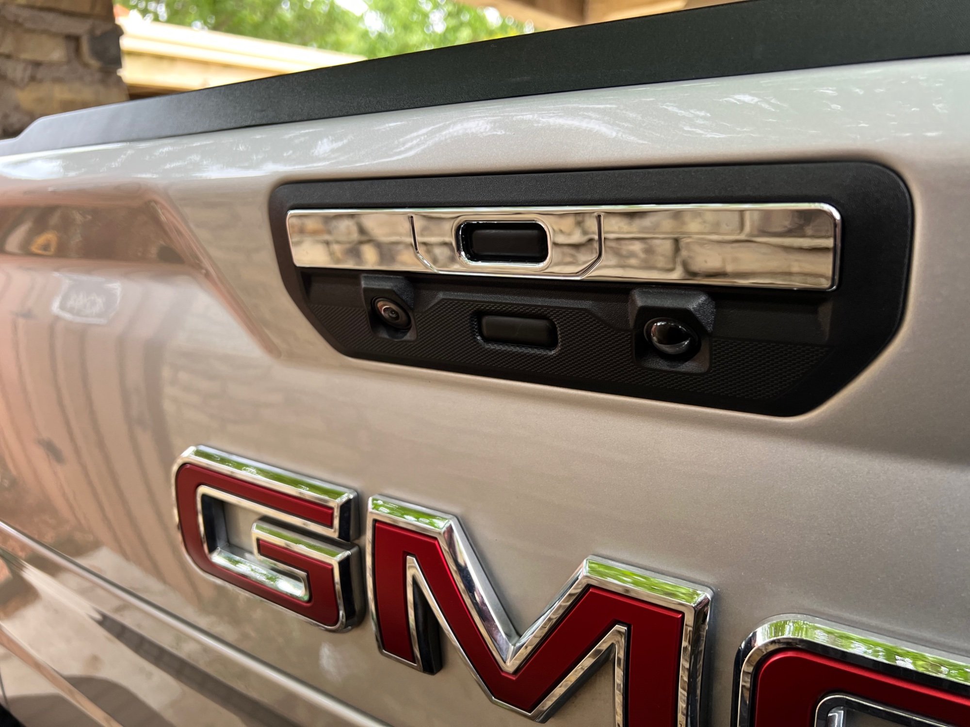

To follow up, I did order the new handle cover with the chrome piece (I couldn’t find the original all black cover by itself), and installed it myself. I’ve included some pics if anyone is interested.

On 4/25/2022 at 10:33 PM, TexasKeith said:
Another angle.
Did you have to drill holes in the piece you mount the handle to? Mine does not fit because of the screws that hold the chrome piece in.
No. I popped the panel closest to the tailgate handle on the inside of the inner gate, to remove a bolt. Also had to unscrew the light and the camera from the old cover. New cover fit in perfectly.
