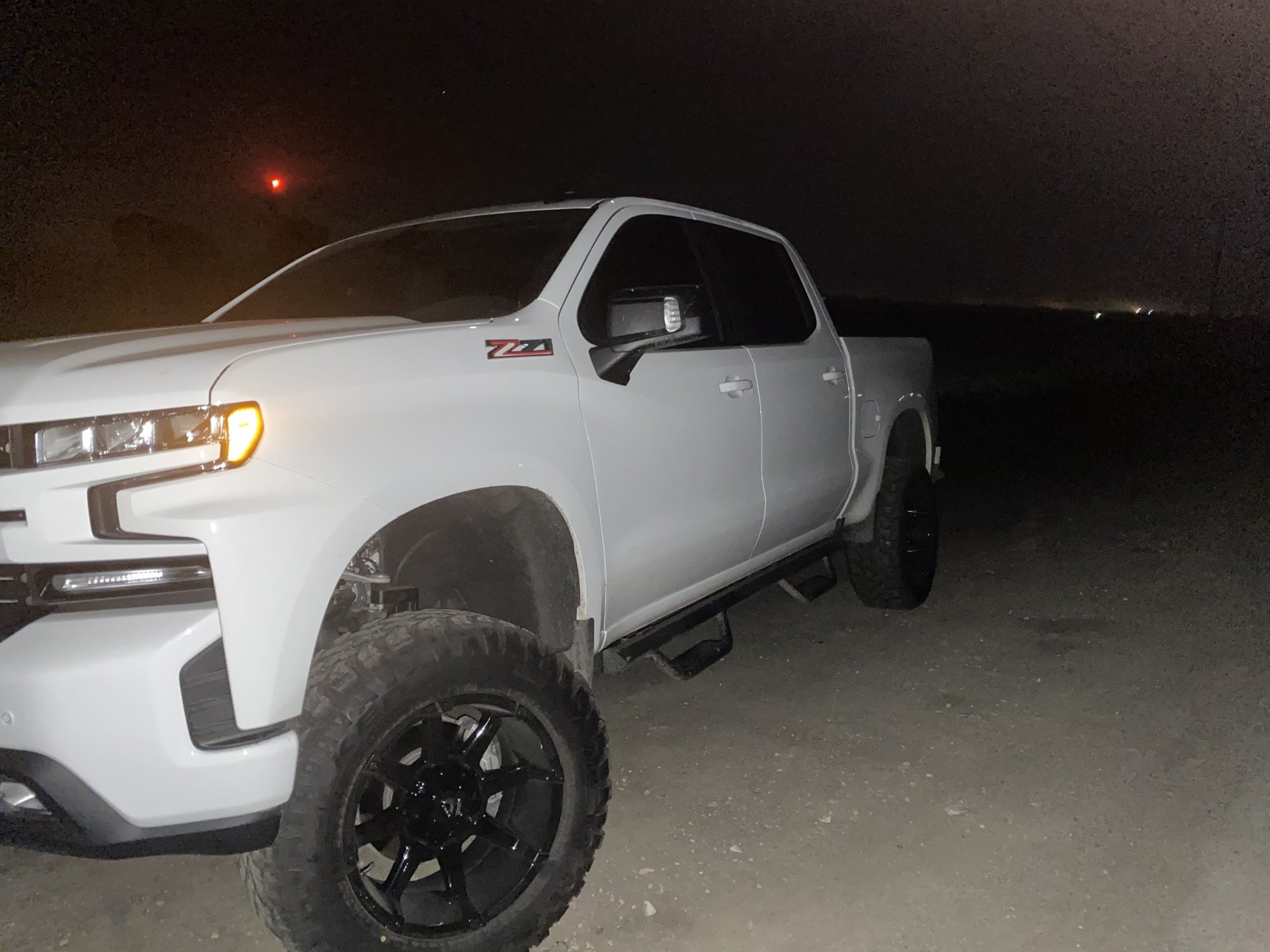

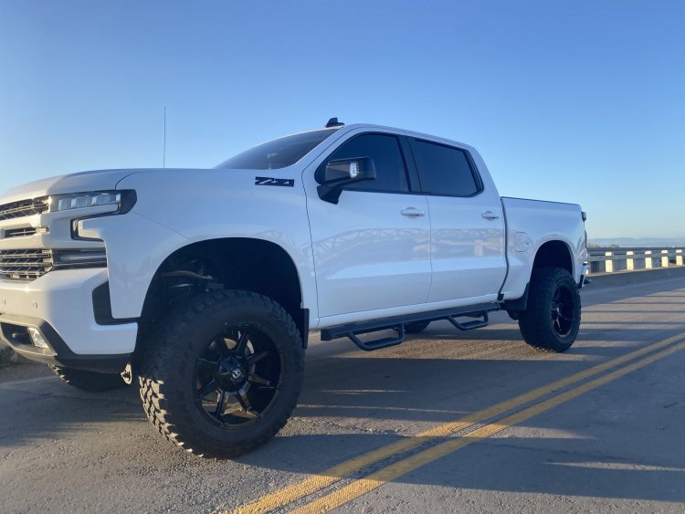

I have a 2019 RST with regular mirrors and want the tow mirrors. Mine don’t have any cameras or task lights though. Also not sure if the 2020 will work with 2019 mirrors since the 2020 mirrors won’t fully work with the 2019 ones.

I have a white 2020 Silverado RST with tow mirrors would anybody be interested in swapping for regular mirrors?

I am Interested, I plasti dipped the caps white already.
