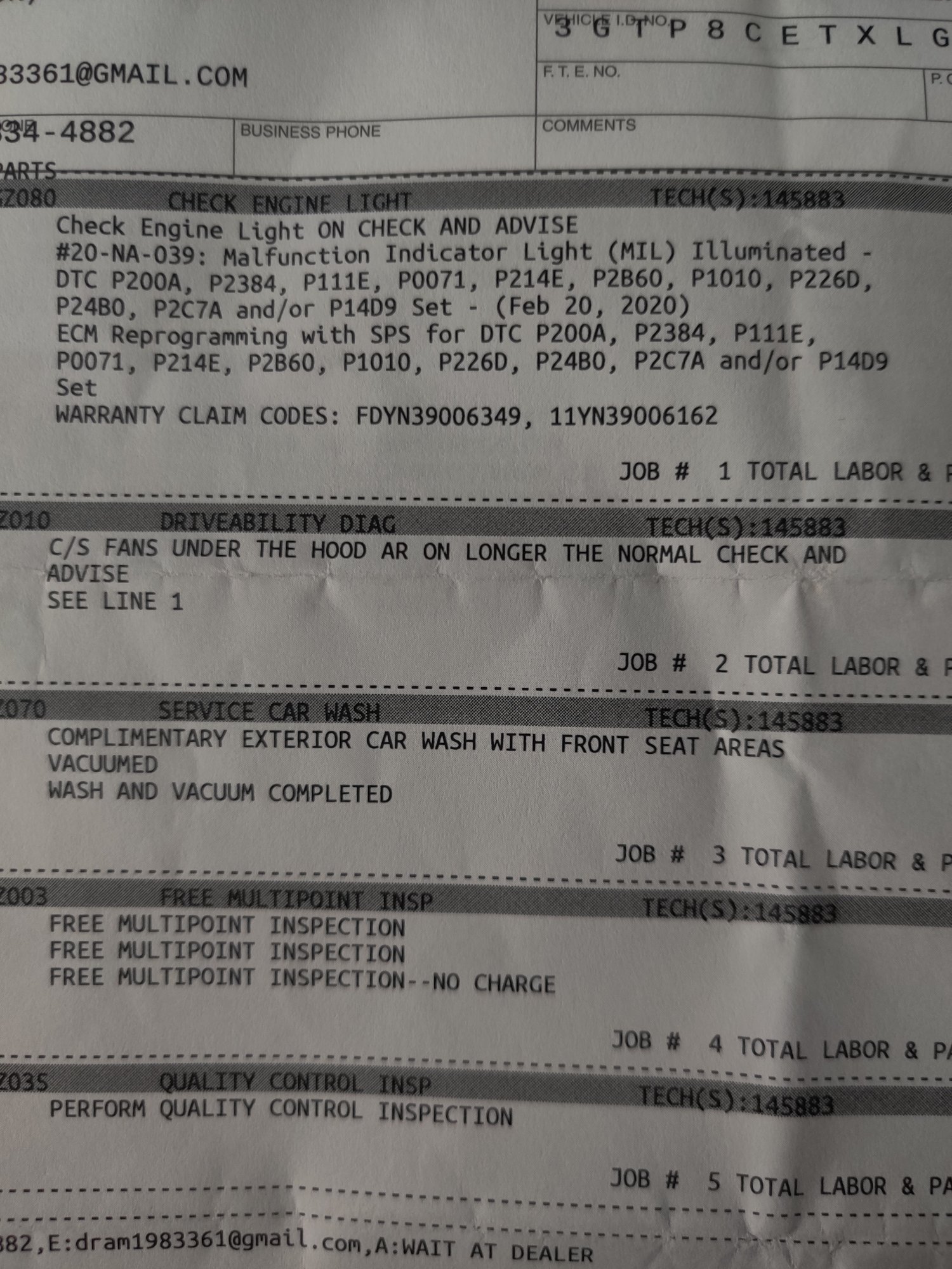

What's up, Long time lurker. Had my truck for 3 weeks, 1100 miles. Popped the P200a a week ago, cleared it via hptuners, then came back yesterday. Had OnStar scan it and same code but they couldnt see what the code ment. A quick Google search is bringing up a general code for intake manifold runner. Going to get it in to the dealer asap. Anyone else have this code pop?
Edited by dram1983361
So I took it in this morning to the dealer, they said the computer needed to be re-flashed with the latest calibration and should solve the P200A and the fans running full blast from time to time when it's not hot outside.
I'm assuming if you get any of the code listed in the print out, you need the updated cal.
