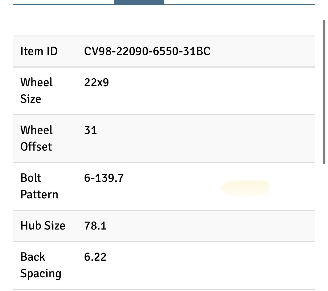

if anyone isn’t sure what the snowflakes are here’s a pic.
I think you might need a spacer if those wheels are a stock pre 2019 offset. The brake caliper sticks out father on the new models.
