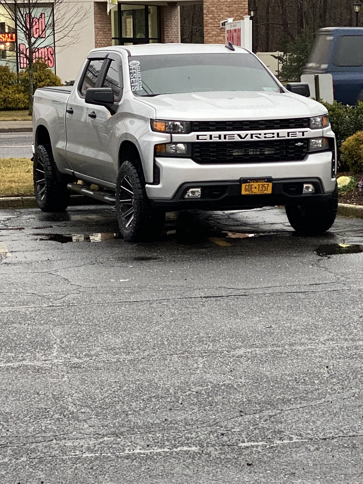

I have the 2.5 Moto fab top mount spacer on my 2020 Sierra crew cab. I originally installed the Rough Country bottom mount spacer but removed it and installed the Moto fab due to clearance between the CV boot & the strut bolt. Only issue I had was when you mount the spacer to the strut you have to rotate the strut 180 degrees when reinstalling. This causes the tabs that mount the strut to the control arm are angled in the opposite direction making it impossible to thread the bolts in. I took a large adjustable and rotated the tabs to match the angle of the control arm. I saw where the Rough Country top mount spacer disassembles the strut and rotates it 180 degrees. (Check their website) Looks to correct the angle of the tabs when reinstalling the strut. As far as the height, I installed the rear factory spring blocks that I removed from my 2014 Sierra and have about a 1 inch rake. You might want to add a 1 inch block to the rear...
Hope this helps!

Thanks for the feedback man! Your truck looks great. I am going to install the 2.5” kit and see how it looks and then make my mind up on if I will add 1” blocks to the rear.

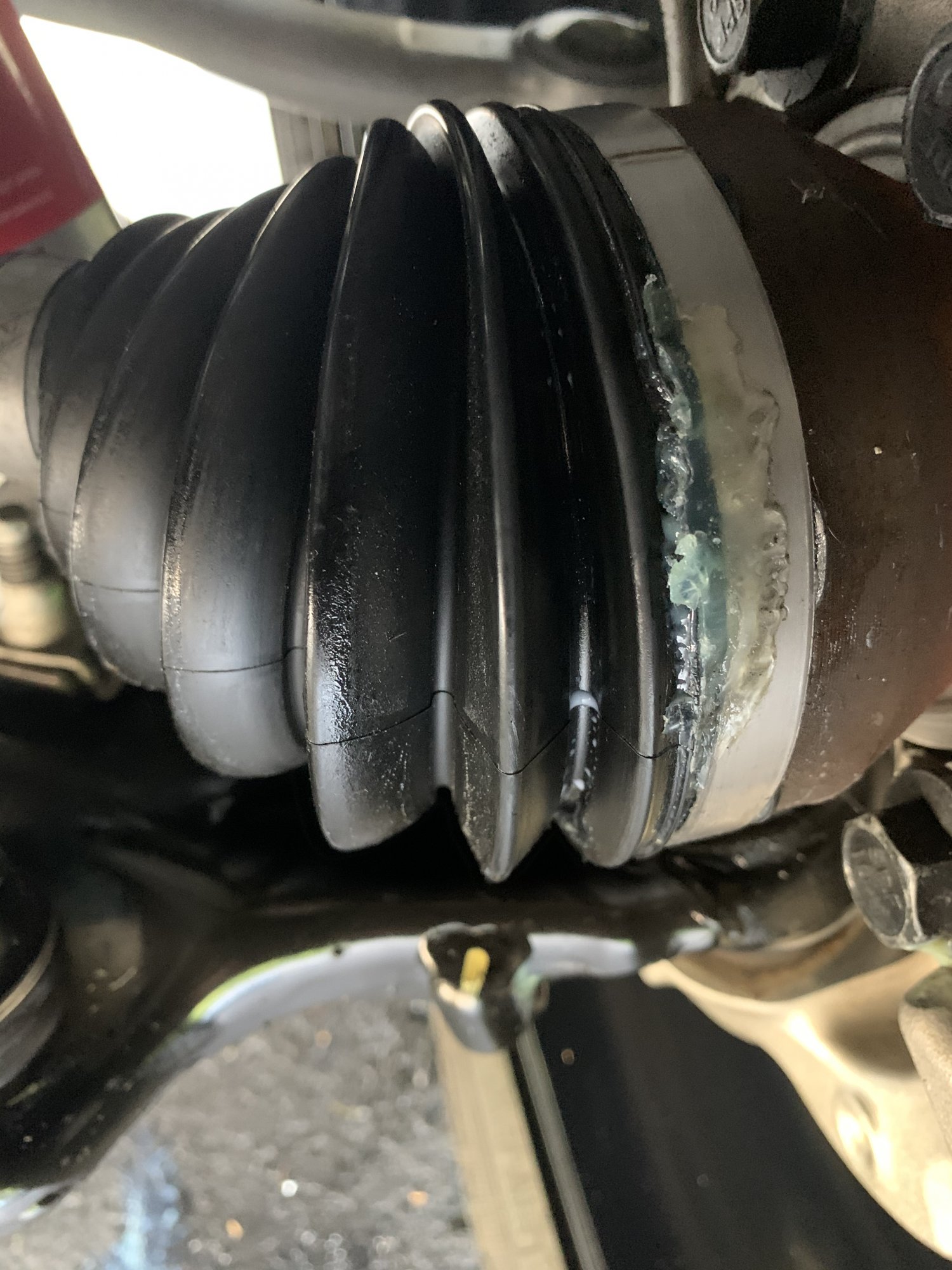

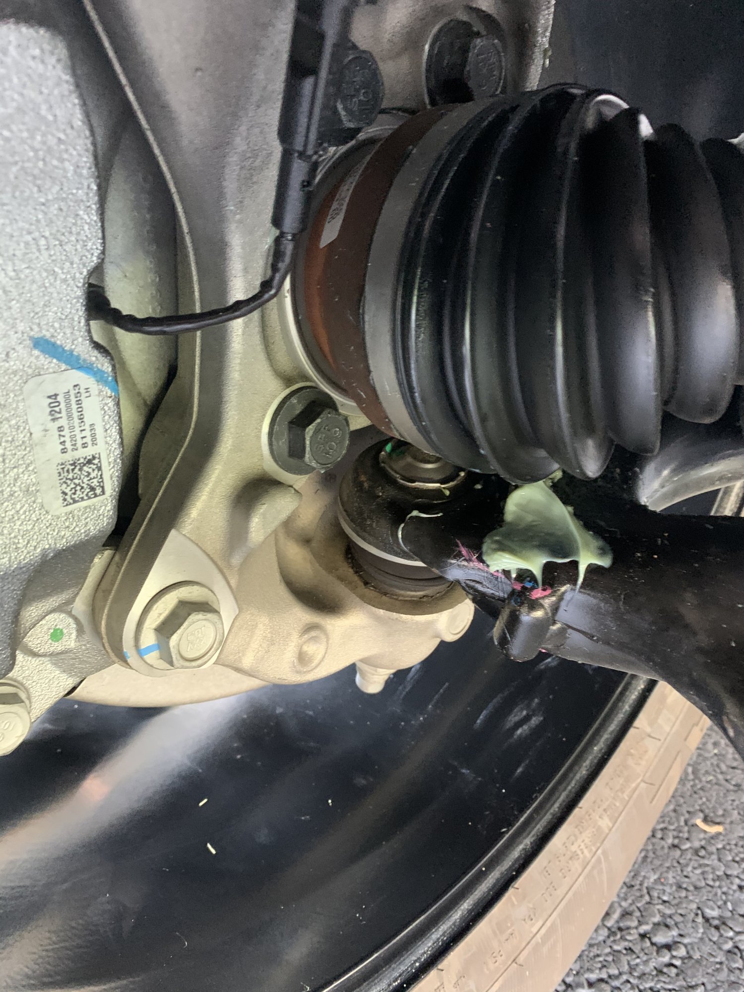

I posted on another thread about my cv axles leaking. I have the Eibach pro lift kit which is as adjustable front strut,  coil springs and rear shocks.  It’s probably just over 2inches of lift. The dealership installed it and maybe a month later I had green grease all over the inside of the front  wheels and control arms. The dealer is ordering new front axles currently back ordered. I asked about getting the trail boss cv axles he didn’t think there was a difference in length. There was also glue around the cv boot on both sides they may have been torn and repaired. I’m not sure this is how it comes from the factory.7A8C2224-7862-4240-B1D0-D2BDB2986432.thumb.jpeg.4b0c24410cf87f7a1a85b9798ec66a26.jpeg
