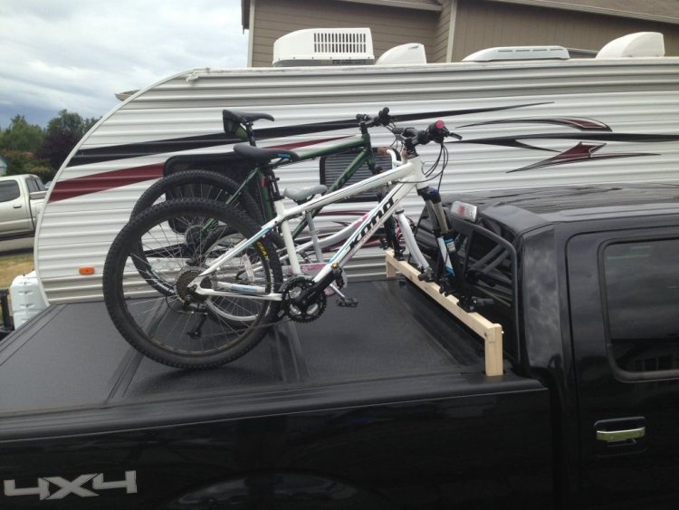

Could you fabricate something like this?
How do you keep your bikes from swaying from side to side? I like the idea and would like to use it for the same reason, hauling a travel trailer.
BTW,  these are not my setups.   I just googled it and looked at images -
https://www.google.com/search?q=bike+rack+on+tonneau+cover
Then click the images

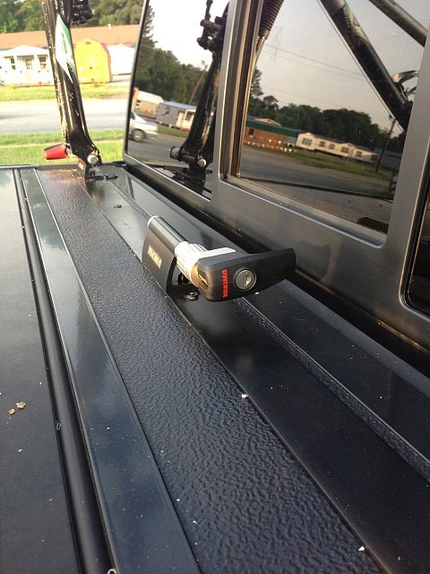

Here is my take on the tank mount. I used emt conduit mount that I had laying around.
I cut 2 45 degree cuts through the sides, but not the back with my circular saw and bent it into a 90.
I then welded it. I then cut them to equal height and but then on the truck. Marked the spacing on the cross bar and removed to weld.
Painted the whole thing. Now I just need to get my fork mounts. It attaches through the stake pocket with 2 3/8 toggle bolts on each side. 24216a77da4a18df757f192ed5fc7f2c.jpg
