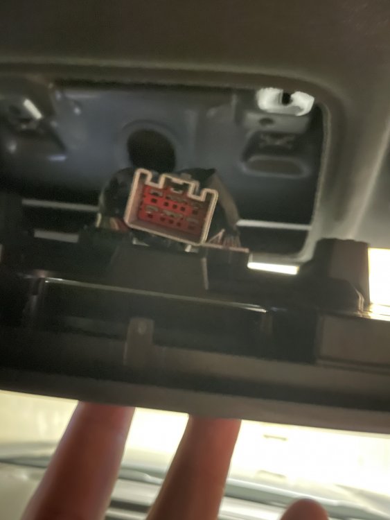

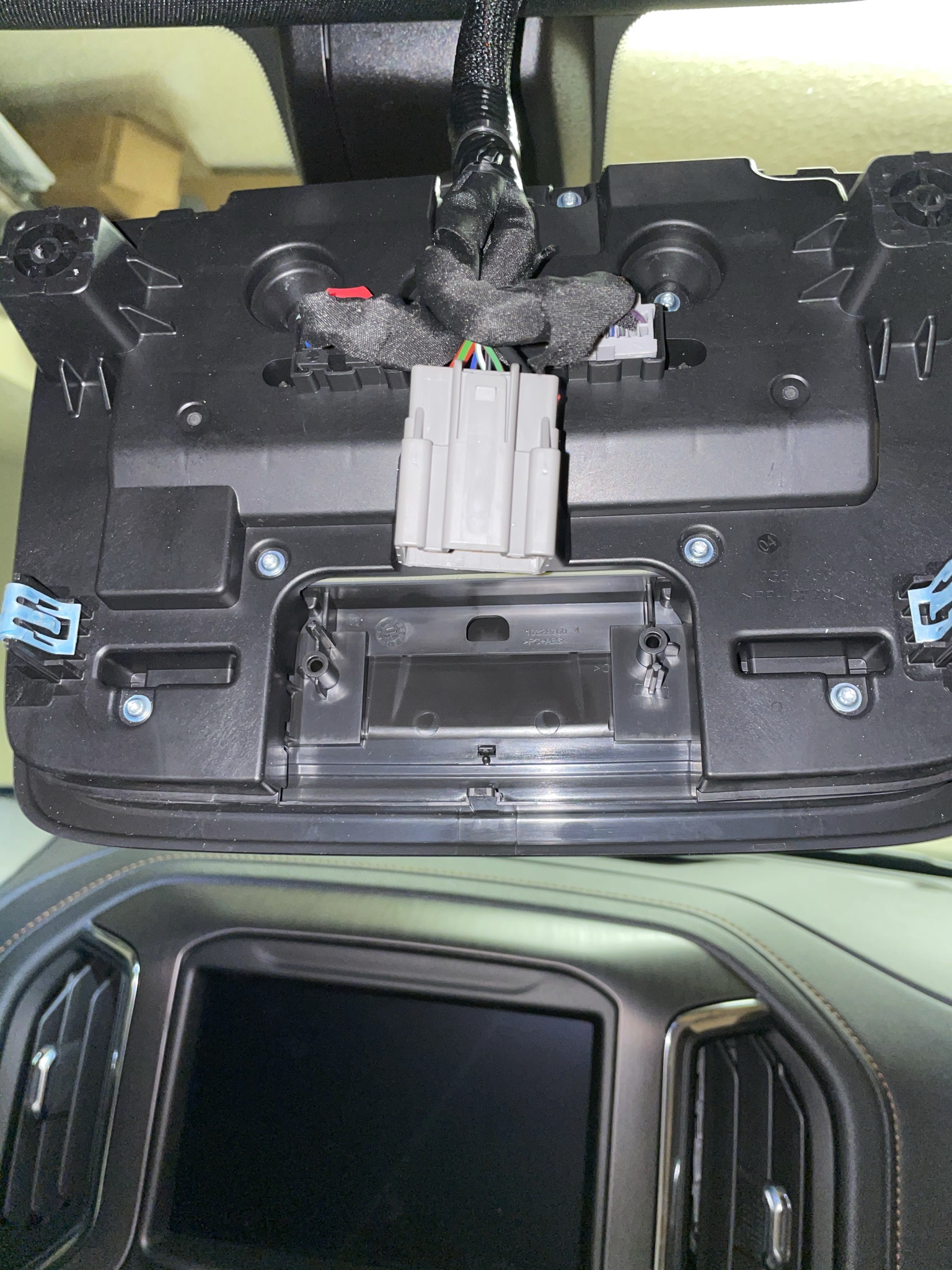

I just got delivery of a new at4 without sunroof and rear sliding window. I took off the upper console like you did and I'm sure you noticed there was a large unused plug there. I want to replace that to add the new console with the control for the rear window but y ou dont think that big plug could be the harness for the rear window?
