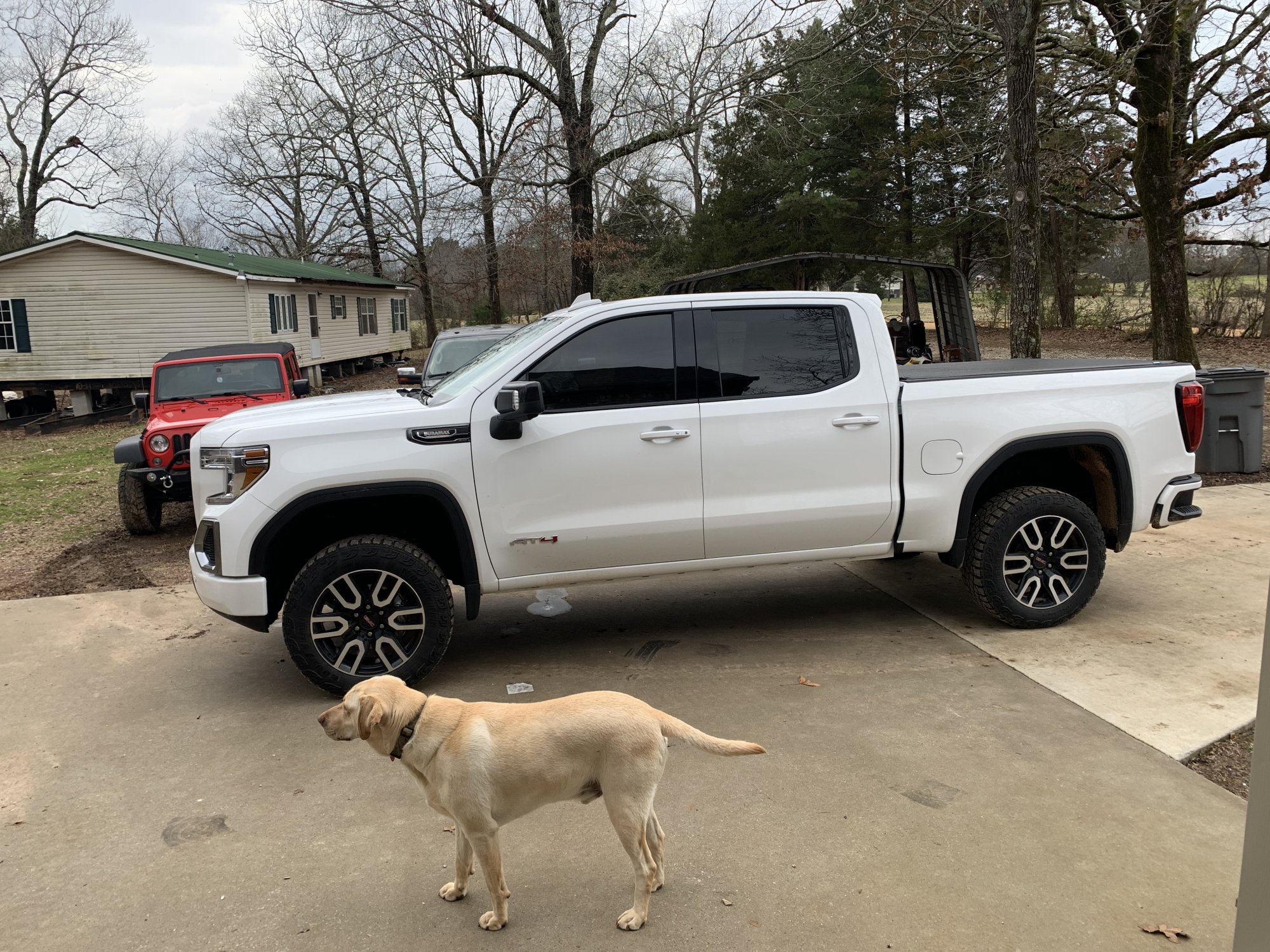

I installed the Rough Country Model 1318 2" leveling kit on my AT4 a couple days ago.  The kit raised my AT4 exactly 2" as advertised and components do what they're designed to do.  However, I'm an experienced mechanic and the install is a ROYAL PAIN in the backside.  I don't think it can be done with one person.  LONG pry bars, several floor jacks and sketchy body positioning are required to try and get the struts re-installed due to the added length.  I had to completely remove the upper control arm to get the strut re-installed and even then it was a nightmare.  Rough Country says 2 - 3 hour install time.  Yeah, right.
I'm happy with the results but I WOULD NOT OFFER to help a friend install one if asked as it is really, really nigh on impossible to get it back together.  I don't fault Rough Country as they had to work with with the room provided by GMC and their product achieves the desired and advertised results.  I'm happy with the results but I will not be installing another.  I would HIGHLY recommend the kit to my worst enemy and tell him the install is a piece of cake.
I do have an issue with the price of the kit.  Extremely expensive for what they produced.  I can't imagine it costs them more than $20 to produce the kit which is very basic and  straight forward.  It's just a top "doughnut" spacer and 4 plastic lower spacers with 4 bolts/washers/nuts.  To charge $130 for what is sold is WAY OVER the top.  I appreciate the fact that they had engineering work involved and need to recoup their development costs as well as make some money but they went WAY TOO HIGH on their pricing.  I'm a Rough Country fan based upon their offerings on "other stuff" but this one left a bad taste in my mouth specific to the cost and installation difficulties.
If I had to do it over again I'd drop it off at one of several "shady" shops I despise due to shoddy work and overcharging and have them install provided they offered to do it for a flat 3 hour labor fee as RC advertises.  They'd lose their ass on the install as it really is a SOB.
Eyeballing it makes me think I can fit either the BFG AT K02 305/70/18 which is 34.8" tall and a section width of 12.2" or the Toyo AT3 285/75/18 which is 34.8" tall and 11.3" wide.  The BFG would probably have clearance issues with the upper control arm it they were true to size.  As BFG ALWAYS exaggerates their advertised sizing by about 1" in height and width they might fit.  The narrower Toyo will have a better chance if Toyo's advertised measurements are accurate.  Anything larger will definitely have clearance issues when at full lock with the suspension heavily loaded.  Trimming fender liners and/or mud flap would not help as the problem you'll run into is with the UCA.  People saying they're fitting larger tires than I mention must be making their fitment comments with their wheels pointed straight ahead and an unloaded suspension.

Your truck looks great!
