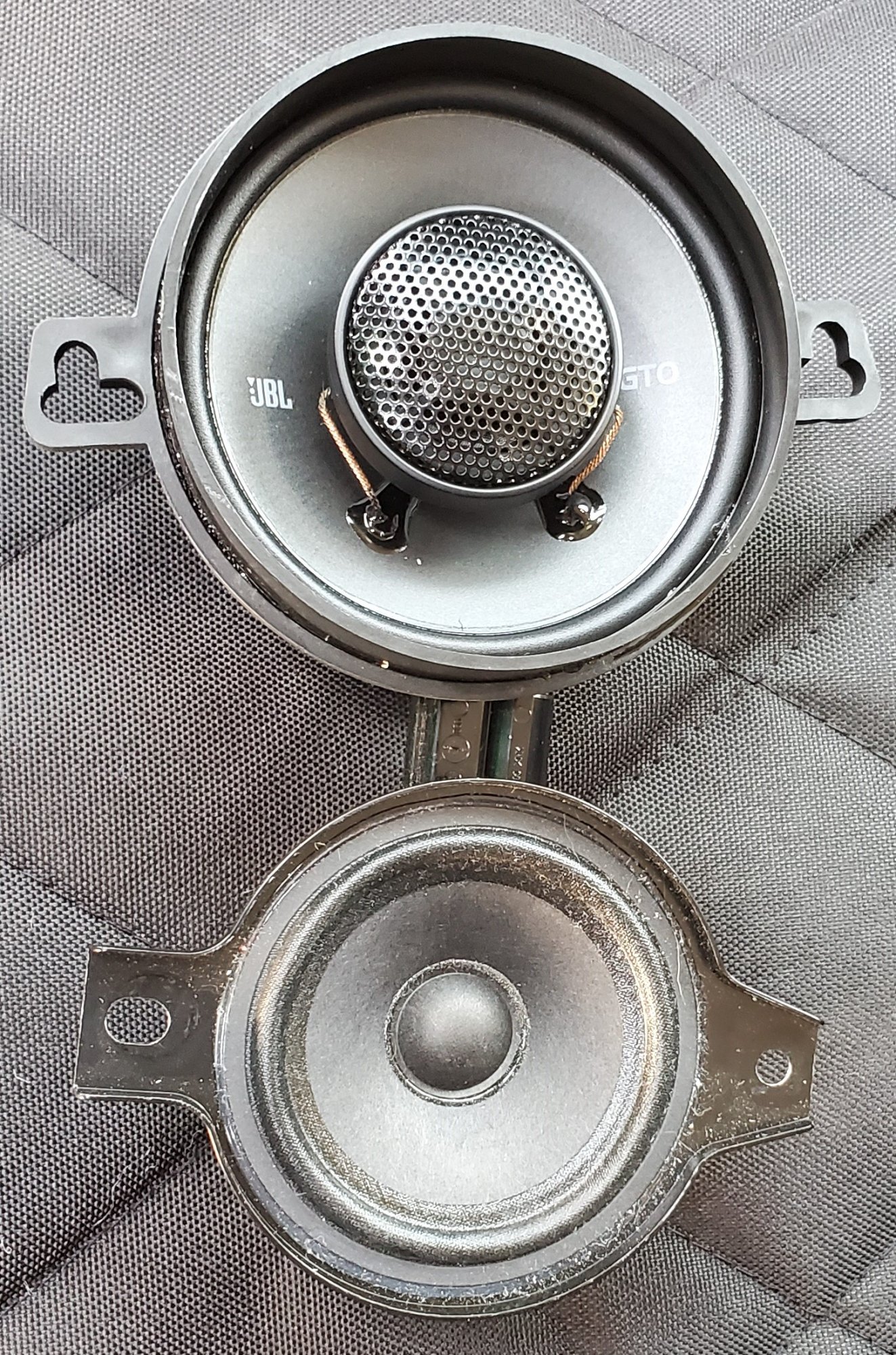

I have not yet, but I plan to soon. I still have the treble set pretty high and midrange set low when I listen. It's probably because the speakers are low in the doors and the dash speakers are really shallow and scratchy sounding.  When I put a thick magazines  over the dash speakers it allows the door speaker's midrange to be turned up and sound great, but I still want the dash speakers replaced. My concern is that they are not 3-1/2"  holes and i want to install JBL 3-1/2 inchers that have mids and highs. Anybody get 3-1/2 's in they're dash?    https://www.ebay.com/itm/JBL-GTO329-3-5-150W-GTO-SERIES-2-WAY-CAR-AUDIO-STEREO-SPEAKERS-SET/171765291947?_trkparms=aid%3D111001%26algo%3DREC.SEED%26ao%3D1%26asc%3D20160908105057%26meid%3Ddcf3c25fcbde4b2c946ce4c5a8b81f9a%26pid%3D100675%26rk%3D5%26rkt%3D15%26mehot%3Dpp%26sd%3D293612571402%26itm%3D171765291947%26pmt%3D0%26noa%3D1%26pg%3D2380057%26brand%3DJBL&_trksid=p2380057.c100675.m4236&_trkparms=pageci%3Af4ef422c-b280-11ea-a0b0-74dbd180c0ae|parentrq%3Aced1c0431720a9c42def92f6fff70fee|iid%3A1

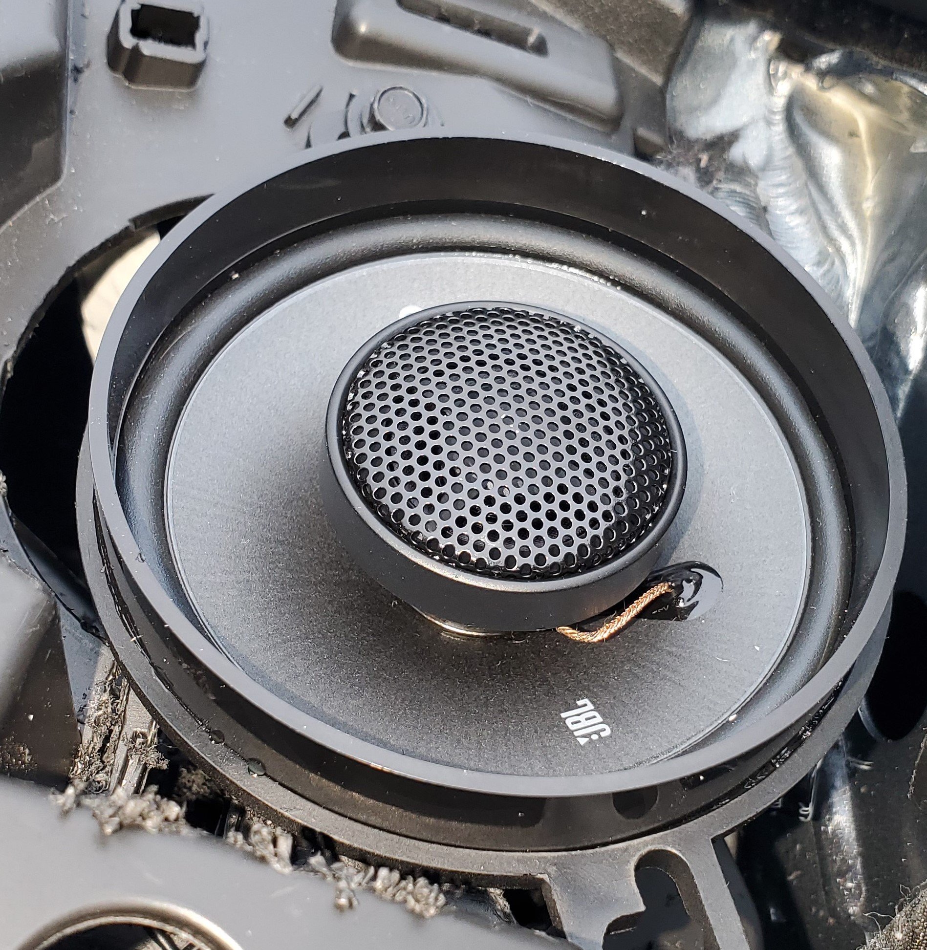

20200701_083136.thumb.jpg.1df153c15184efe120111281f65fa17b.jpgOk I put the JBL GTO 329 speakers in the dash yesterday and they sound great. The highs now come from the dash and they are crystal clear. I tested new vs old when i had just one side installed and there was no comparison in the sound quality. There was some cutting by hand with a Sawzall  blade and I had to destroy the old speakers to use their connectors on the new speaker. It's not too pretty under the speakers and grills, but they are in tight (one screw and crammed in) and all the hacking is invisible once the grills are re-installed. I will never go back to stock speakers and now I have the capability to install a powerful amplifier in the future if I so choose. You can see the size difference of the 3-1/2 vs. the 2-3/4 speaker and the vocals and highs are loud and clear from the dash. The original capacitors cut too much of the lows out so I installed the included JBL capacitors.
