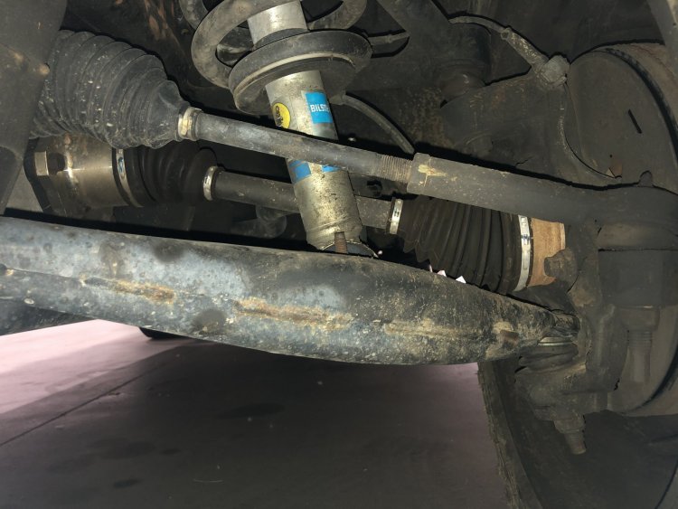

I have a level kit and Bilstein adjustable Shocks on the 1st notch up.
Are the angles ok?  See pics below. Driver side.
you have the bilsteins AND a level on? I would take the level kit off. This looks like its pushing it imo. That and, bilstein specifically states to not use leveling kits with these. Just use the notches to level. The CV's will be much happier.
Thank you.   I tried the Bilsteins up 2 more notches without the puck/spacer and it rode horrible.   Very rough ride.  Spring compressed too much.  I may put the shocks back to stock height to help the angles.

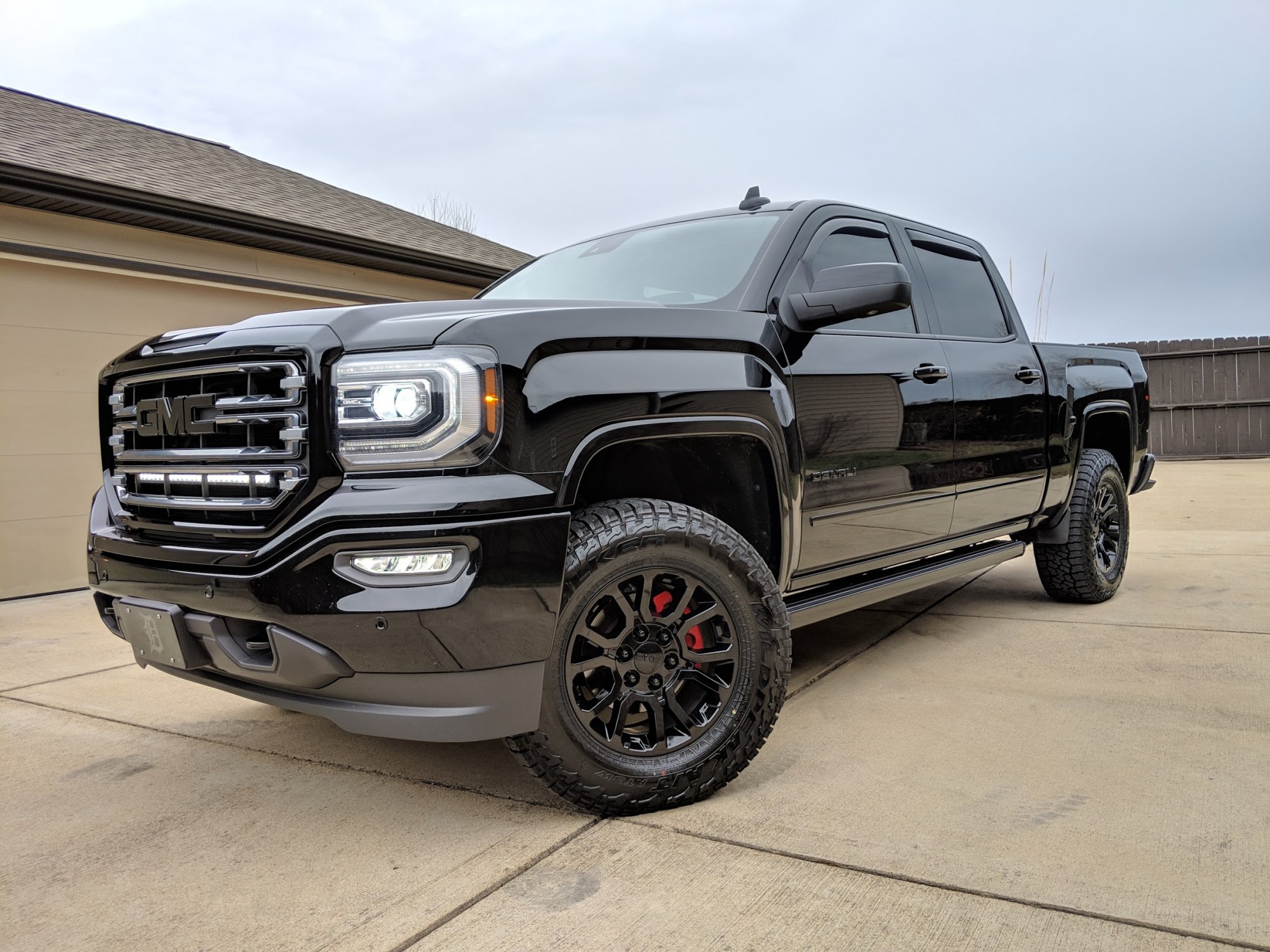

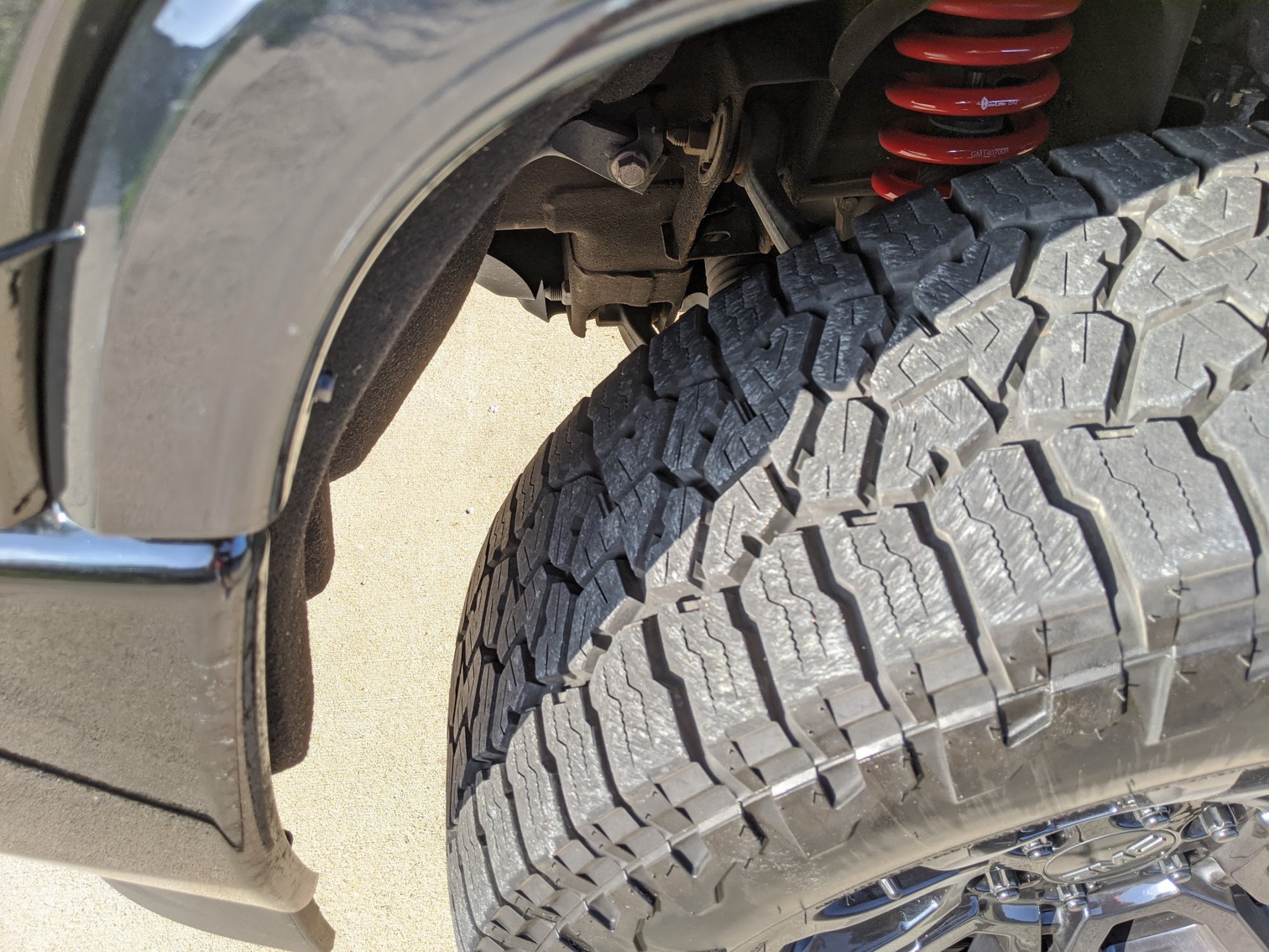

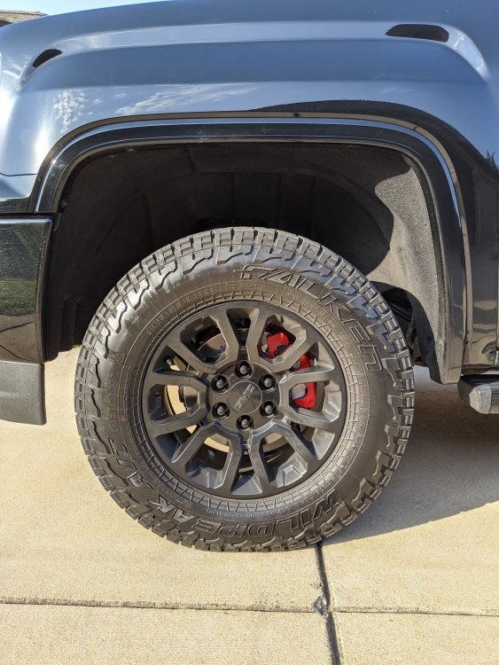

So with the Halolifts complete kit that I ordered, I did a 2.5" lift in the front and 1" lift in the rear. This leveled it out some, but it still maintains a rake. I wanted this though since I occasionally tow a trailer or haul a filled bed and can't stand seeing a truck where the back end is lower than the front (not my thing). When I bought the truck it came with 22" OEM GMC black rims and new Perelli tires, but I hated the ride because it was so stiff (low profile tire on big rim). Found a set of 18" OEM GMC rims that were powder coated black and then started my search for a new tire. The Falken Wildpeak AT3W tires were getting rave reviews so I took a chance with those. Then I installed the Halolift complete lift kit with the new wheel set up. SUPER happy with everything. It rides and sits exactly how I want it to. The Wildpeaks have held up beautifully in all conditions (ice, snow, mud, dirt/gravel trails, highway, rain, etc.) Tire size is 275/70r18 which equates to a 33" tire. I did not use a spacer, the OEM rims are mounted as normal. I attached some pics so you can see how it sits and how much room I have in the wheel well. No rubbing at all, everything clears as it should. CV angles are good too, I kept the stock ones on and figured if they go out I'll get aftermarket at that time, haven't had any issues though. Let me know if you have any other questions.

Ha, thanks. Good choice in makers mark. Black is frustrating to keep clean, but when it is it looks great. Good luck in your new set up search, post pics once you get everything installed!
