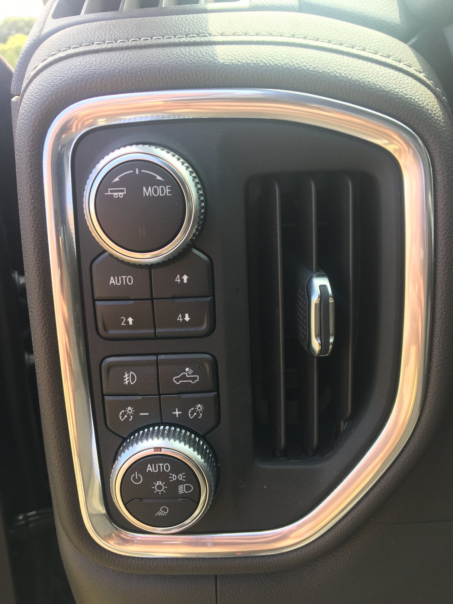

I am looking for a clean way to install a switch for the light bar as opposed to drilling a hole in my new truck and adding one that is clearly out of place.
I know that there is an "upfitter switch" that would add 5 switches but am trying to explore other options.
I also know you can replace the whole set of paddle switches but lose all of the icons telling you what the buttons are actually for.
I also saw that for older models, people could replace the headlight switch and add a single button that way.
My #1 choice would be to install a real switch where the dummy switch is that I'm pointing to.
Really hit a dead end with my research and was wondering if anyone had any better ideas.
Thanks in advance!
OR!!!! I could just tap into the fog lights. Do y'all think that one fog light wire could power a 36" LED light bar? its's advertised at 234W.

Just use the fog light to trigger a relay. The relay can switch power to the light bar.
#30 to Power
#85 to ground
#86 to fog light switched power
#87 to Light bar
