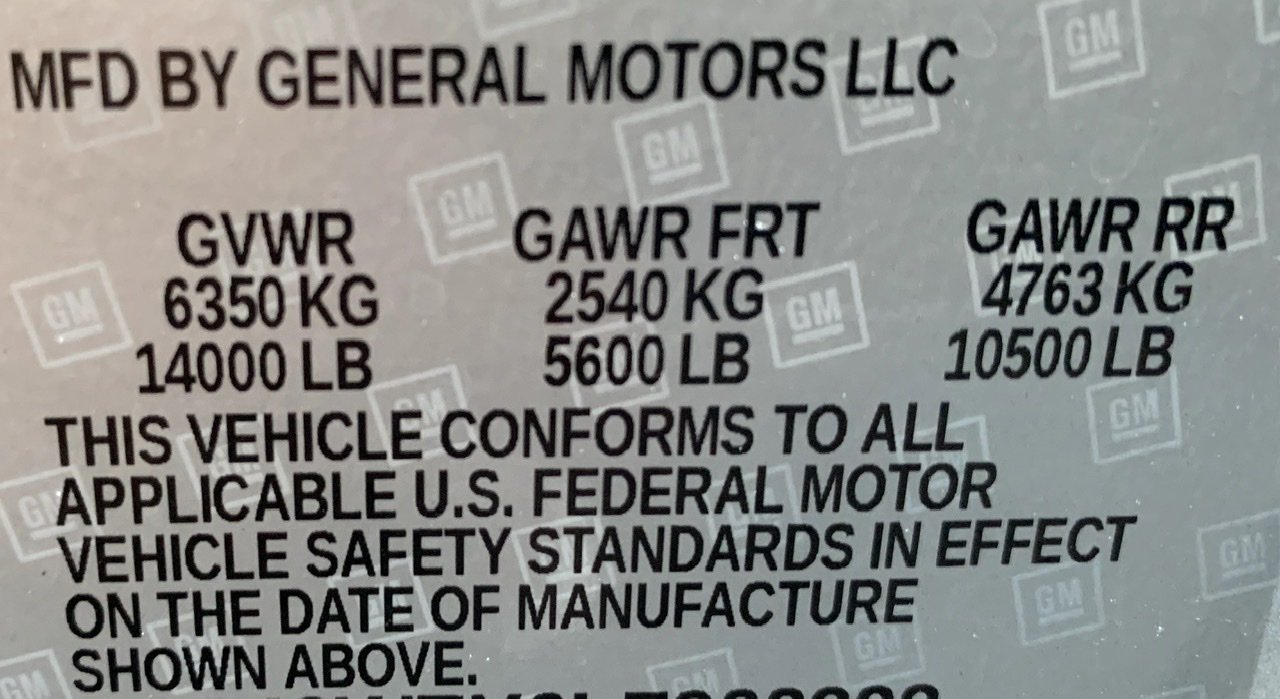

We bought a 2020 because the increased payload.  This is the limits for a GMC 3500 Denali.  Plus you get the 360 when you go Denali - 6.6L 10 speed Allison - also has auto engine braking!
