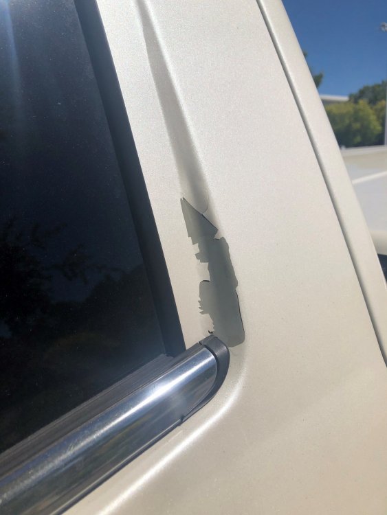

1 minute ago, EmmDee said:
This is how my 2015 looks. Exact same spot. Anyone know if GM will now fix the problem with their malfunction.

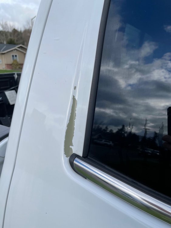

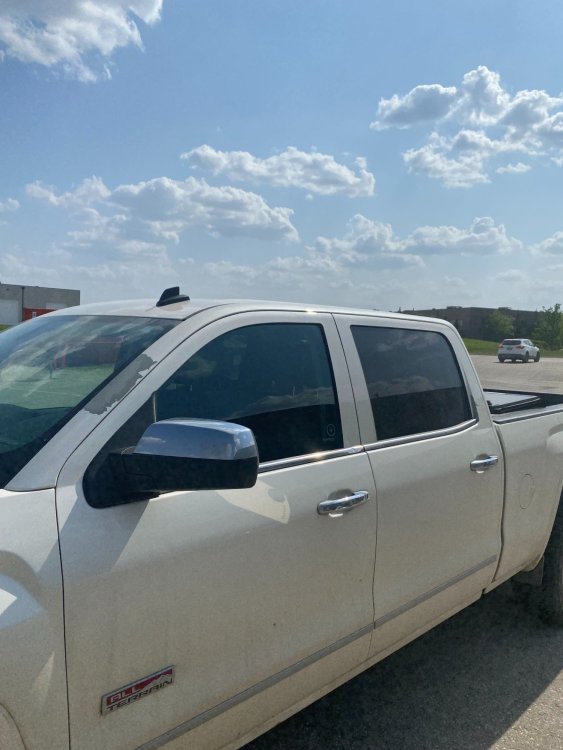

I have a 2014 Sierra with the Tri-Colour White and it started on my rear passenger door. I thought it was rock chips since I didn't have splash guards so whatever I found a shop that would paint that door for $400 CAD. Now my drivers side door (same as everyone else) and my drivers door post is now flaked probably 45-50%.. How can GM turn a blind eye to this??

My paint is also delaminating at my back driver side rear door . I just got a estimate from Hedrick Chevrolet for 2581.00 to replace trim and repaint GM initially told me they would take care of it if the dealer ship diagnosed it as a factory issue and then said they might pay for a some of it know I have not heard back after getting the estimate.
