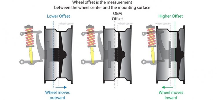

2020 Denali 2500. Installing a 3" suspension lift. They suggest an offset anywhere from
0 to +20
I want the wheels to just slightly be out past the fenders. Wouldn't I need a negative offset for this? Was thinking maybe a -6?
Any help or suggestions is appreciated. Want to be sure I get this right. Thanks
Sent from my SM-A705U using Tapatalk
I have +18 on 18x9 wheels and the tires sit just proud of the fenders roughly 1/2-1".
Ideally id like to go to a +6 or so to be a tad more aggressive.

I would be interested in what you find out as well, doozer. Most post and suggestions I have seen have said stick with a 0 to 18 offset on these trucks even with a leveling kit.

I ended up going with a -19 just waiting to get me 3" lift on now. Cant wait

Have you guys used this website? Good for calculating the numbers and getting a very rough look at the difference in tire/wheel position versus stock!
This link is my comparison of the stock wheel/tire and the new set I'm looking at 22x10 -18 and 35x12.50r22
https://www.willtheyfit.com/index.php?width=275&aspect=65&diameter=20&wheelwidth=8.5&offset=47&width2=318&aspect2=52&wheel_size=22&wheel_width=10&offset2=-18
