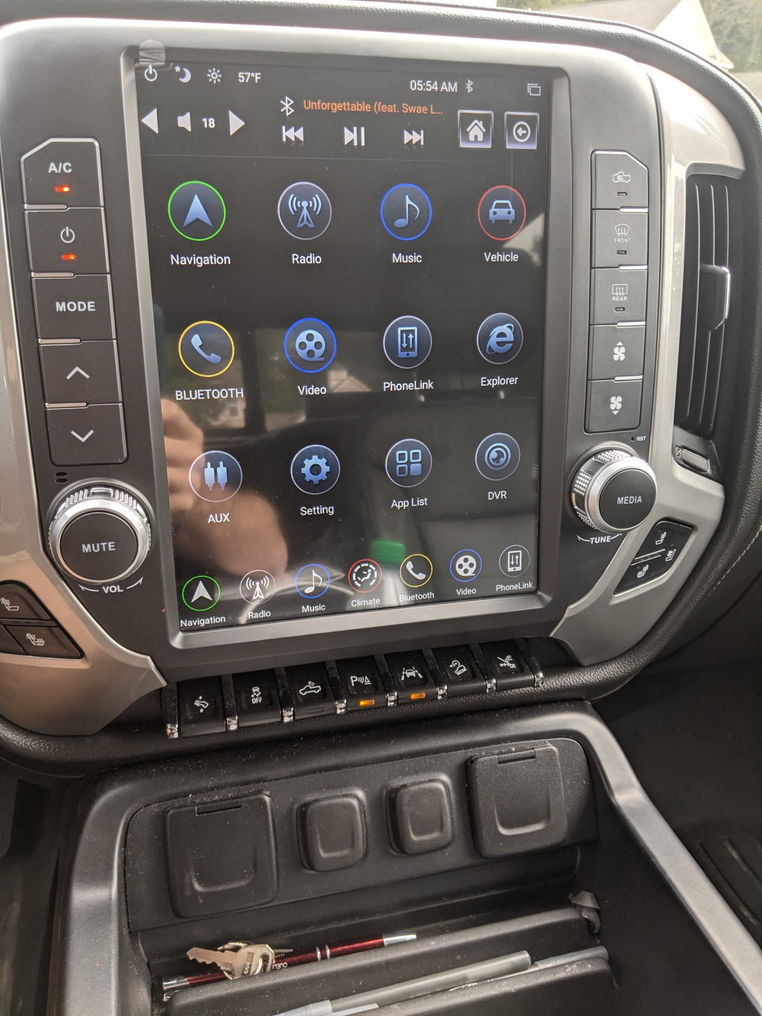

Just picked up the Linkswell Gen 4 and had it installed by my local audio shop in my 2017 Denali. First impressions:
  • Basically an android tablet, that can run applications such as maps, waze, netflix, etc independently of my phone
  • While the audio shop has advised that they have installed the bose module, it feels like the active noise cancelation is not working
  • Call clarity is good, but it doesn't use the factory mic, so your stuck looking at an aftermarket mic above your rear view mirror
  • Android auto is not full screen. Literally the same size as on the factory unit due
  • Over all fit looks amazing, but the bezel color is a brushed silver which doesn't match the steering wheel or side vents
  • Climate does not have an auto fan speed. (in the instructions it shows that it does, wondering if something was installed wrong)
Overall it is a massive upgrade over stock, but really wondering if I should have went with something different from an established brand (ie alpine, pioneer, etc.)

Follow up on this after a few months of use:
  • The audio shop was able to connect the bose active noise canceling
  • My google pixle 3 xl will not connect wirelessly

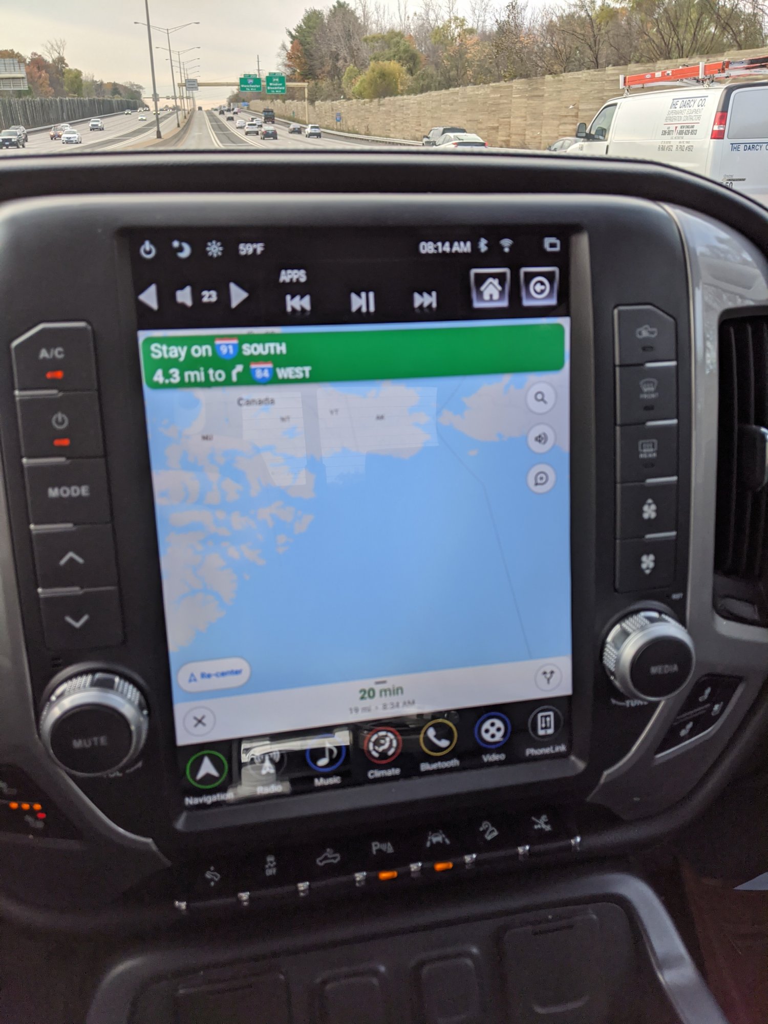

  • Navigation on the headunit always thinks I am in a foreign country, or in the middle of the ocean (this doesn't happen when using android auto through the usb connection)
  • tossing netflix on or youtube while running nav off of android auto works well.
The manufacturer advised that they are working on software updates, and if I had an iphone it would work wirelessly. Hope this helps anyone in the market for a linkswell.

  2. The maps issue is something i had as well, and i still have it. I think the issue is with the screen resolution. You should be able to open a second app and do split screen with them. If you do this, Maps will work correctly.

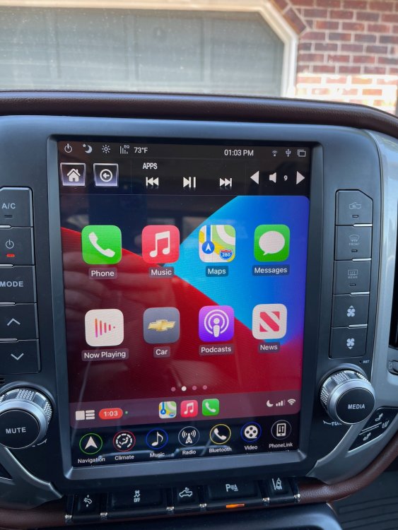

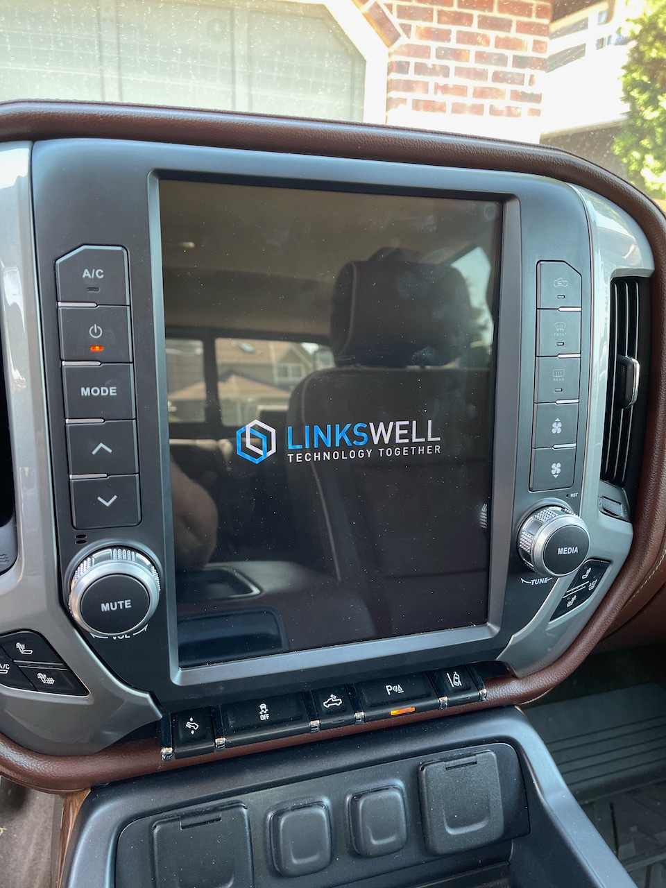

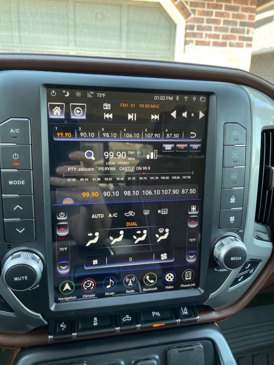

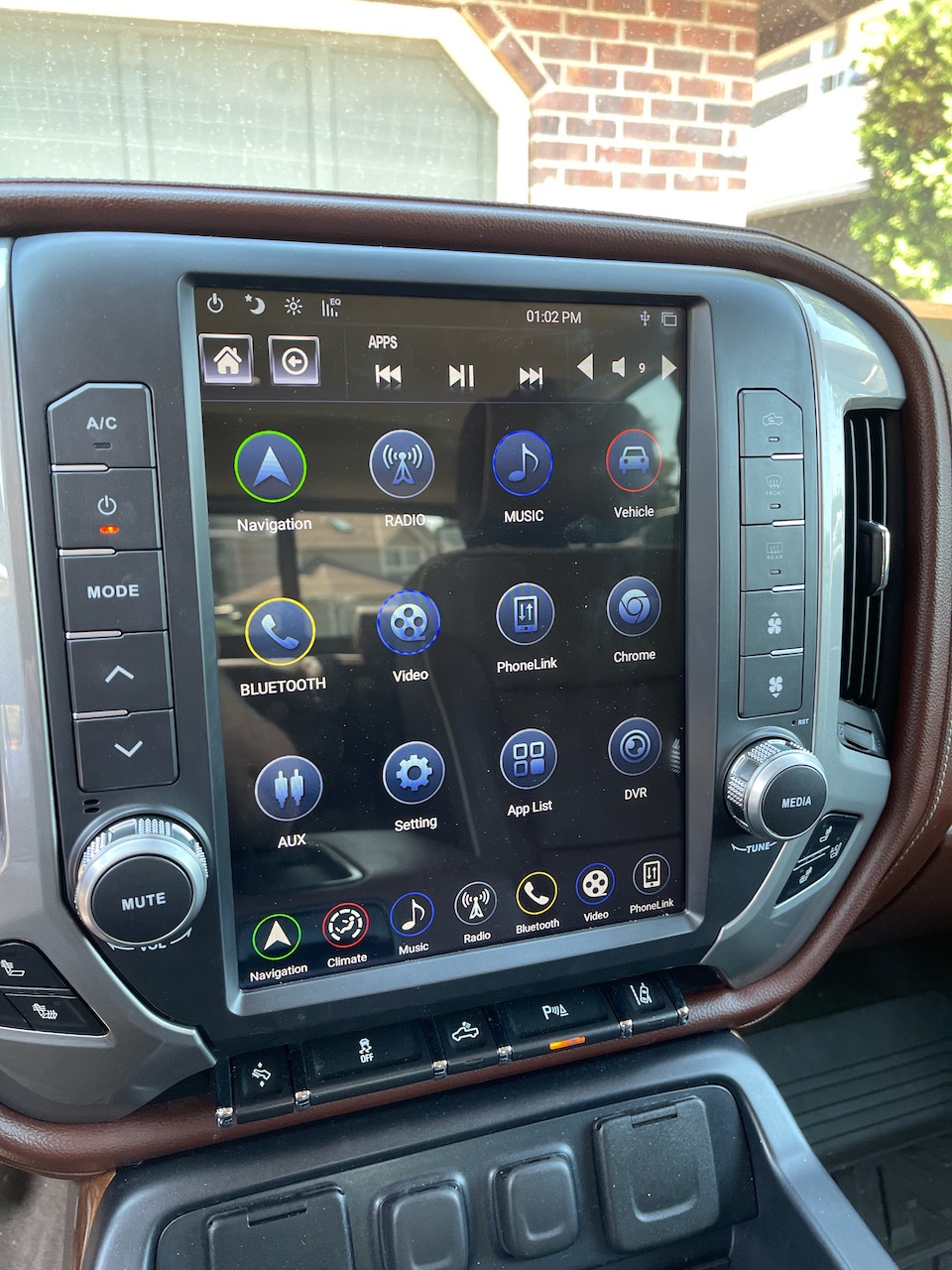

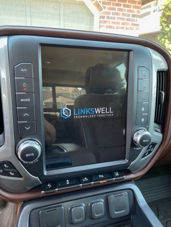

Reviving an old topic for a specific purpose.  I would have liked to had a little more information when I purchased this at the end of July.  If it is the Linkswell T-Style radio, yes, many places sell these units.  I bought mine locally in WA and had it installed, @CheezyDeezy like you I spent a few months looking at this, and watching the various videos on-line.  My reasons for upgrading, I do not like the GM Nav, I have the 8" touchscreen, and I wanted the Apple Car Play, I don't have an Android phone.
I bought this in July and it is the beginning of November and I am planning on removing this, I simply do not like it.  I used to be into android and modifying/customizing but I am just not into it anymore, nor do I have need for Video in Motion, the ability to watch YouTube, etc...etc...etc....most of the capabilities that make this thing cool are things that I do not or will never use.  Items that irritate the crap outta me, If you have an iPhone and you plug it in, the CarLink picks it up just fine however, when you answer a phone call, CarPlay and bluetooth both pickup, seems it isn't smart enough to not answer from bluetooth when the phone is plugged in.  Apparently this is only an issue for Apple and not Android phones.  Because of this there are times when there is a few seconds delay in speech, either going or coming, like watching the news guys wait 7 seconds for the delay to hit them.  Second, if you have sunglasses on, forget anything but looking at it head on, PITA when you are trying to drive and look at anything on the screen.  Brightness at night, in the city, not really an issue but if you drive in rural areas where there are no other cars and no streetlights it is an absolute eye killer, you can't dim it or rather it doesn't dim but it is pretty easy to just shut the screen down, but again, PITA.  Lastly, for me, it would be nice that when you start the truck, other than waiting for an eternity for the thing to start, it would be nice if how I arranged the screen previously, if it would still be there.  I don't want to have to hop into  my truck and spend 5 minutes waiting for it to start up, then arranging the screens so I can see Nav and Radio at the same time.  Apparently there are ways you can do it, assuming you can set it up and then hit a shortcut or something but see statement 1, I don't have the desire anymore to customize.  I like to be able to open car play and see Nav, Music and phone all on one screen by just pushing the existing layout......simple easy.  It is a nice unit though.  Bought the BOSE adapter for it which is specific to this radio, it retains all the factory stuff so no need to rewire or bypass the amp/sub, and it sounds pretty good without any other modifications.  Maintains the steering wheel controls.  Only thing you really loose other then XM if you have it is the integration into the 4" Display in the instrument cluster, so no more Navigation prompts or anything you use to get from the Radio.  It has tons of stuff you can do with it, I added the DVR camera which works well and a third brake light camera, has some pretty cool stuff.  Anyway, just wanted to put this here in case anyone was looking for one and wanted some more information.  I will be selling all of the pieces of mine, Radio, Bose adapter, DVR camera, Third brake light camera and USB hub that I had them put in once I take it out in the next week or two.

I did end up selling the Linkswell and then I went ahead and purchased the Apple Carplay upgrade from WAMS, so both the HMI and Radio with maps update, I also just bit the bullet and bought the 2016 blue Denali Gauge Cluster.  It took me less than an hour to put all three in last night and I should have went this route to begin with.  The 2016 Maps and interface including the CarPlay is just that extra little bit better to give me what I was looking for.  Everything carried over well so far as I can tell, the Maps, traffic and weather XM Subscription seems to also be there.  I really have disliked the GM navigation which is why I wanted the Carplay, but it might just be ok now, shall see on how easy it is to use.
