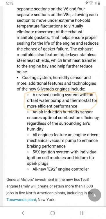

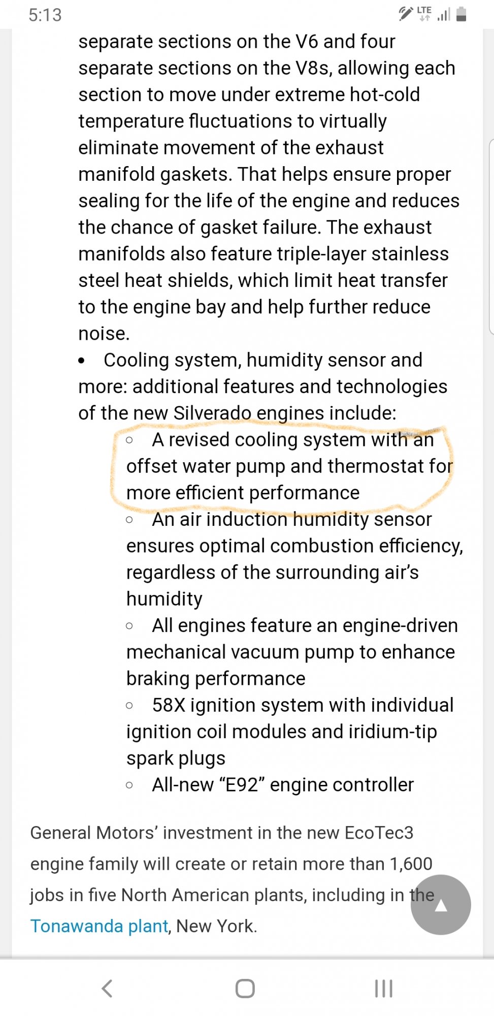

https://gmauthority.com/blog/gm/gm-engines/l83/amp/
Based off some reading, seemingly the L83 has "a revised cooling system with an offset water pump and thermostat for more efficient performance".
Personally, I find it odd that curb + minimal weight with spirited acceleration is showing a quick 10+ rise in ECT.
Edited by 14burrito
