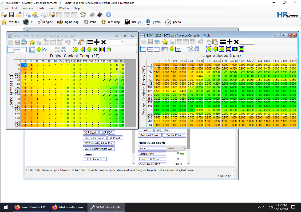

It looks like based on this ECT spark table that spark is unaffected between 176* and 212*,...

The 6.2's sure have a different ECT base table than the 5.3's for whatever reason. If that is indeed a stock setting within your tune.
Here's a 5.3 file and the Multiplier table that can adjust timing based on temp too.
Can you show the tables for the LV3?

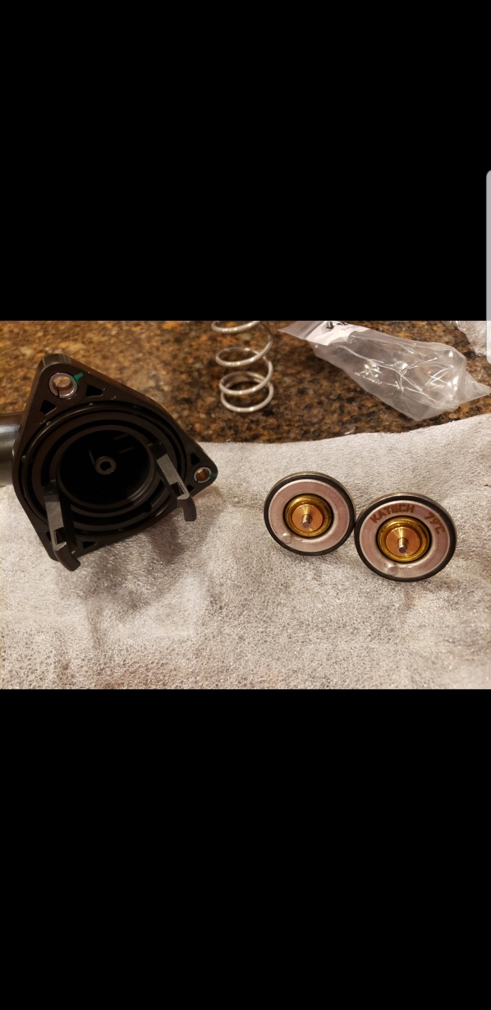

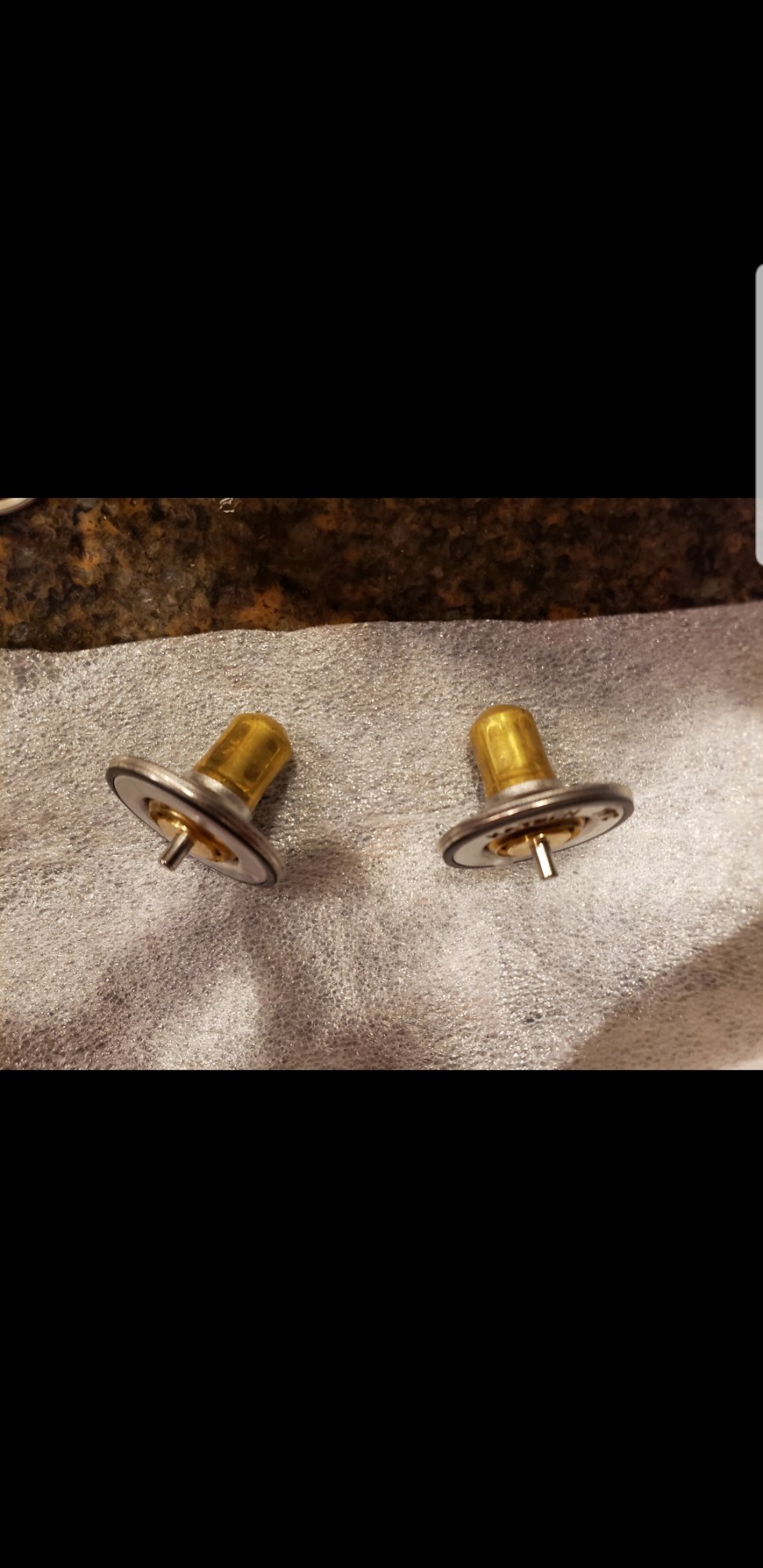

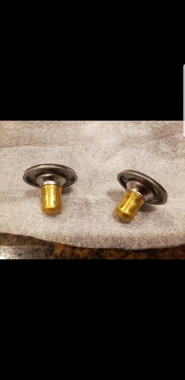

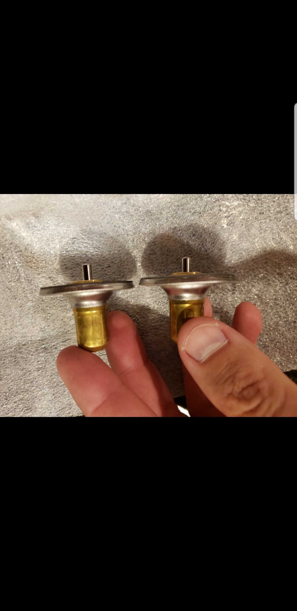

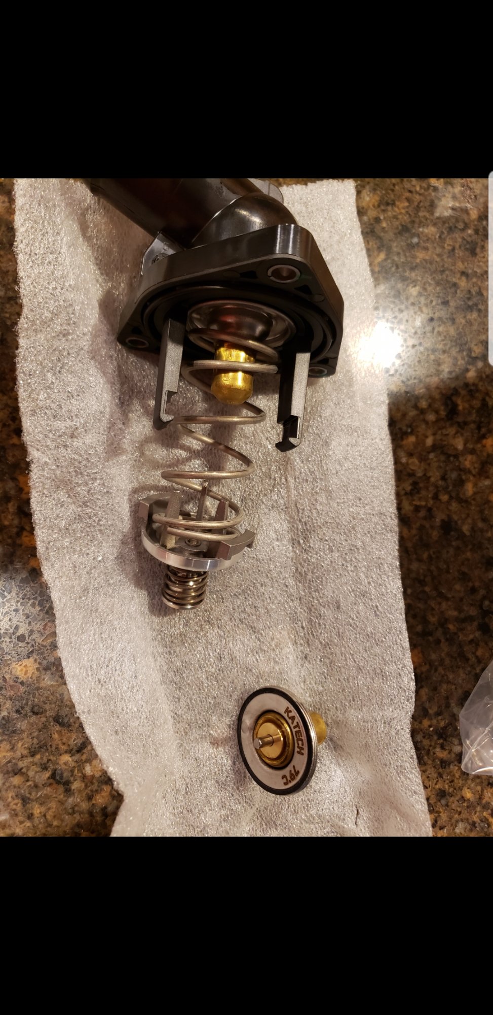

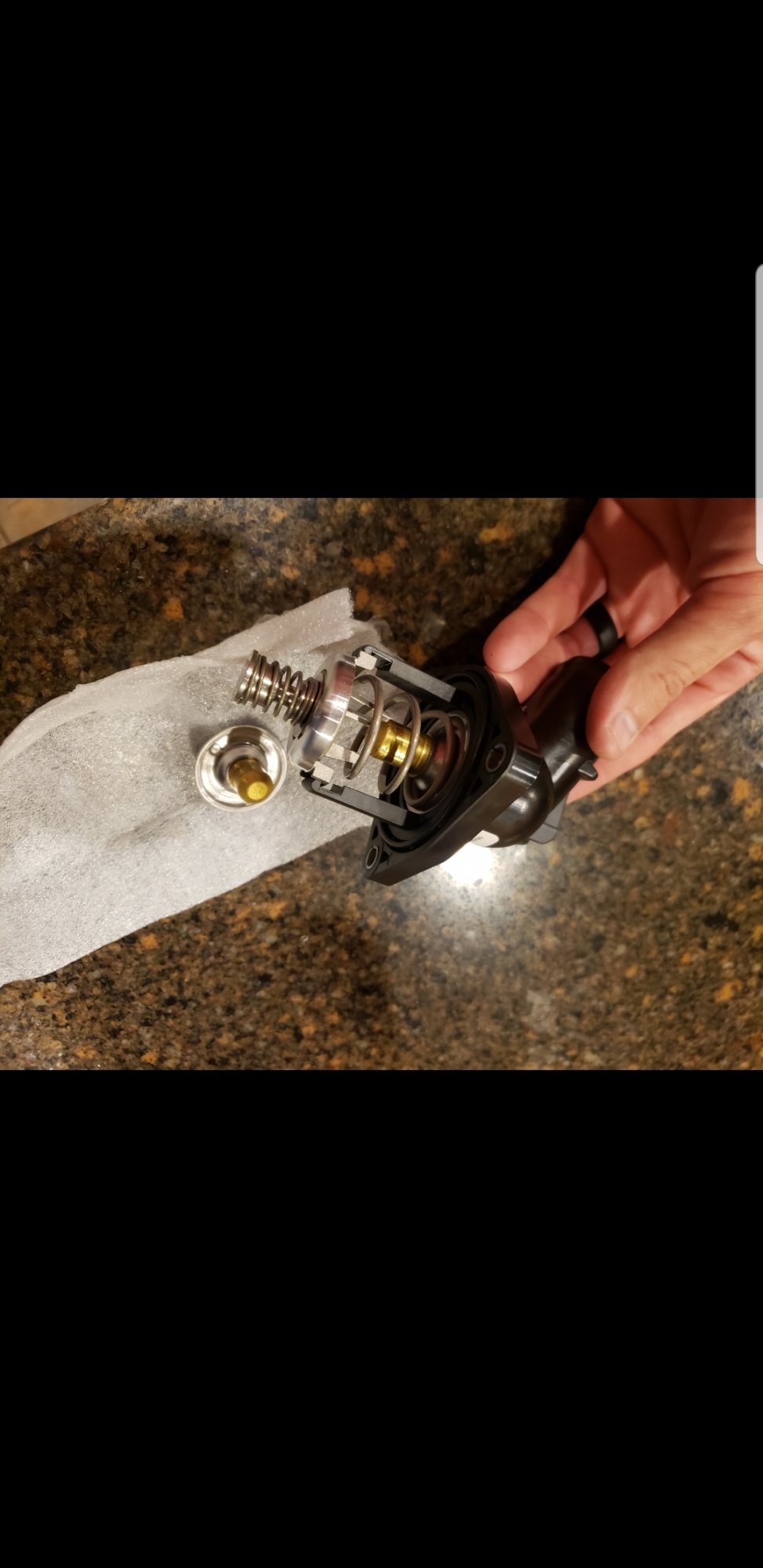

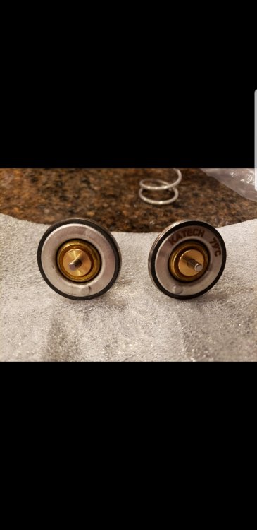

Lengthy follow-up for anyone who cares or doesn't and are just bored lol
https://store.katechengines.com/174-degree-gen-5-lt-thermostat-p729.aspx
Important to note: HVAC off during all the measurements listed below.
OE T-stat - 201F start to open, 232F full open (per GM directly)
45mph, steady state, 213-216F ECT, 79F amb
65mph, steady state, 213-216F ECT, 75F amb
53/54mph, steady state, 213F ECT, 107F amb
65mph, steady state, 216F ECT, 107-109F amb
OE t-stat with amb temp 86-88F, ECT rose up to 228F during WOT or with steady state and lower gears/elevated RPMs
Katech 174-181.2F (174F with a tolerance of +7.2 / -0)
45mph, steady state, 181-183F ECT, 64F amb
55mph, steady state, 183F ECT, 64F amb
65mph, steady state, 185-187F ECT, 64F amb
75mph, steady state, 190-194F amb, 64F amb
WOT up to 65/70 ECT peaked 196F with amb temp 64F
45mph, steady state, 187F ECT, 102F amb
66mph, steady state, 198F ECT, 102F amb
70mph, steady state, 199F ECT, 102F amb
75mph, steady state, 203F ECT, 102F amb
WOT up to 75mph, 215F ECT, 102F amb
Question:
After looking at those values, one might ask themselves...with a 174F (+7.2F) t-stat, why are we not seeing lower ECTs? (more so with the warm amb temps)
Answer:
Active grill shutter strategy (just my opinion based off below)
I placed my go-pro on the front bumper and was monitoring the status of the active grill shutters during my drive. Grill shutters are open with vehicle speed 0mph. When accelerating, they would start to close high 20s and be closed about 30mph. When slowing, they would remain closed pretty much until stopped. Obviously, if there is no airflow…no heat exchanged. I have not had much opportunity to mess with measurements and grill shutter status with HVAC on. Wife’s vehicle, our 2nd due in about 2 weeks and coming into winter…not really a priority at the moment. During winter months I am fine with the OE grill shutter strategy, it will help retain heat for heating the passenger compartment. I will revisit the grill shutters in the spring and see what I can figure out going into summer. FWIW, talked with Lew and was hoping he could alter the shutter table (keep OE strategy in Drive and have them open with Tow/Haul engaged…there is no table for him to alter :().
So for now, that's that from my side. :cheers:
