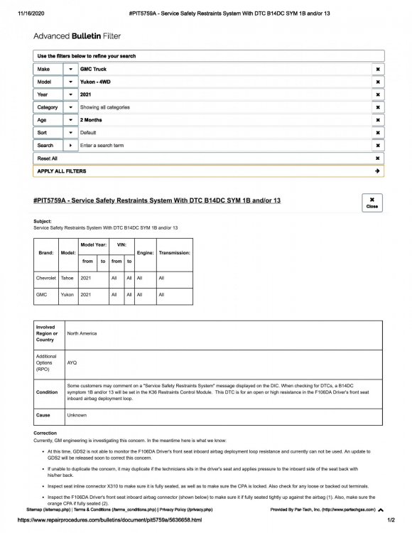

Let's try this again....it is Monday.  Here is more info to take to your dealer.  The RPO (AYQ) are the standard airbags.
#PIT5759A - Service Safety Restraints System With DTC B14DC SYM 1B and_or 13_2.jpg
#PIT5759A - Service Safety Restraints System With DTC B14DC SYM 1B and_or 13_1.jpg
PIT5759A is outdated, it has been modified, 9 times and counting and is now on version PIT5759H
Version
9
Modified
07/23/2020 - Created on.
07/29/2020 - Updated correction sections to add note and torque spec
08/03/2020 - Updated to add the taping information in the Correction and edit labor op description and time.
08/18/2020 - Updated the taping procedure in the correction.
09/11/2020 - Updated the Model list, Correction and admin details
09/30/2020 - Updated the Cause, Correction, Parts and Warranty section
10/19/2020 - Updated the Models and Warranty sections.
10/22/2020 - Updated the Correction Sections
10/27/2020 - Updated the Correction, Parts and Warranty Sections to remove the WPC p/n and add the CCA parts information.
Edited by SILVER SLED

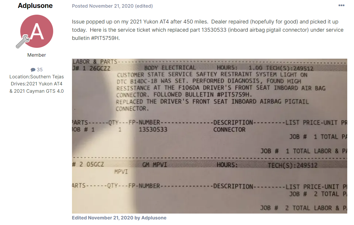

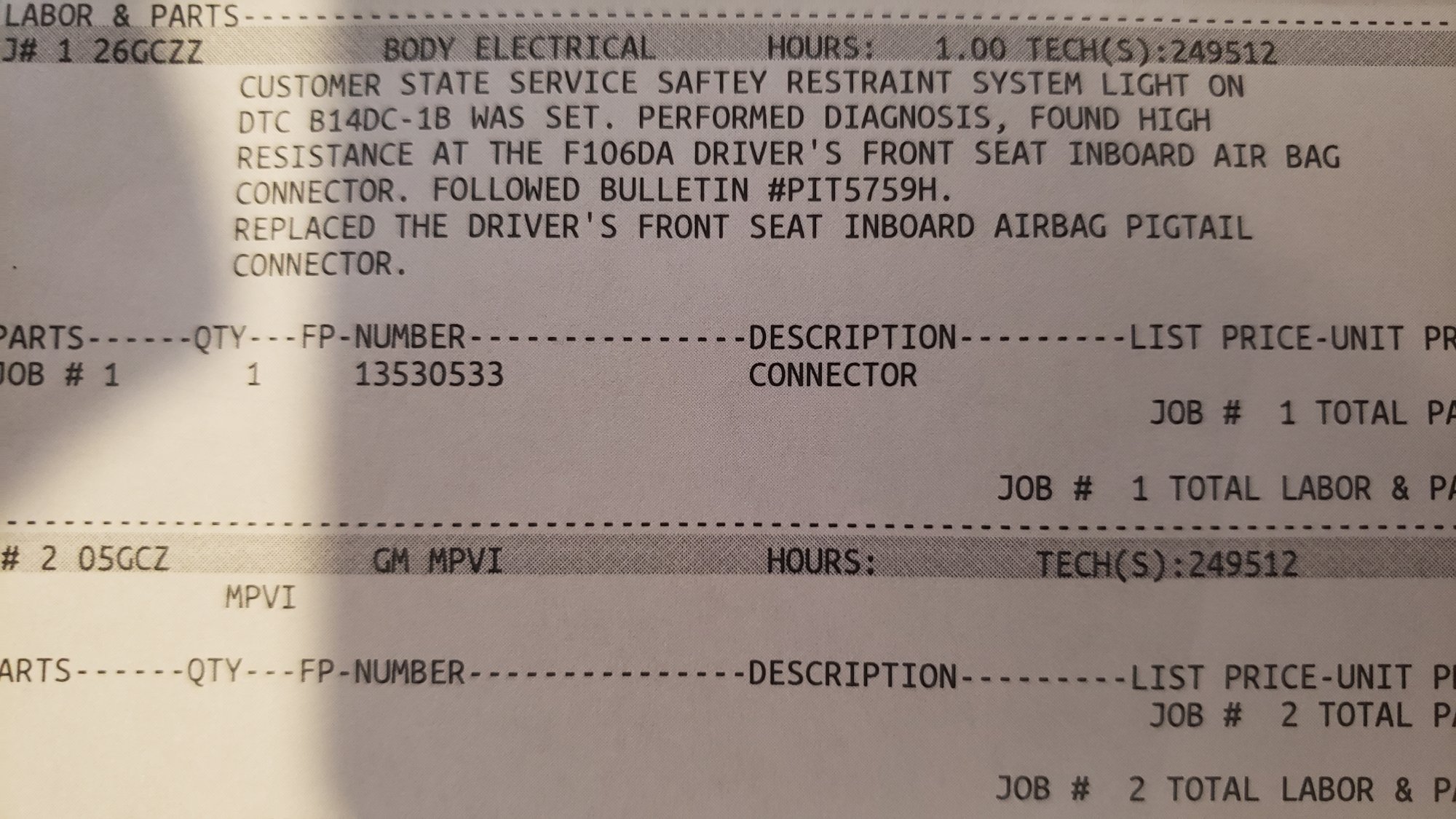

Issue popped up on my 2021 Yukon AT4 after 450 miles.  Dealer repaired (hopefully for good) and picked it up today.  Here is the service ticket which replaced part 13530533 (inboard airbag pigtail connector) under service bulletin #PIT5759H.
