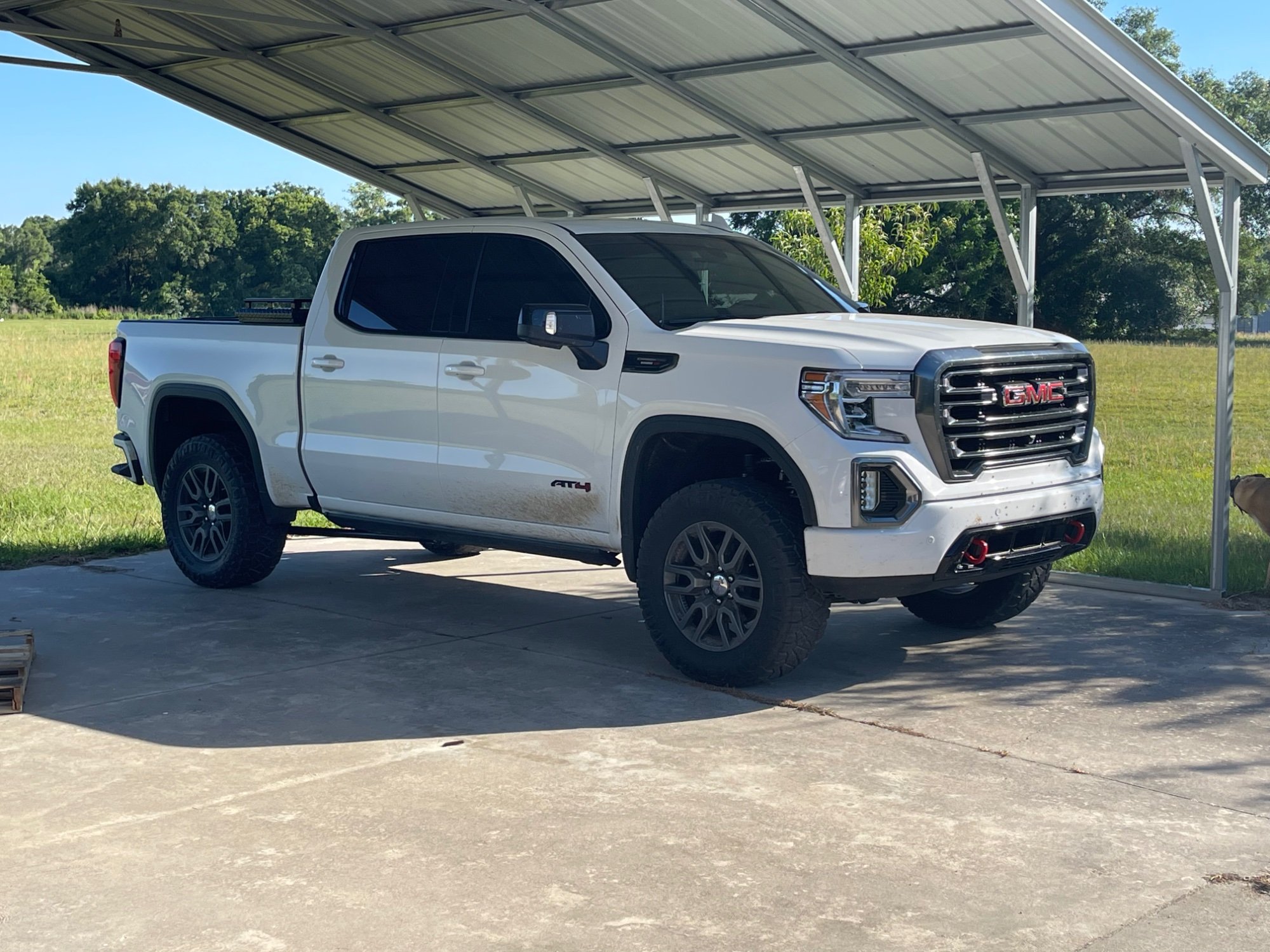

In case anyone was wondering.. I’ve got a 21 AT4 with the installed 2.5” BDS Coilover lift. I was able to fit 35/12.5 on my stock 20” Carbonpro wheels. The only spot they rubbed was that one triangular piece of plastic that sticks out into the wheel well from the bumper skirt. I just trimmed it off, and I have no rubbing issues anymore. I also had the Recoil Traction Bars installed because I live on a pretty rough dirt road, and I love them! First picture is with the track bars. Second is just the lift installed.

Wyatt, with the E rated tire and the shocks how much stiffer is the ride?  I dont want to hit railroad tracks and be bouncing sideways.
Did you have to run spacers on your stock wheels? If so which ones and how do you feel about them? I want to keep my stock wheels. I have 33” on there now and will eventually move up to 35s. I want to get this setup. Thanks
