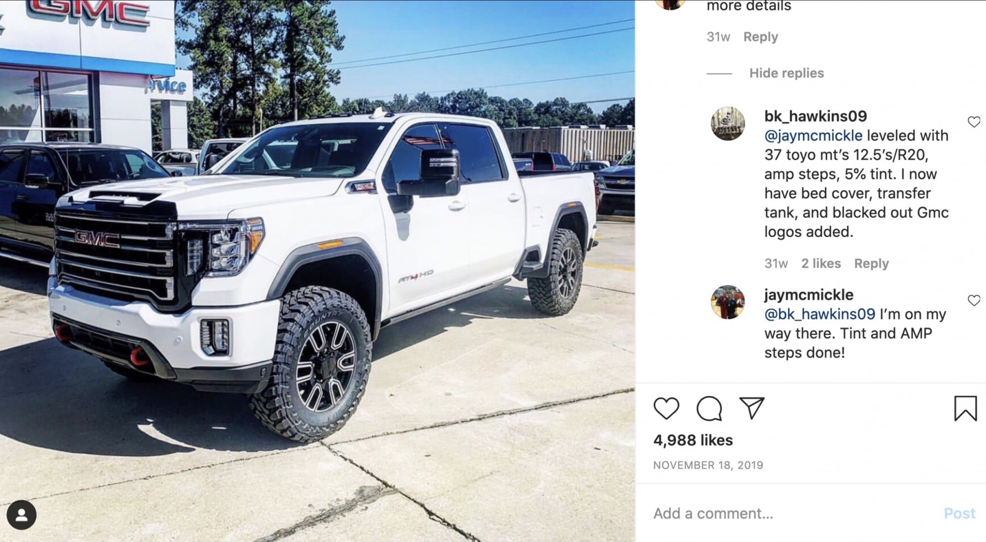

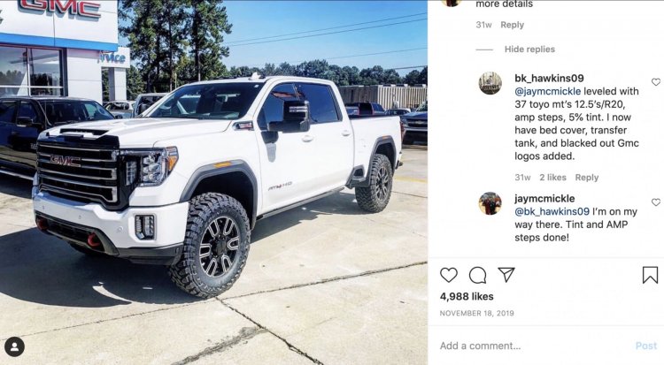

This guy only has a leveling kit and 37's... I've actually seen several GMC's leveled with 37's on Instagram and YouTube.
Also, Cognito's website says their 4" kit will accommodate 37's on a 9" wide wheel with a 0 offset.
I'll be running pretty much this same setup on my truck as soon as Fox gets their sh*t together and starts producing/shipping the reservoir shocks

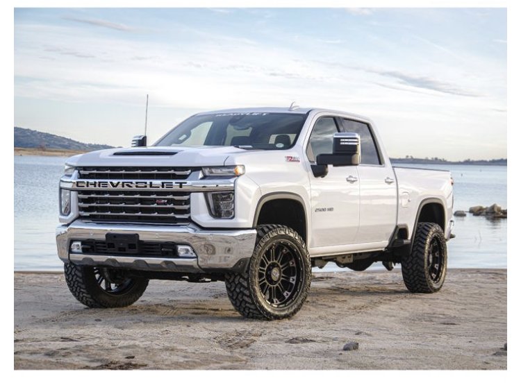

Yes I do agree with that. What kit are you going with? I like the truck in the readylift page. Looks really good
Yeah I saw the YouTube video on that truck. It looks real good
