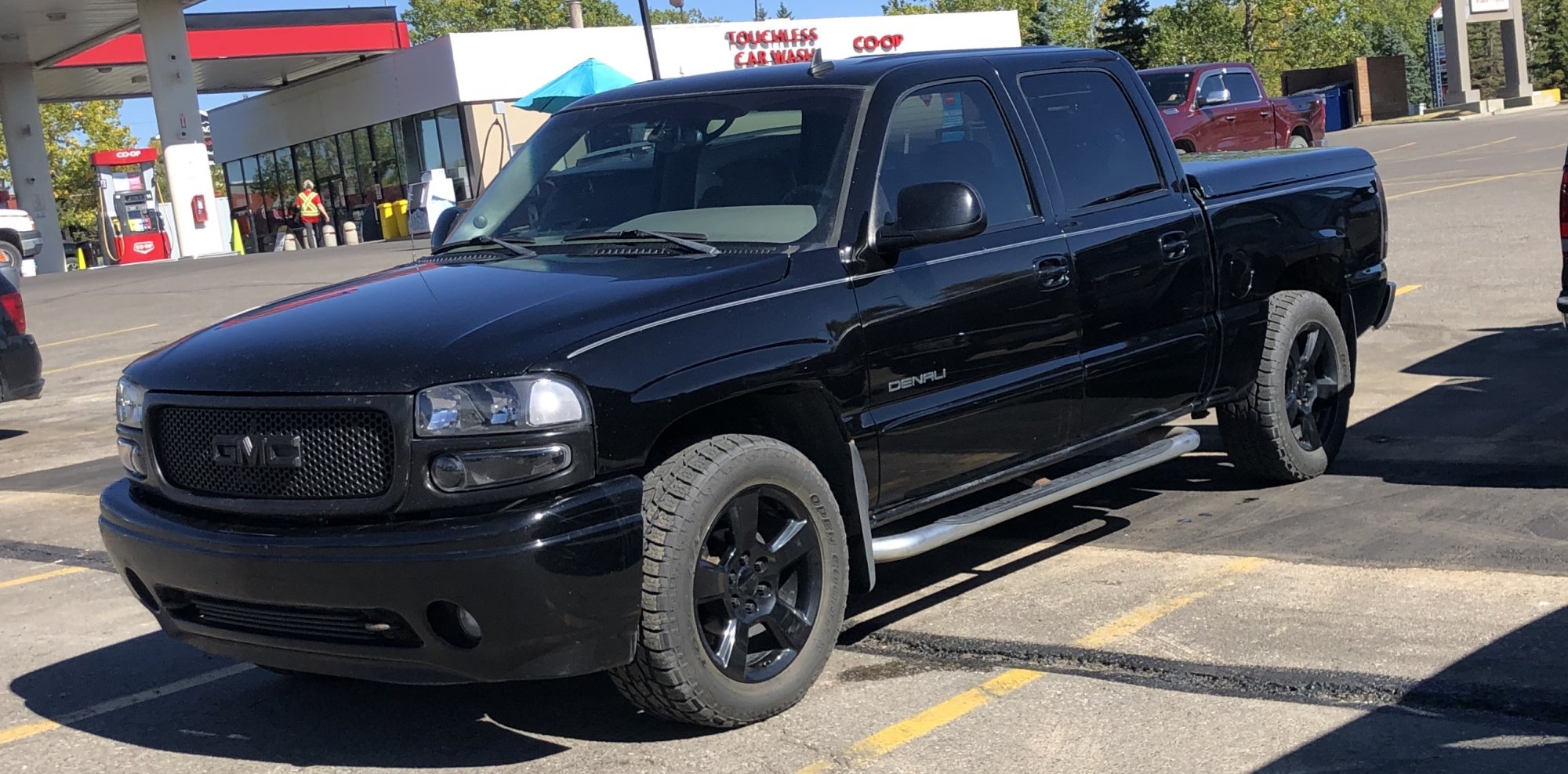

Any thoughts?  Attached a pic to show her off.....
