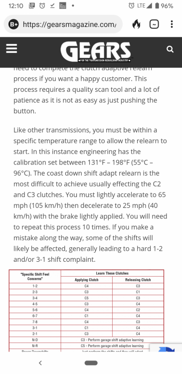

Do you remember if when you did this relearn procedure if your tranny would have been up to 131deg f, as seen in attached screenshot?
Supposably it won't start into a learn type mode until it's up to this engineer set temperature...
Yes it was higher than that
Sent from my SM-N986U using Tapatalk
Ok cool, thanks for the reply.
So when you did this relearn procedure
You just drive in manual 5th gear and maintain the rpms shown for 5 miles and then switch back to "D" and that's it?
