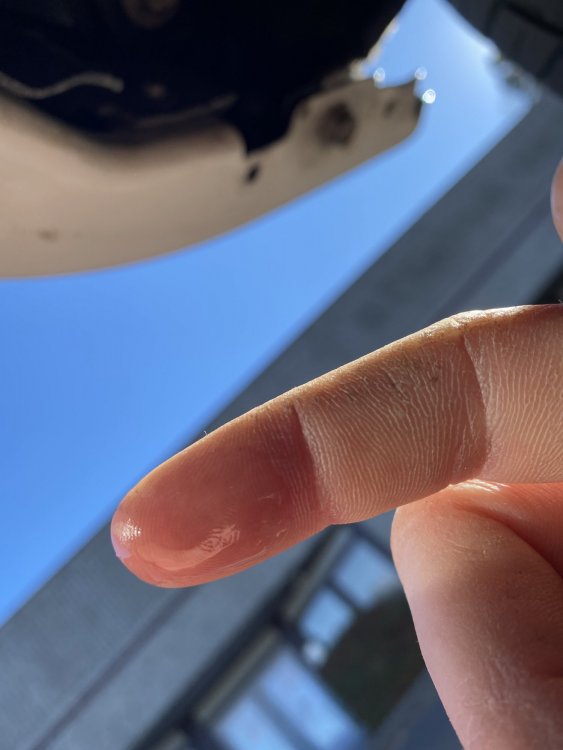

Can you post a pic of where it's leaking down from?
Sent from my SM-N986U using Tapatalk
It smells like some kind of oil. Leaking down on part of the frame behind the fog light below the condenser/radiator.
