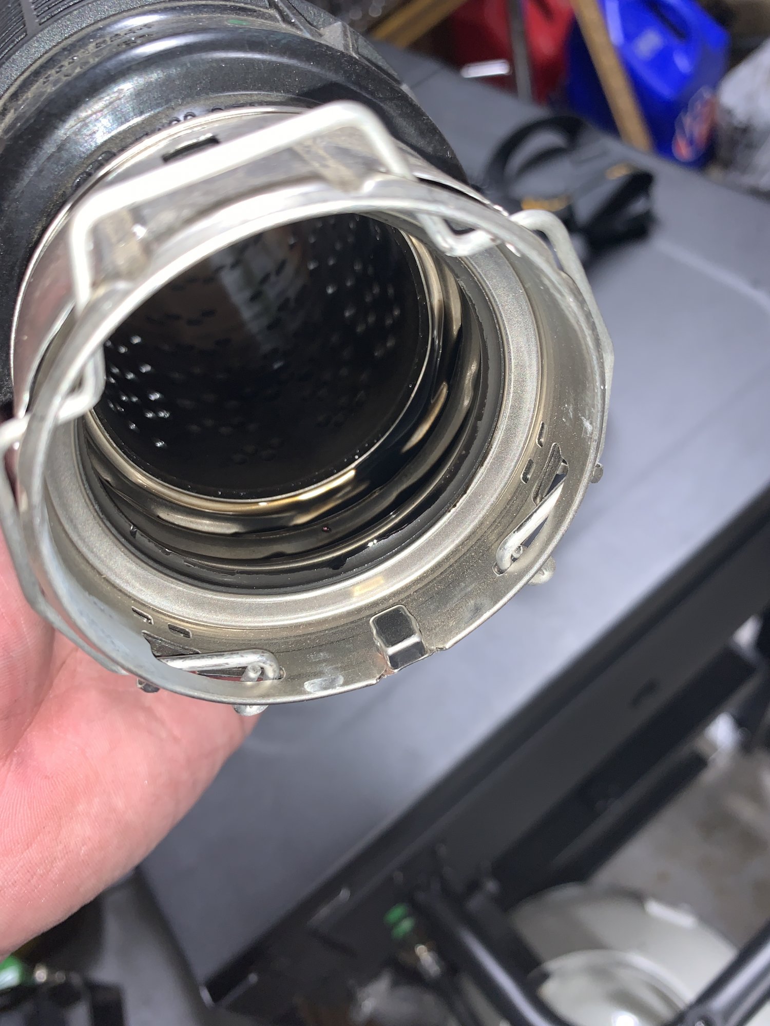

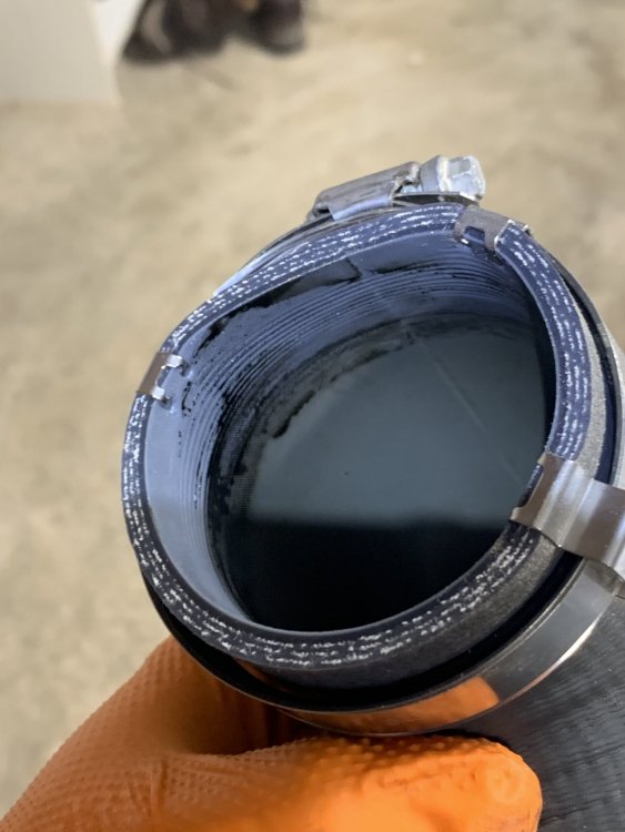

So, I first did the DIY turbo resonator delete while I waited on my backordered S&B intake to ship.  Not a noticeable difference on any level, but more peace of mind that the air path was now round and smooth for optimal performance.  This was done at 15k miles and there was already a decent amount of oil in the hoses and resonator.  Not sure if you can tell in the pictures.  But, nothing that can be done about that (though I was hoping I could put a catch can on it).

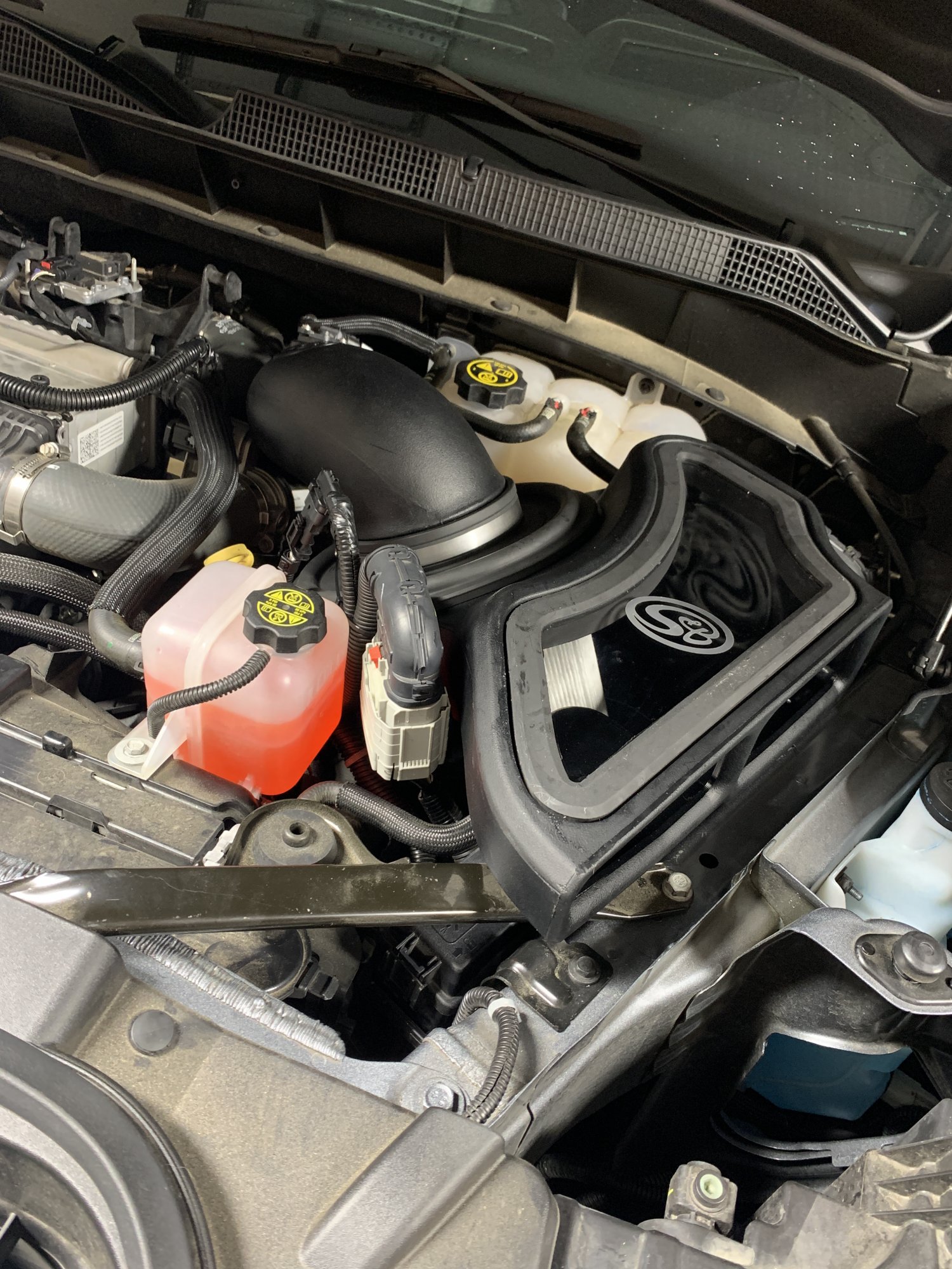

Second was the long awaited S&B intake (I've been messaging S&B since last summer).  All I can say is WOW!  In both performance & sound & in the PIA department for install!  Most ridiculous "bolt on" I think I've ever encountered.  I'm not a technician but very much mechanically minded and capable and it took me about an hour and a half!  But hearing the glorious sound omitted after the install made it all worth it :)
