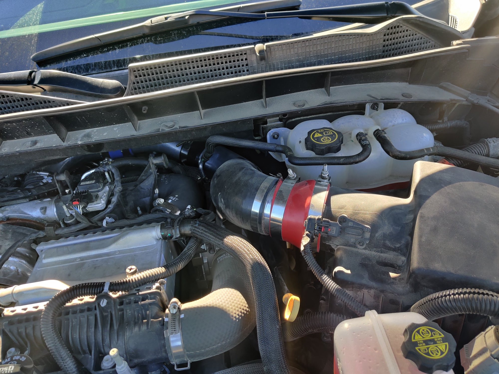

Right now you have to make your own mods. I got tired of waiting and made an intake from the air filter box to turbo and replaced the resonator between the turbo and intercooler. Noticed a nice bump in throttle response and sound. On the exhaust, from a performance aspect, don't bother. I went from stock pipe to 4" right after the cat and it did nothing. Sound wise it changed some for the better but not enough to justify the cost and time. The scr/dpf/cat really quiet things down.

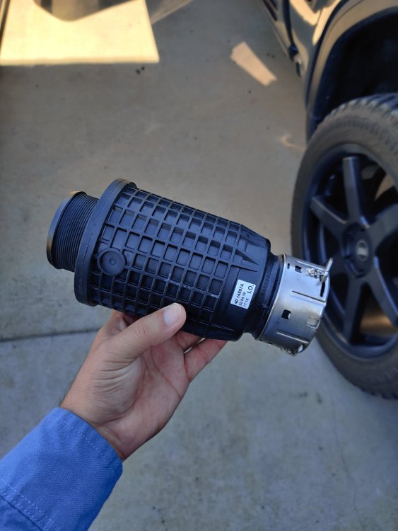

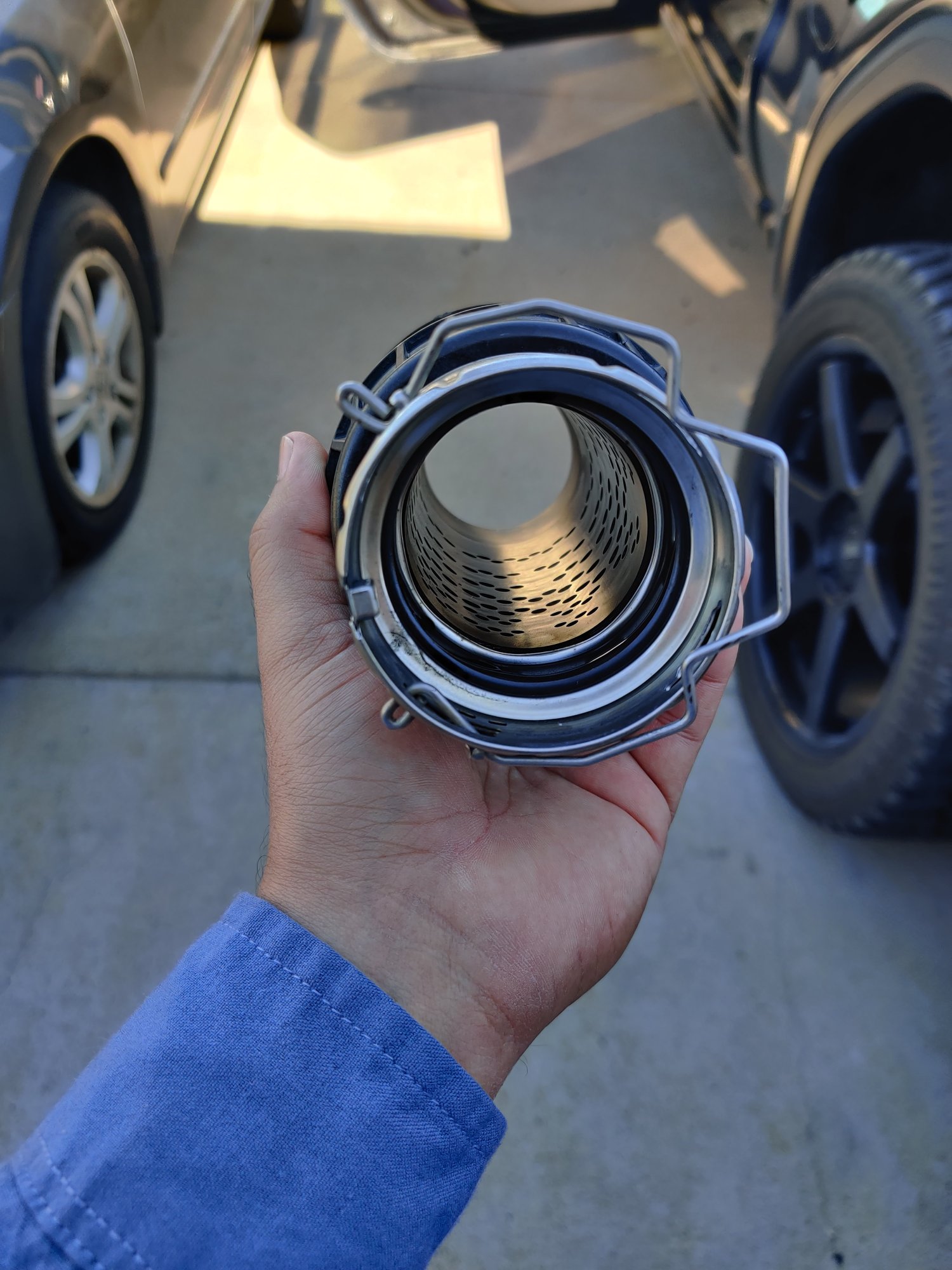

I wish I would have taken pics, when I removed the stock turbo resonator, there was oil residue in it so the turbo is sucking some oil from the crank case/pcv setup and most likely will coat the inside of the intercooler and intake manifild so I'll be installing a catch can soon.

Thanks so much for the advice! I would love to see some pictures of how you made your intake. We’re you able to hear the turbo any more? Excuse me for my lack of knowledge on engines, this is my first diesel. What does replacing the resonator do?
Yes I can hear some spool up of the turbo now under part throttle. The resonator is just to reduce the "whoosh/hiss" sound the turbo makes. I'll get some pictures later today. And I'll also get a pic of the inside of the resonator so you can see what it looks like.

I used left over aluminum piping from previous turbo and procharger builds so it only cost me time to make it all. The only thing I needed was a coupler for the outlet of the turbo. It's a 2.25" and the stock coupler into the intercooler is 2.5", so I used about a 6-7" long 2.5" pipe. Incase anyone wants to do the same. The outlet of the air filter box is 4", and the stock coupler for the  turbo inltet is 3" and reduces down to about 2.75" I think, I didn't measure since my 3" pipe fit in it. So mine is set up  4" to 3.5" at the stock air box, then half was reduces down to 3" I've been thinking about making it all 4" pipe up to the turbo but it gets tight back there.

Thank you for the pictures! Dumb question: is a turbo resonator different from an exhaust resonator? Im assuming that I would take the resonator out for a new intake?
Same principal, and youre welcome. hopefully this helps if others decide to do the same
