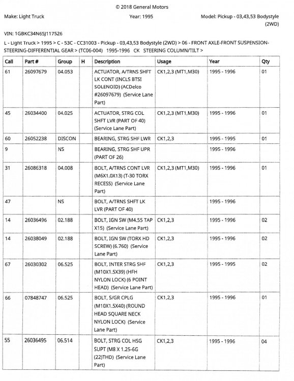

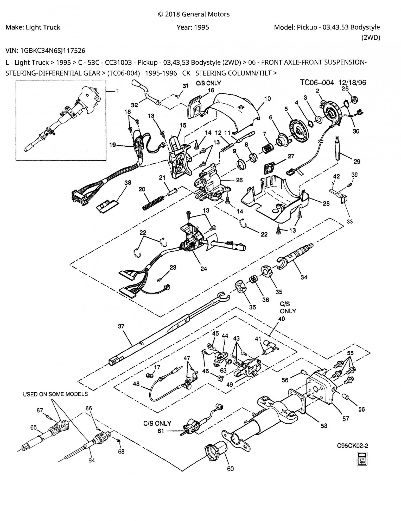

Doe anyone know where I can get #60 in file attached ,Part#26052238 (bearing,strg shf lower) which has been discontinued by gm or someone have an old one still together or a gm print so I can fabricate one. I don't want to pull the one out that is sitting in there on my truck because it then becomes undriveable until I get the new one fabricated which isn't a quick thing.

Second, looking at the part drawing, looks similar to later model years bearing. Wonder if of them could be modified to work. I gather yours is broken into pieces?

Not actually it is all in one piece and still in the bottom of the column. It has a lot of play in it, I pulled it apart once and greased it but to no avail. I have replace all the other components below that which are available, the entire front end including king pins and I am currently in process or replacing the steering box, not available new, only rebuilt so I went with ACDelco rebuild after reading reviews on the others. The only thing that will be left is that bearing, and I might take it out again and maybe turn  sleeve to fit between it and the plastic it rides on or if it is easy enough I can manufacture the entire unit. I just don't want the truck down while I am manufacturing it, may take awhile.
