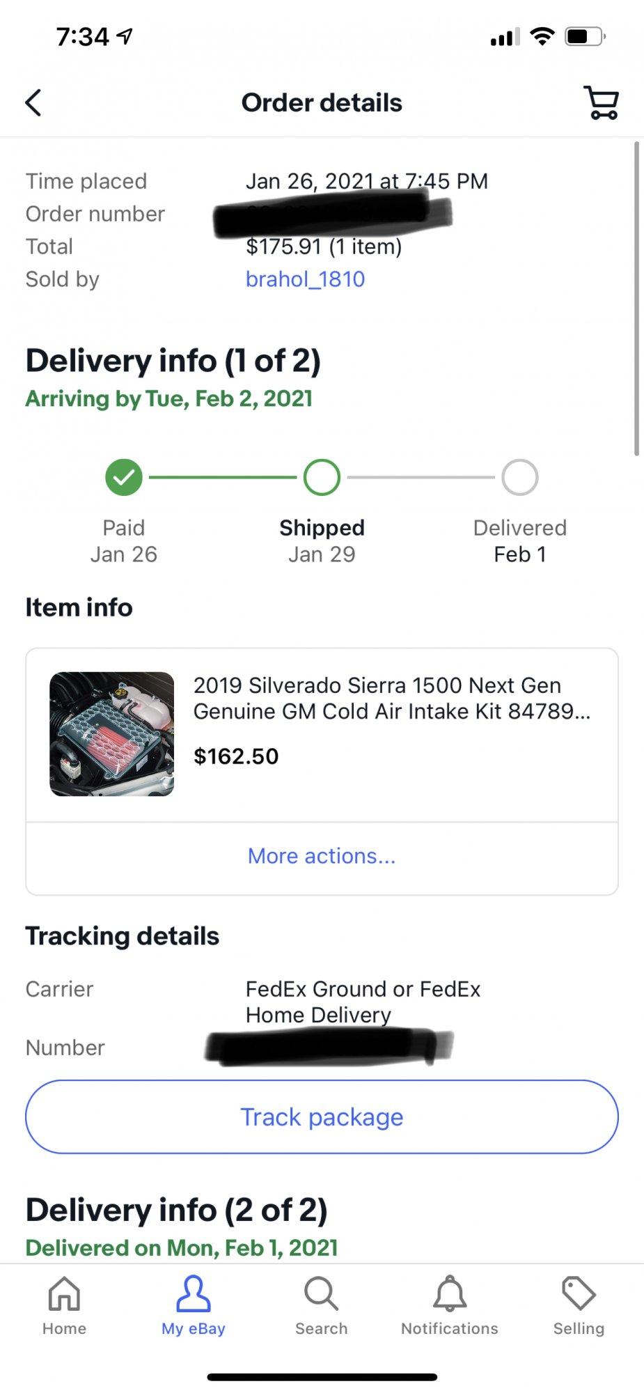

Thanks for the info guys unfortunately I lost the auction on eBay by 12 dollars it finally sold for 162 , that being said still looking on a deal on an intake
Was just scrolling through the forum and just realized I was the one who competed with you? sorry but I needed it as well ?
