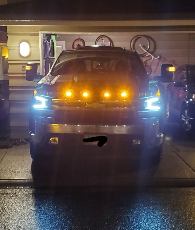

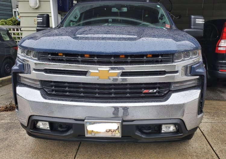

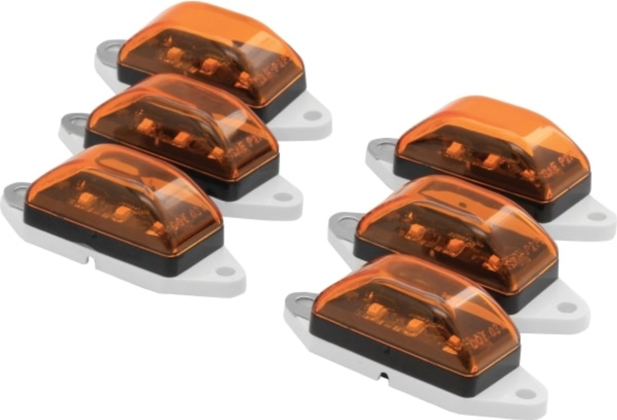

Today I added LED grill lights. Simple and quick. I was able to find some led marker lights, $20 for a set of 6. I removed the back piece and soldered on some new leads. They fit perfectly between the grill openings at the top. Tapped into fuse #40 under the hood for power when ignition is on.
